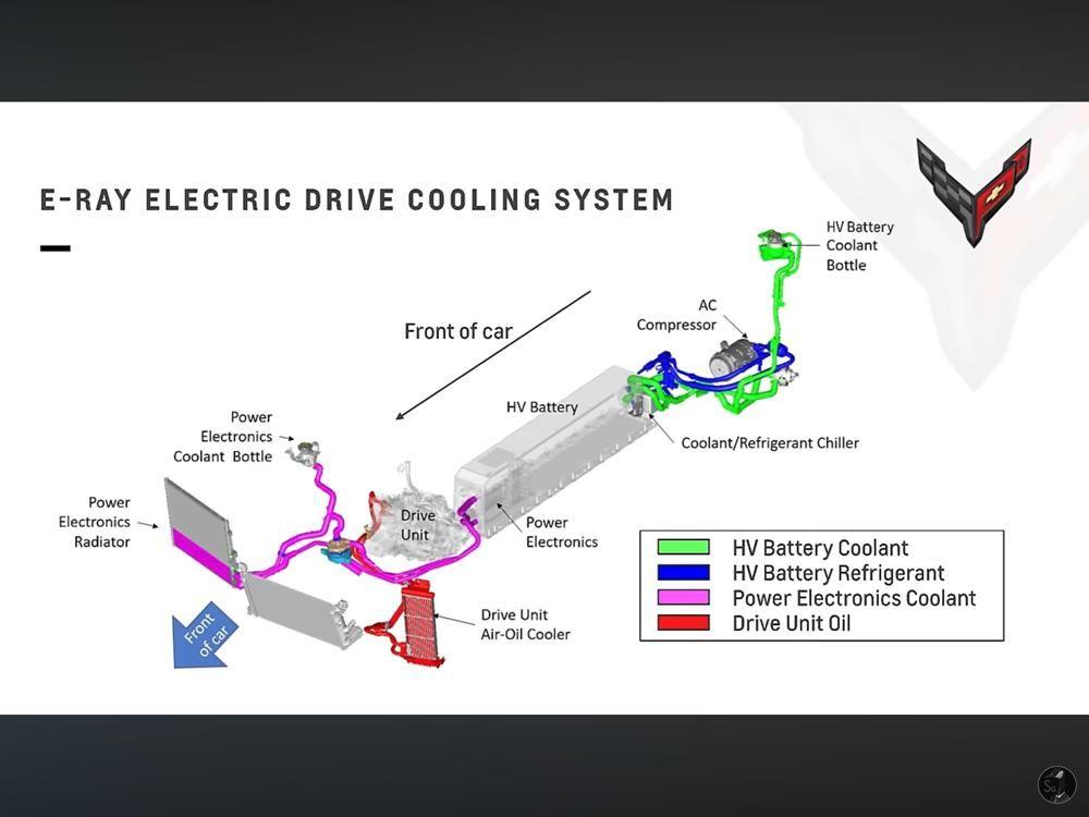

Ya Think?!! Yep it is on the Z06 wide body rear BUT the front isn't wider. But in addition to replacing most of the front-end chassis parts to get the EV motor axles into the front hubs, make room for motor etc there is all that extra cooling. Some lines/systems start in the rear:
No way would this be cost effective to add! Nope, sell your Stingray and buy one, far cheaper. Not cheap just viable and cheaper! Adding the EV Battery, controls in the center tunnel would also be very costly! The electronic integration with the LT2 would require completely new wiring and computer controls!
