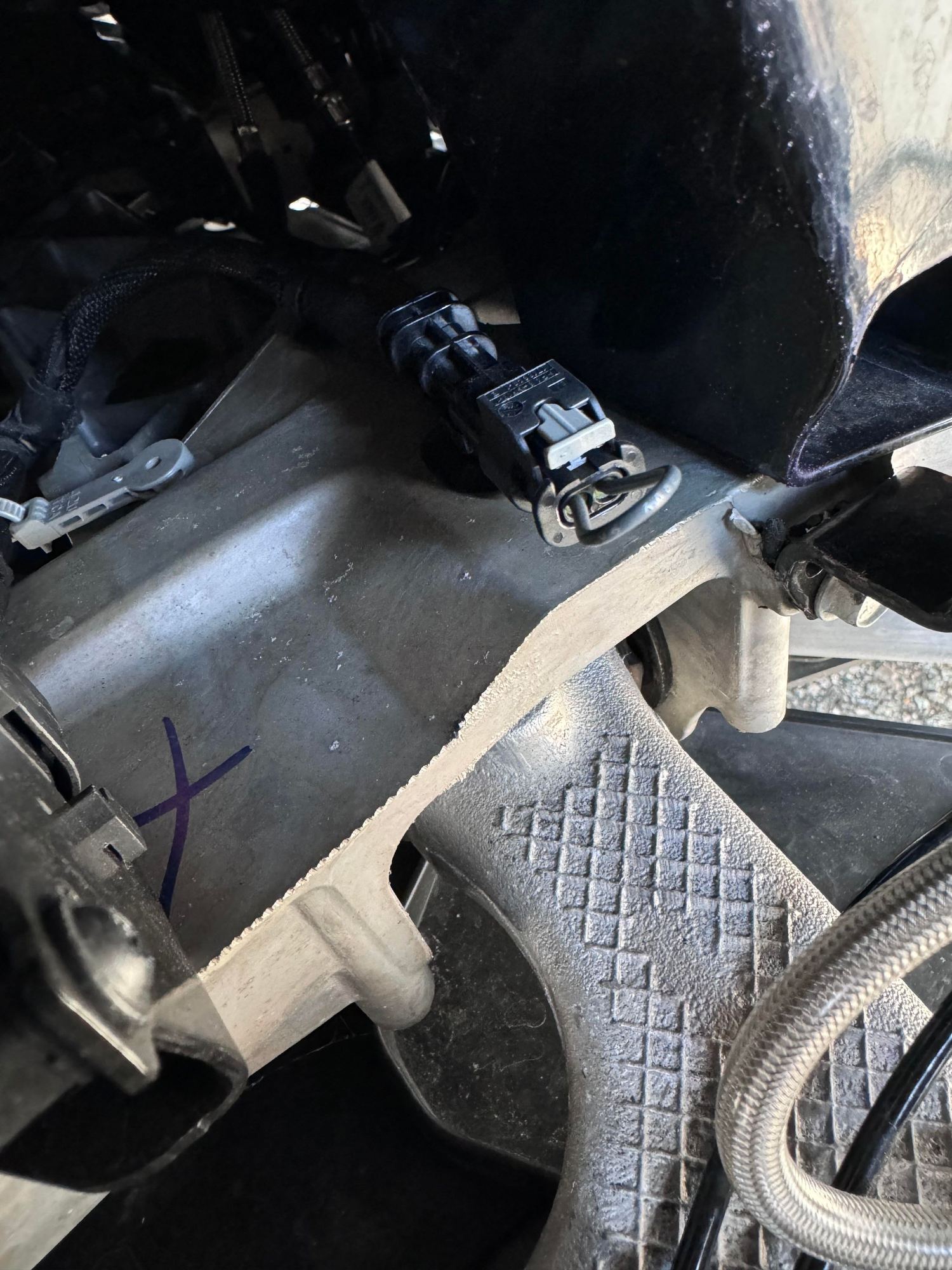

After putting an AP kit on my C8, I was tired of the brake pad sensor warning all the time. I came across a brake pad sensor delete kit from 89x Motorsports, and so far it has worked awesome! It was a simple plug and play kit and the warning light went away. I figured I might share incase any of you were experiencing the same issues.
I found them here: https://89xparts.com/collections/pop...ensor-emulator
Heres a pic of it installed on my car.

You can just cut the wire and put a connector on it as well; that's what I've been doing for my C7 Z07 and C8 Z07 : )

Worked flawlessly for me as well, just cut wires and connect them together. Free solution.
