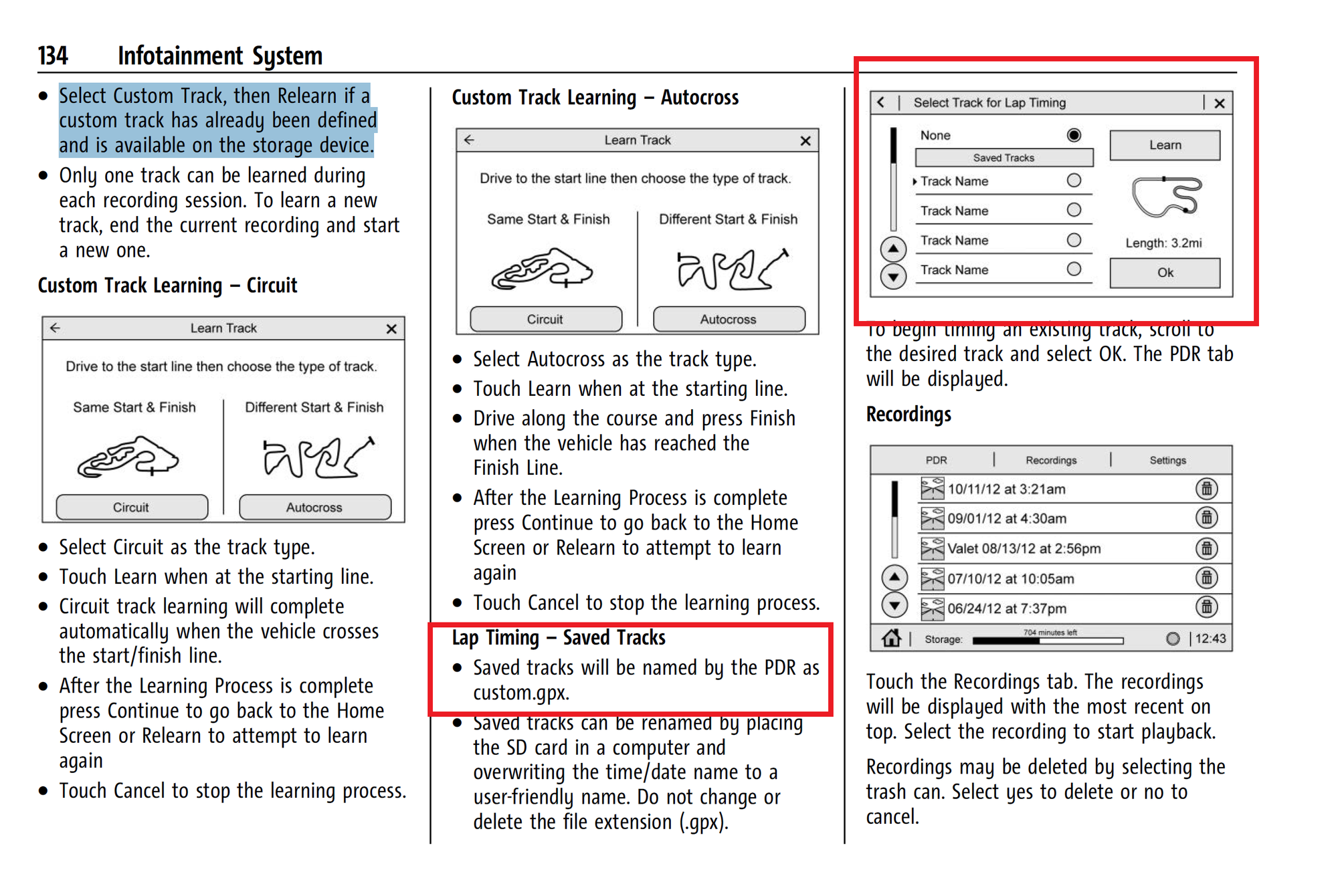

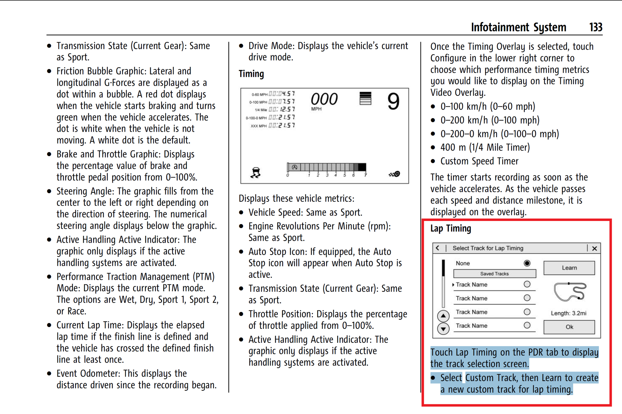

I do not see anything in the Owner's Manual about downloading and storing a track in advance. The manual does describe how to learn a track, by driving it, and then storing it for future use.
The learned track data will be stored on the SD card used for the PDR.

Ok. I have no direct experience saving a track. The reason I thought they might be separate is because the manual shows separate screens for managing the saved tracks and recordings. It looks like to me one can start up the car, with a new recording session, and call up a previously stored custom track by touching "Lap Timing" which brings up a screen that allows the operator to select and "Relearn" a previously stored track. Of course, even if they are in separate files, it does not really address whether or not they would be overwritten when the card is full.

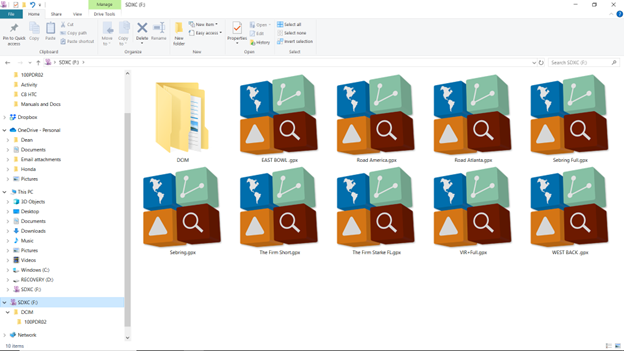

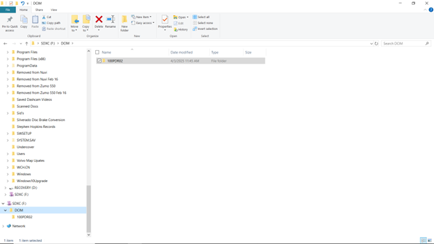

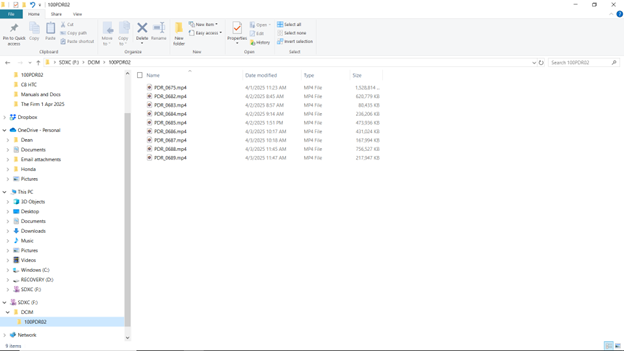

The tracks are saved as .gpx on the root of the card. Meaning, when you place the SD card into your computer, select the card and this is what you will see, depending on what GPS programs you have installed. They are there. If you reformat your card, you will lose these saved tracks. Back them up in a folder on your computer.
The PDR recordings are saved in a folder. On mine it is labeled 100PDR02, and that folder is in a separate folder named DCIM. Here are two screen shots of those, when selected.
You do not need the COSWORTH program to view these recordings. There should be a program on your computer that will play MP4 files.

As for the course learning feature. Once you learn a track, it is saved as custom.gpx and can be renamed when you place the SD card into the computer. Just select and rename.
If anyone has tracks they would like to share, you can get them, place them on the SD card and they will come up when you get to the track and setup the PDR. TIP - turn off PDR recording to select a track.
Anyone want any of the tracks I have, send a PM, I can email them to you.

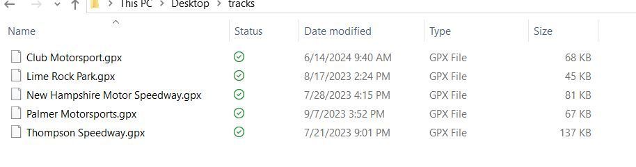

I have tracked my C7 for 10 years and never took the time to learn how it kept track of 'tracks' but when I "learned" a track and the MPX file was not deleted the track was remembered. If I formatted the SD card I would relearn them. That is the short explanation. I got a C8 and had issues learning the tracks on my PDR. I am just starting to get what I think is some idea about the GPX files that are in the root directory.. I have found a few GPX files for tracks and will see next week how the Watkins Glen track map works. My braindead view is that the PDR creates a single "custom.gpx" file in the root directory of the SD card. That file is used every time you learn a track. Unless you put the SD card in a 'PC' and rename the file you will lose the track you just learned when you "learn" a new track. In the learn track screen if you rename the file on the SD card to (in my last track case) palmer.gpx you can select that track the next time you are there. I now see on the learn screen on the PDR the track files I downloaded from the internet and the one that I created for Palmer. I will verify these files work, and post them in this thread if they do work. If anyone has a source for GPX files please post. Also please correct me if my understanding about the files is incorrect.
UPDATE:
I have added zip files of the .GPX files that I have so far. I created the Palmer (Palmer Counter Clock Wise) and Remlap (Palmer Clock Wise aka Palmer backwards). The others I found posted. I was just at Watkins Glen and that GPX worked fine. For the Palmer (Palmer Motorsports) I tried using the Palmer (CCW) going Remlap (CW) and it did not work so that lets me know that they are direction specific. At Watkins Glen I confirmed that when you select a track on the LEARN Screen it will remain selected until you select a different one - to say in another way when you select the track it will remain the selected track for all PDR sessions and there no need to select the track every session. I am sure some folks will think "How stupid is this guy this stuff is obvious to the most casual observer" but I am trying to help the user new to the C8 PDR understand the basics. Please feel free to add any tips. I may start a new thread so the info is the first entry and I am not riding in the middle of somebody else's post. Please let me know if you think that is a worthwhile effort.
