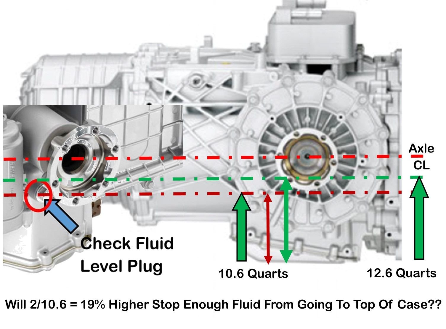

I do not know if a 2 liter overfill - over and beyond an existing 2 liter track fill - will cause damage, and I doubt your dealer know either. How would the dealer know
I can tell you what the Service Manual has to say about it, and its not encouraging. But I will point out - this caution statement appears in the Transmission Fluid Level and Condition Check which is checking the fluid for the normal track fill. But we know that its ok to put 2 more liters in for a track fill (for earlier models). We just don't know how much more before the events in the caution statement come true (if ever): "An over-filled transmission will cause fluid to discharge out the vent tube, possibly causing a fire that may result in serious bodily injury or severe vehicle damage, fluid foaming, or pump cavitation."

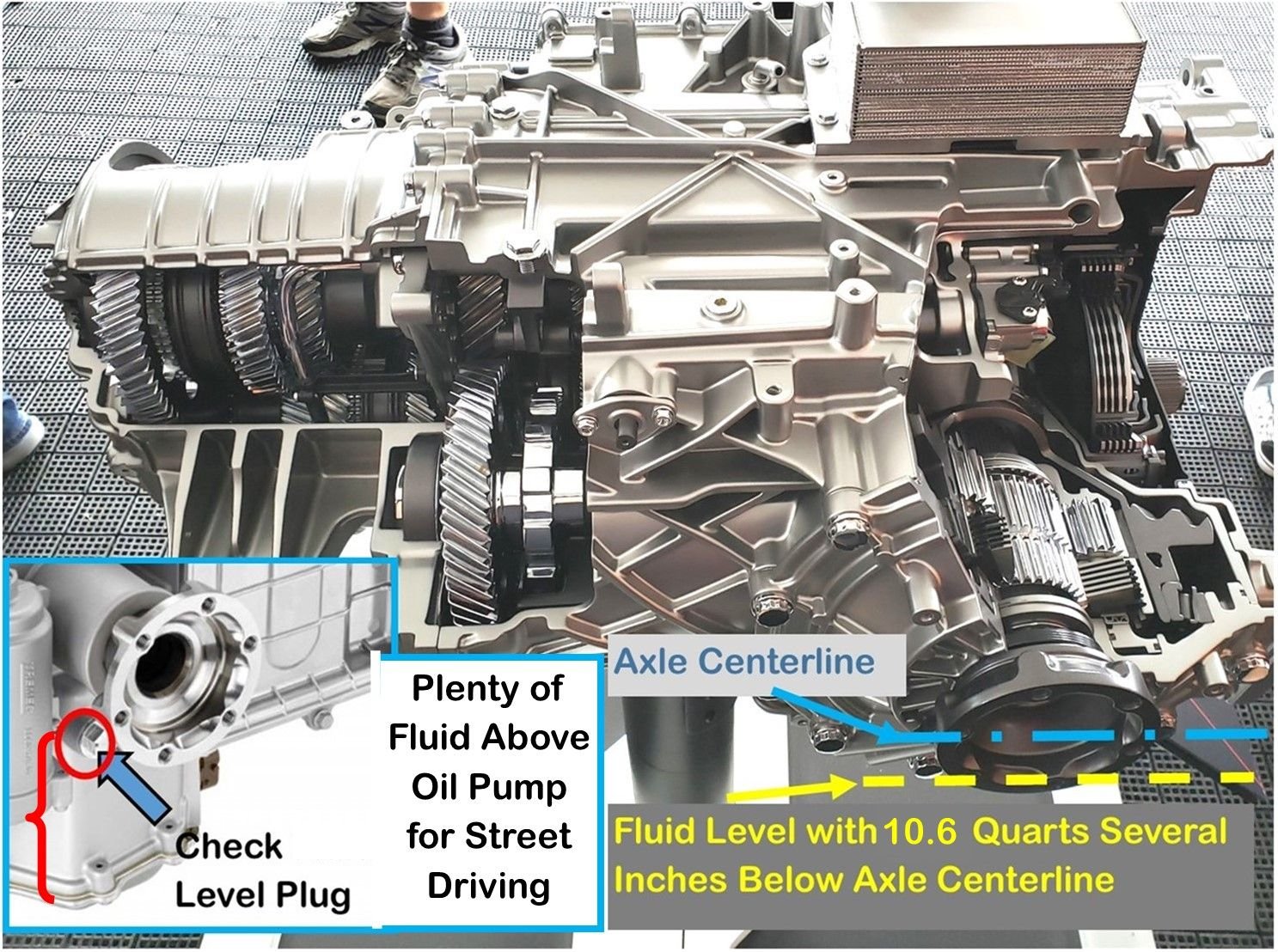

1st just because you had the extra 2 Overfill quarts added initially why do you think they took the trunk and intake air box out and spent ~2 hours accessing the factory fill location to add the two extra quarts? Unlikely and no legitimate dealer would add the fluid any other way (for safety reasons) other than the prescribed GM method!
Fact is there is no way to check other than to remove the check fluid level/normal fill plug and let whatever extra to drain out and start all over!
2nd adding the 2 quarts overfill does increase drag somewhat. Two more quarts just adds more drag. If driven without letting the engine rev more than needed to get there (probably won't exceed 1500 engine rpm) doubt it would do any harm. Look at Pics of what I estimate the DCT fluid is with 2 Overfill quarts. Far from getting near the top of the case even with 4 added.
SIDEBAR
In fact the 2 overfill quarts were probably not really needed BUT GM said must do for Tracking. Harlan Charles, reinforced by Josh Holder, recently said they were overcautious requesting the 2 overfill quarts as MOST Trackers would not ever have had fluid leave the fluid pick-up. Assume he means not aggressive enough to reach high lateral "g' on turns like the Laguna Seca Corkscrew where you are going downhill and turning aggressively (if your a very good driver and using racing slicks!)
