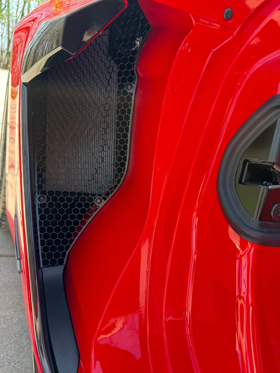

I made mine for $20......quite simple.

I like this better than the "BILFARRO" side guards that I just received from Amazon (they do not fit well, in my opinion). Where did you source the materials for your homemade guards? I will make some myself based on your good idea.

Lot of air restriction on those. I paid the idiotic corvette tax (with GM Mastercard reward points) for the scrape armor front and side Eray grills. Both front and side kits have GM part#'s and were tested to not impede airflow into the front radiators or create turbulence in the side air intakes. They also look similar to the OEM mesh screens on my Ferrari and McLaren.
When I bought the McLaren last year, both carbon fiber side scoops had some dings, and the black paint on the front and side screens was flaking off. I ordered a complete set of new L/R oem carbon fiber side scoops, screens, + front screens....total cost....$1,200.....and it took McLaren 5 months to deliver them because they are HAND MADE in England. Compare that to the $1,400 I paid for two sets of screens that should be included as stock equipment.

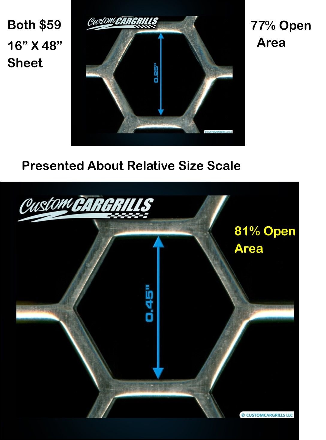

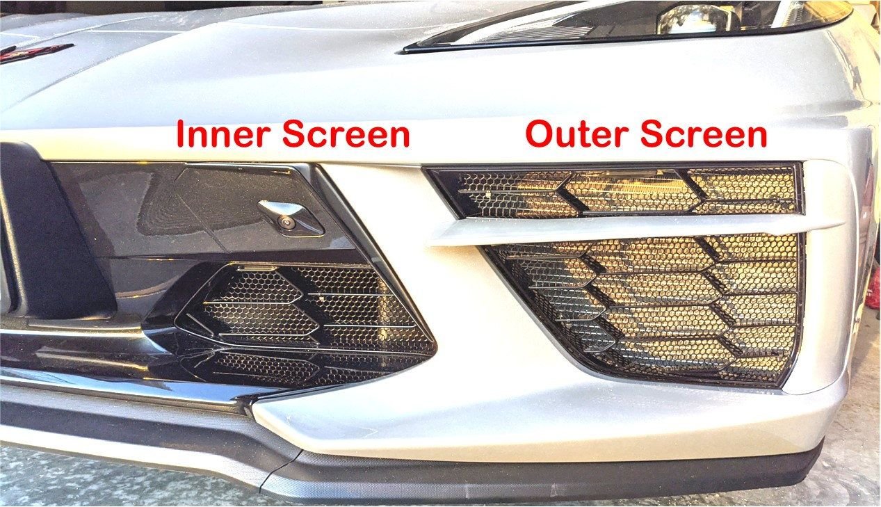

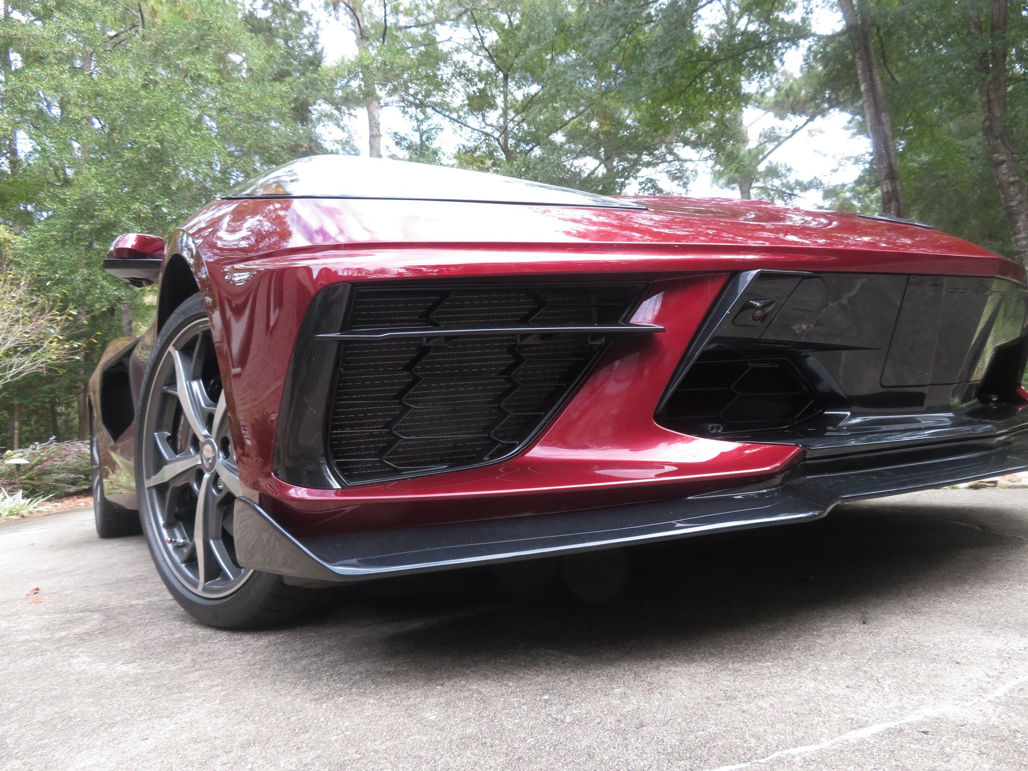

Hmm, no more need in the C8 than my C6! Folks have been making for years, CCG has been in business for probably 20 years and makes them for Cars, Trucks. You can buy precut for all 4 front opening IF you want 100% protection. BUT is you just want what you get with the GM approved Scrape Armor (less than 100% protection) coving two openings can buy those Precut as well. If you are a decent DIYer can go what many of us did and but their aluminum powder coated mesh that is thin width and deep to make ridged. They sell two openings, one most of us used that is 1/4 inch hex mesh or their twice as large similar to Scrape Armor if you Track on a hot Texas summer! I have zero coolant temp increase in aggressive street driving no tracking on 95+ NE SC summer days.
This is a Doc PDF with details of mine and member Blaun install. He bought the same 16" X 48" mesh I did and shows how he made 4 for the front and two for the side fender scoops:
http://netwelding.com/CF_Splitter.pdf
They also sell precut for 2 or 4. US Company, Made in US not cheap Chinese copies.

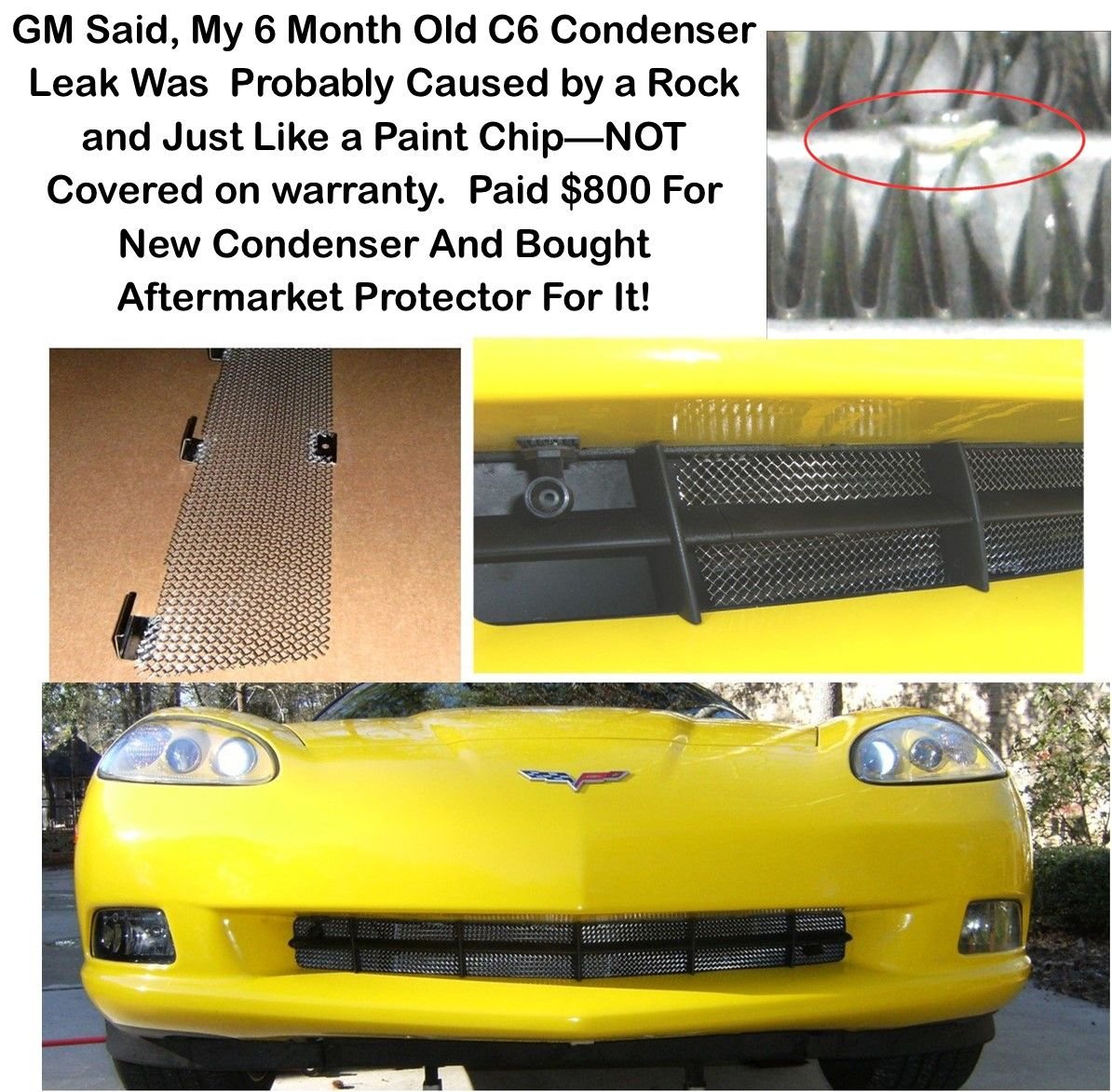

Here are a few Pics of the ~50 in the Doc. Don't panic it's Pics with long captions. Look at Pics and only read what you need. IMO my C6 with bottom feeder rad was worse that C8. Trucks and some cars worse than C8.
CCG sells two mesh sizes. Most of us used the 1/4 hex mesh that lets thru half the size bugs of Scrape Armor!

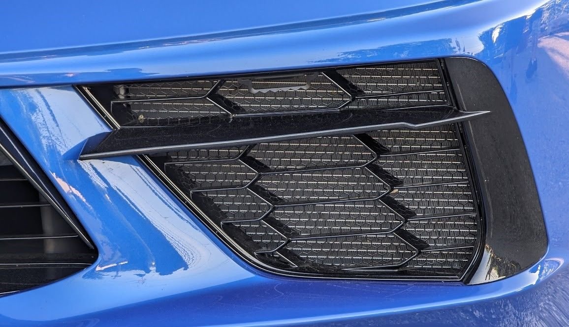

I like some other installed without any wire ties showing. Requires removing the grill bar but that is only 3 bolts to remove same bolts as Scrape Armor requires be removed. Then hide ties behind grill bar. BTW all cut edges are behind the OEM grill NOT Visible.

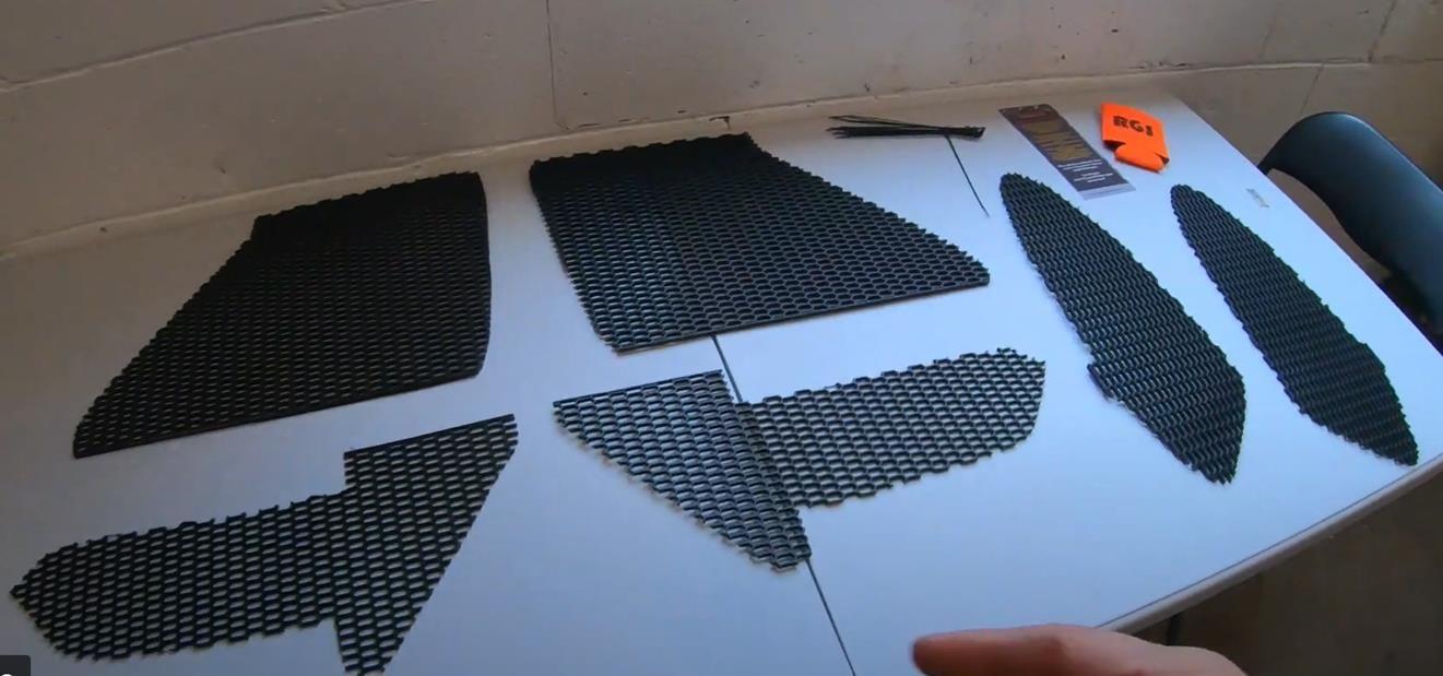

Member Bluan use his 16" X 48" mesh to make 4 screen for the front (two more than Scrape Armor) and two for the rear fenders.
Has links to patterns.

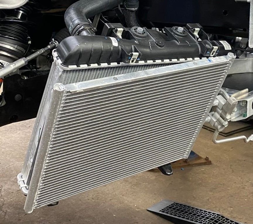

Both side coolant Rads are covered by an AC Condenser. C8 Z06 and E-Ray add center coolant rad with no AC Condenser covering!
Both 1 & 2 are AC Condensers. Number 5 is the AC Compressor on engine.

Of course. Its correct that the AC condenser sits in front of the radiators in the front inlets in the Stingray, and its been pointed out over an over in discussion about the front inlet grille screens. In the Chevrolet Build and Buy tool, the option is called."Front radiator grille screens". And on the Scrape Armor site they are also called Radiator Guards. So, its no wonder folks refer to them that way sometimes. I see folks "correct" other forum member's use of that "misnomer" so often, I thought I would just point out that technically an AC condenser is form of radiator, so its really not that much of a misnomer. Of course in automotive vernacular radiator usually refers to the the one for the engine coolant, and the condenser is for cooling refrigerant, but in broader technical terms, its a device used to transfer thermal energy from one media to another. I regret doing that now - it has caused nothing but aggravation. I did not mean it to be confrontational, but apparently it was taken that way. For the record, the AC condenser sits in front of the radiators in the front inlets.
