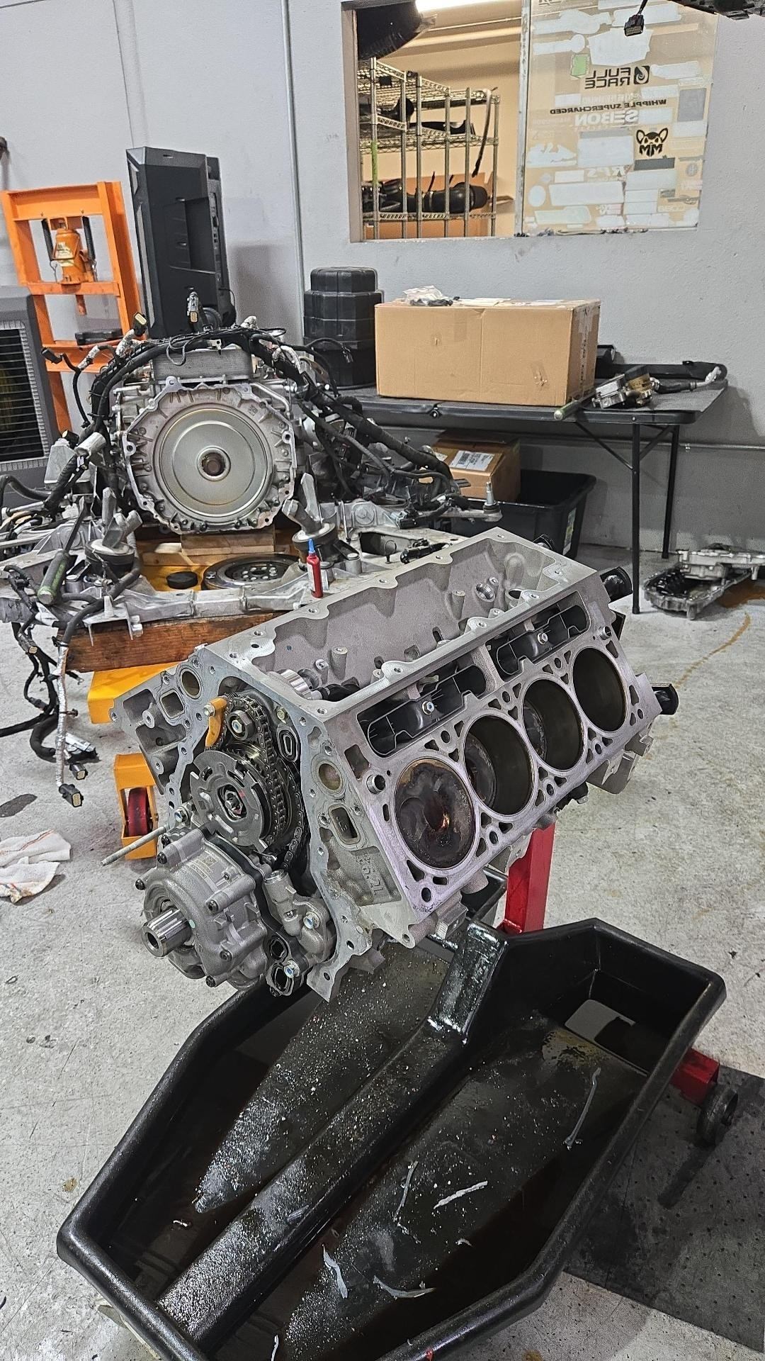

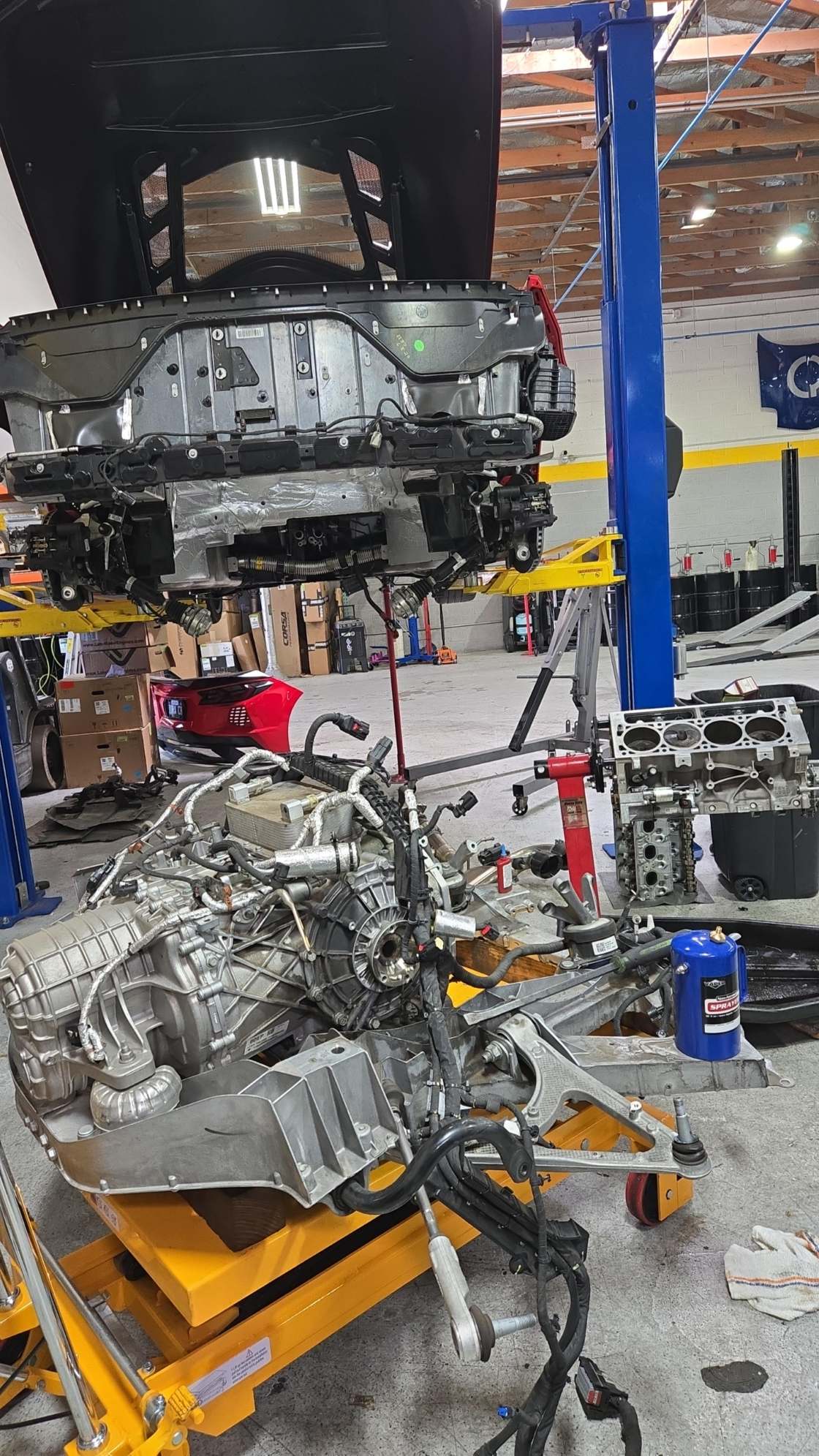

Detailed great build by Cordes Performance Racing.
Tapped out N/A. E85, LTX Cam, LME Heads, stock bottom end. Going to add two installation pics, just need to get proper files set up.

If anyone would like to see pics during the cam and head install just added to post #17.
