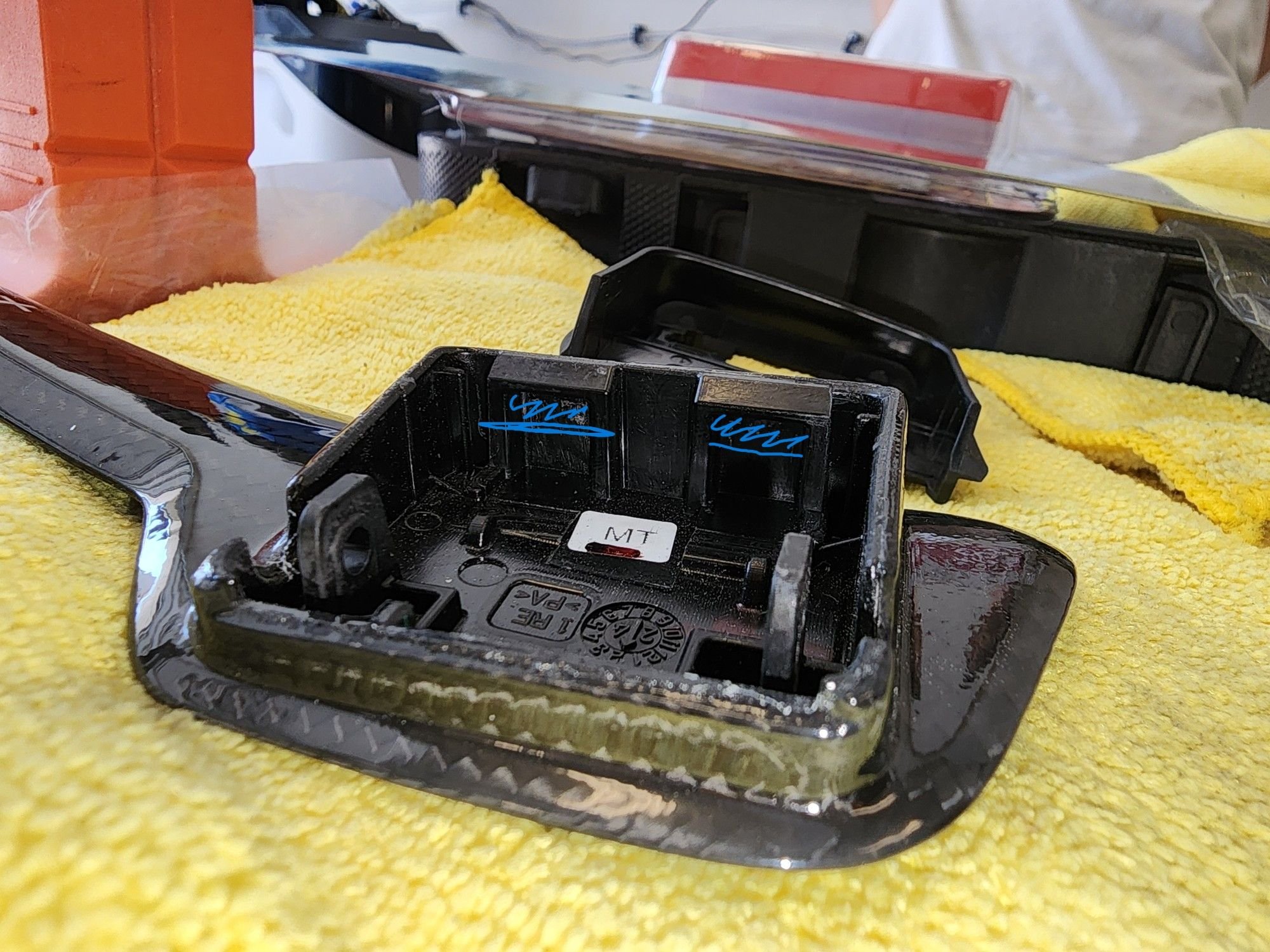

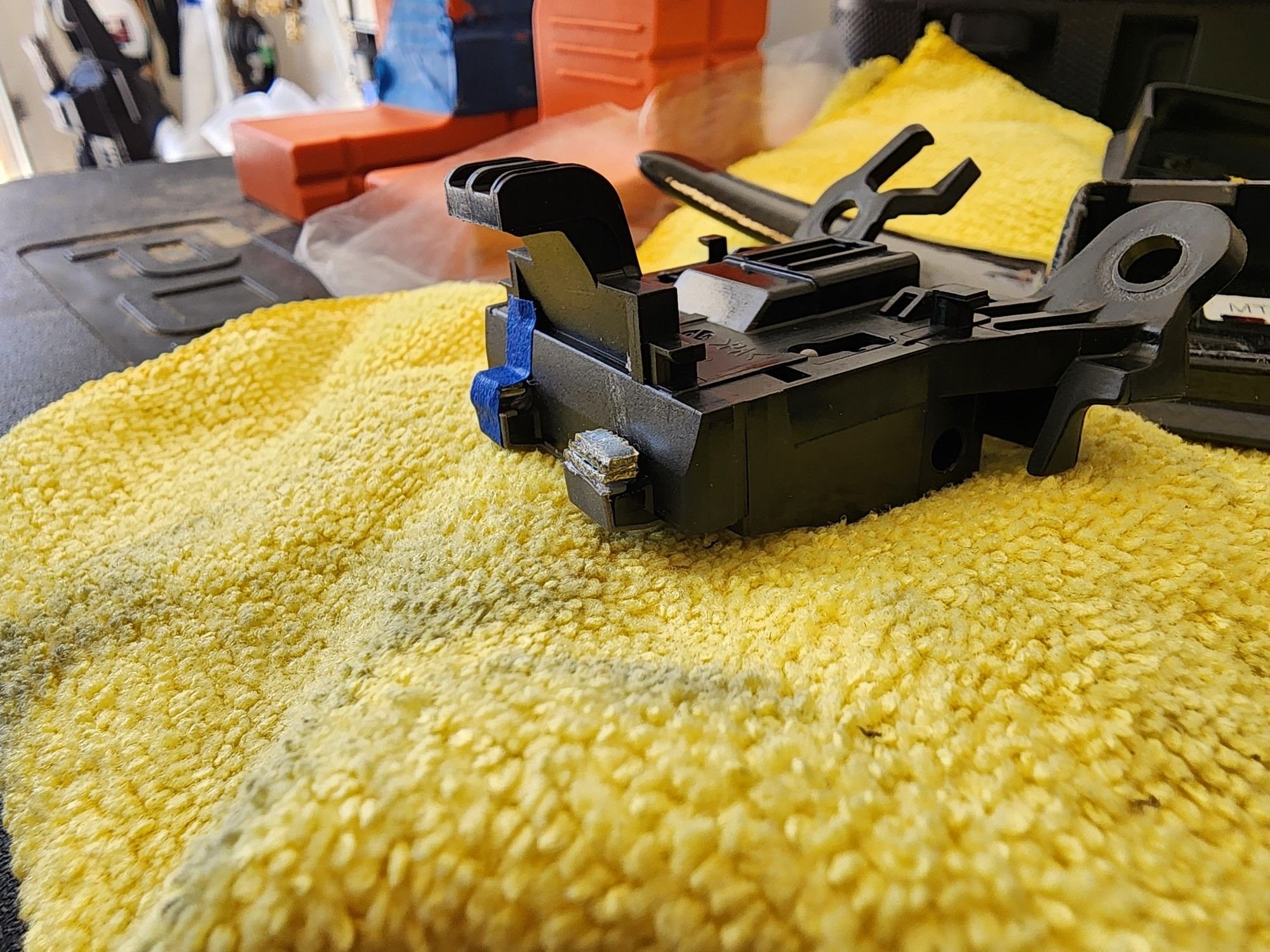

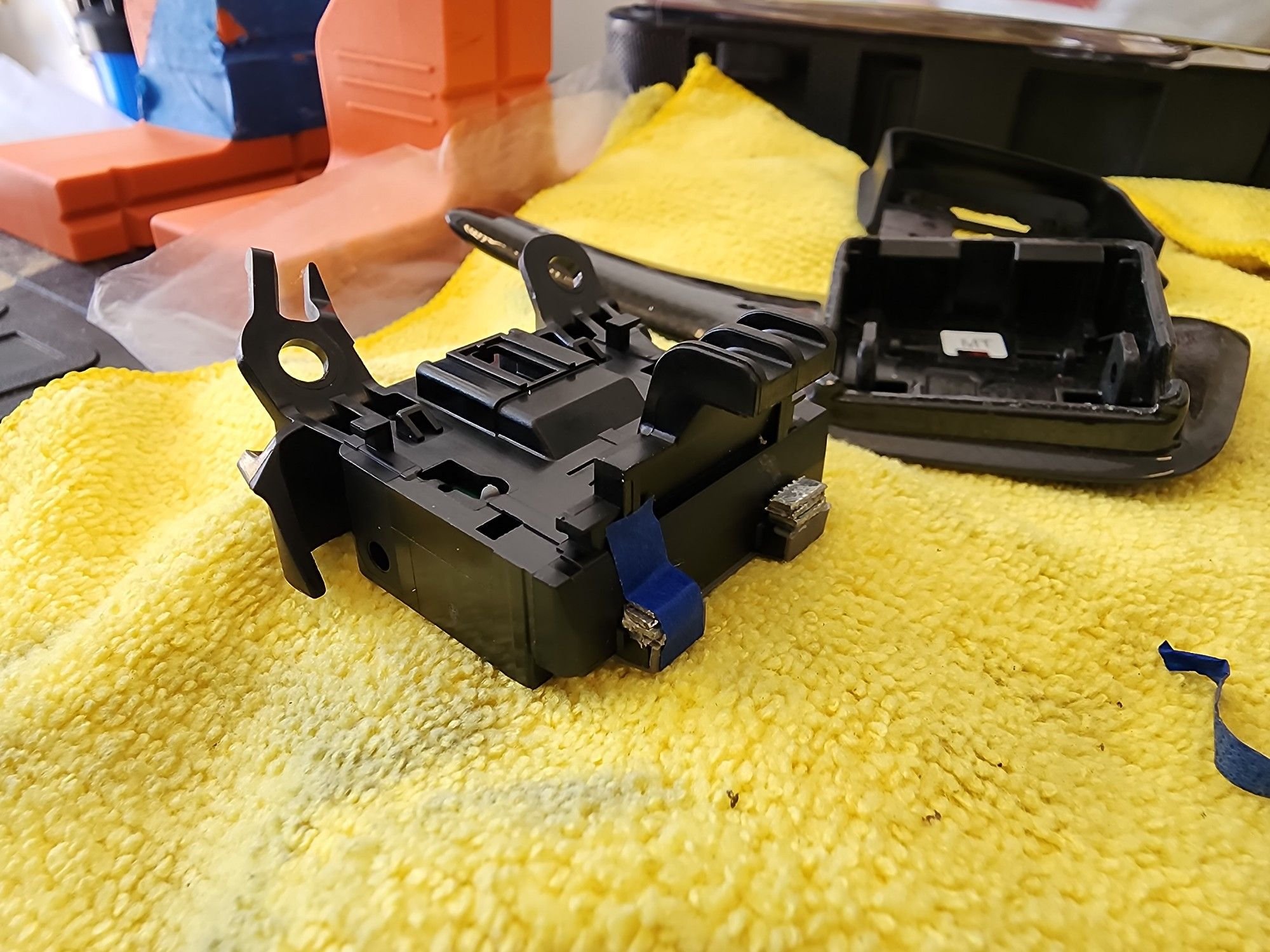

I experimented with this recently and trying to find out if someone wants to 3D print and modify the stock paddles. I jerry-rigged the stock paddles by placing metal spacers taped on as temporary spacers just to test how it feels.
Surprisingly, it works! Definitely not pretty, but I needed something quick to test and reversible. It basically cuts the paddle throw in half and since I put metal spacers, it makes a metallic "clack" when you release the paddles and let it go back to resting position.
Here's some pictures:
Spacers added and then taped on to hold temporarily.
If someone could 3d print a spacer that clips into this space, or simply design paddles that have that space filled out.
