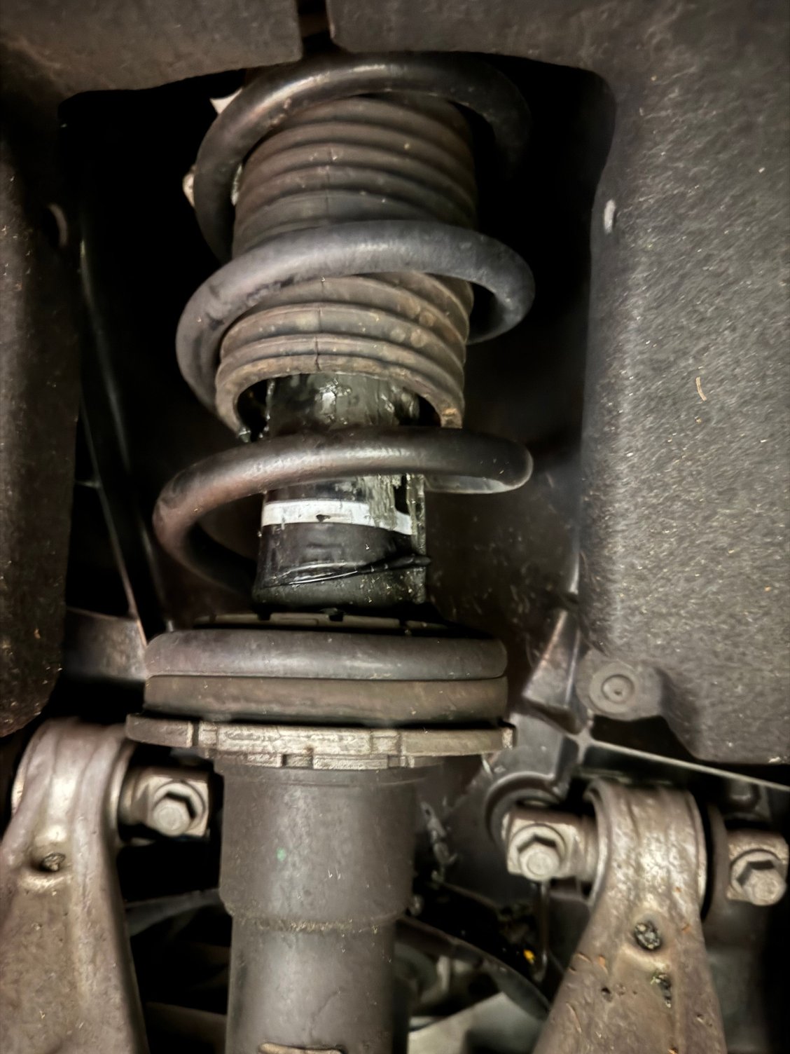

Hello, removed wheel and found some type of grey lubricant surrounding the shocks. Is this what a leaky shock is suppose to look like?

The bad shocks I've seen are wet looking but I haven't seen MSRC shocks that have leaked. I suspect that "grey lubricant" may be what the MSRC magnerotical fluid looks like after the carrier has dried up and the ferrimagnetic particles are left behind. I'd start by removing that shock and doing further inspection. Rockauto is probably the best place to get replacement shocks if you are going to do the job yourself.

That shock looks bad, it should be clean and dry, no grease or any muck should be under the dust cover. As RKCRLR mentions, Rock Auto is typically a good discount OEM supplier, but shop around and do some searching, you will find the price of new OEM parts vary greatly between vendors.
Yes, that's exactly what a leaking magride shock looks like. Grey paste that gets more gritty as it dries out.

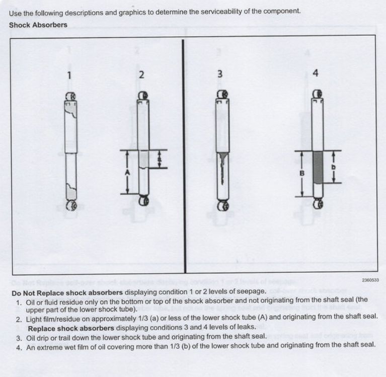

Definitely a bad shock. FYI, just an oily residue (which may collect dirt/dust) on an MR shock does not mean it's bad. What you have pictured is a perfect example of a bad MR shock. Here's the GM bulletin from the C6:

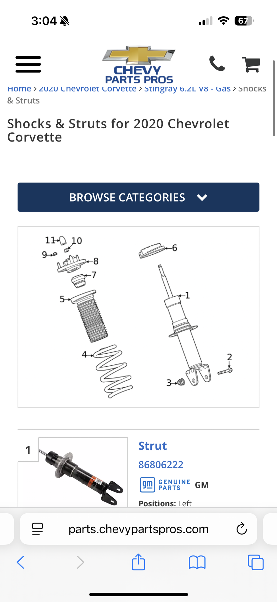

Originally Posted by dstewart51
Thanks for the part numbers.
which part is that?
Disclaimer: this diagram is for FE1, not FE4, which is what I need.

Inspect parts 5 and 6 and see how they look. Sometimes the springs wear though the the cushion material between the spring the the shock. I don't know what material the spring seats on the C8 are.
