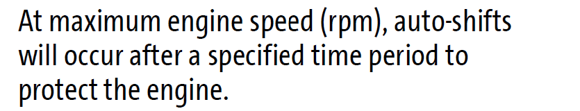

Its in the manual too. And, also, in Manual shift mode, it will also downshift as necessary as you slow. Note that even in manual mode, if you hold it against the rev limiter long enough it will eventually upshift. No one should be doing that, of course. And although as pointed out the rev limiter is supposed to protect the engine, the wording in the manual about eventually up shifting to "protect the engine" seems to suggest that it might be harmful if that condition was prolonged.
