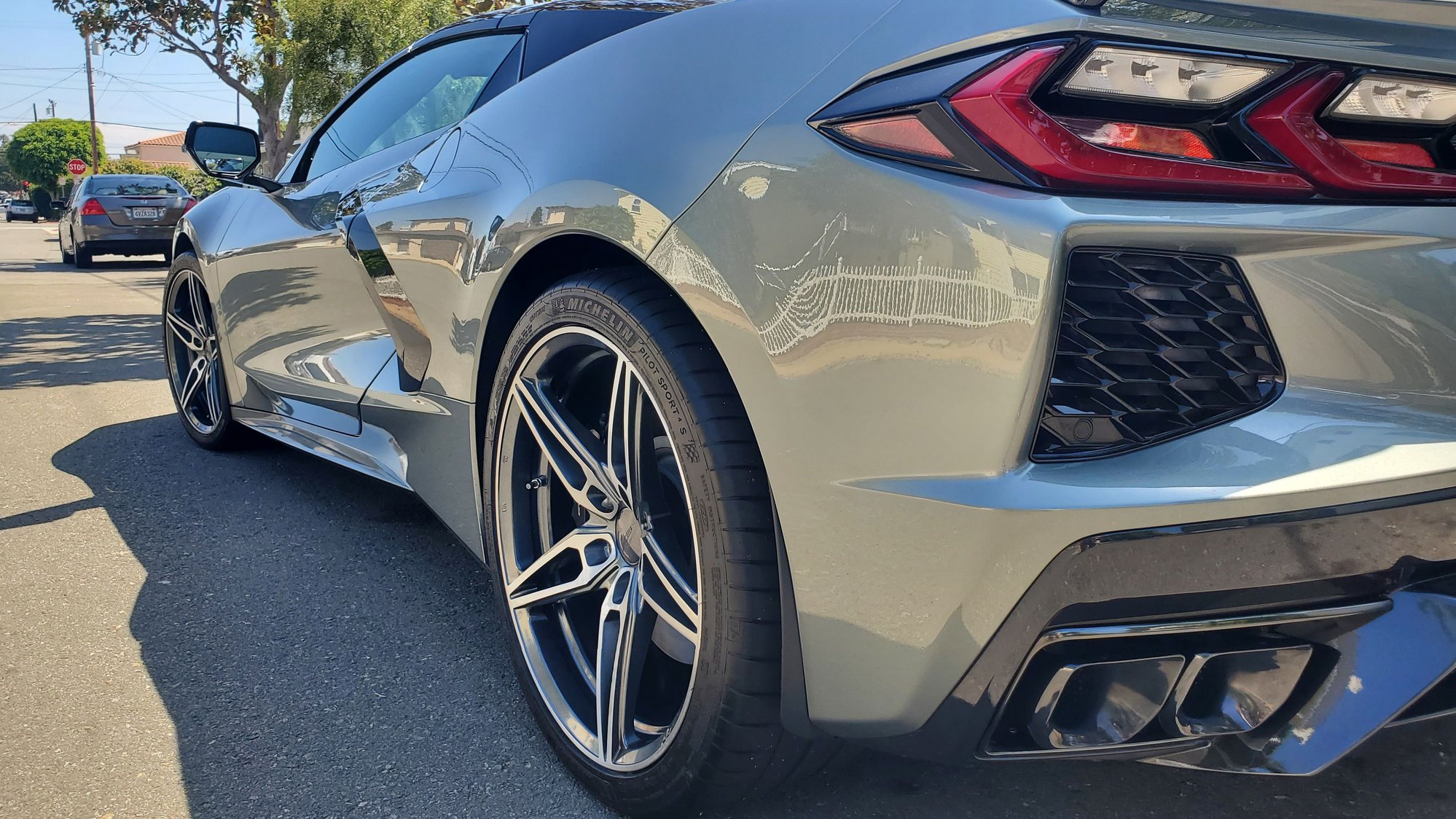

We're both in California so we know what a pain and stress it can be getting a modified car to pass a smog test.. The visual is not a problem, especially with an HTC, but the actual OBD test is a concern. I don't think there are any sport cats that are California Air Resources Board(CARB) certified. Also, getting a CEL can be a major pain in the but.
Can you tell me more about "No CEL if installed correctly" ? Also, do you know any shops that can do a Corsa sport cat install. Any shop except American Heritage Performance, that is.
Bottom line, I would do the Corsa sport cats in a heartbeat if they pass smog and no CEL.
p.s. I think the stock black tips look the best! They fit seamlessly.
