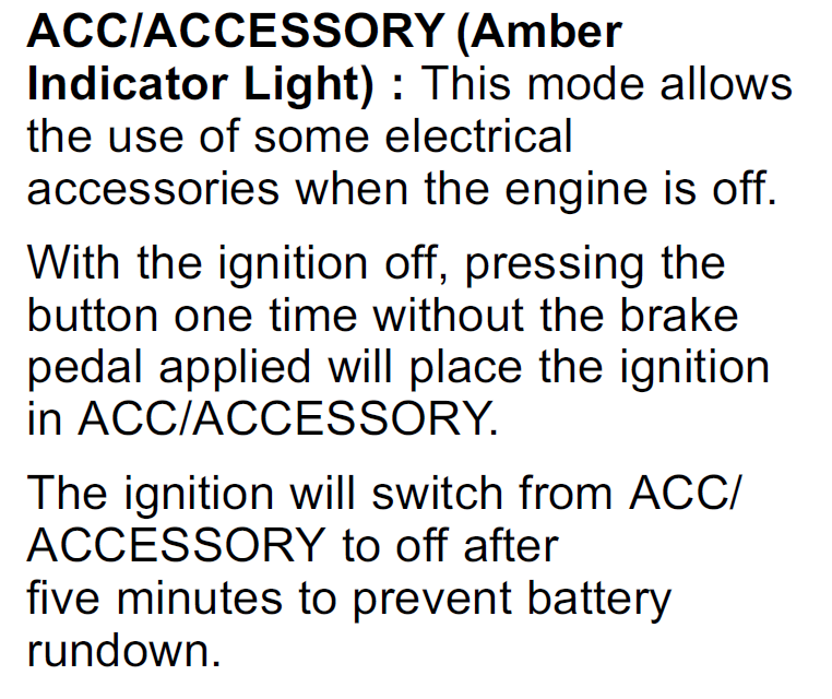

It will go into Accessory mode with a short push of the Start/Stop button. You have to hold it longer for Service moe.

That's right! Service Mode and Accessory Mode are two different things. Post 2 is the procedure from the manual for Service Mode. Here are the instructions for the Accessory Mode. That is also in the manual.
