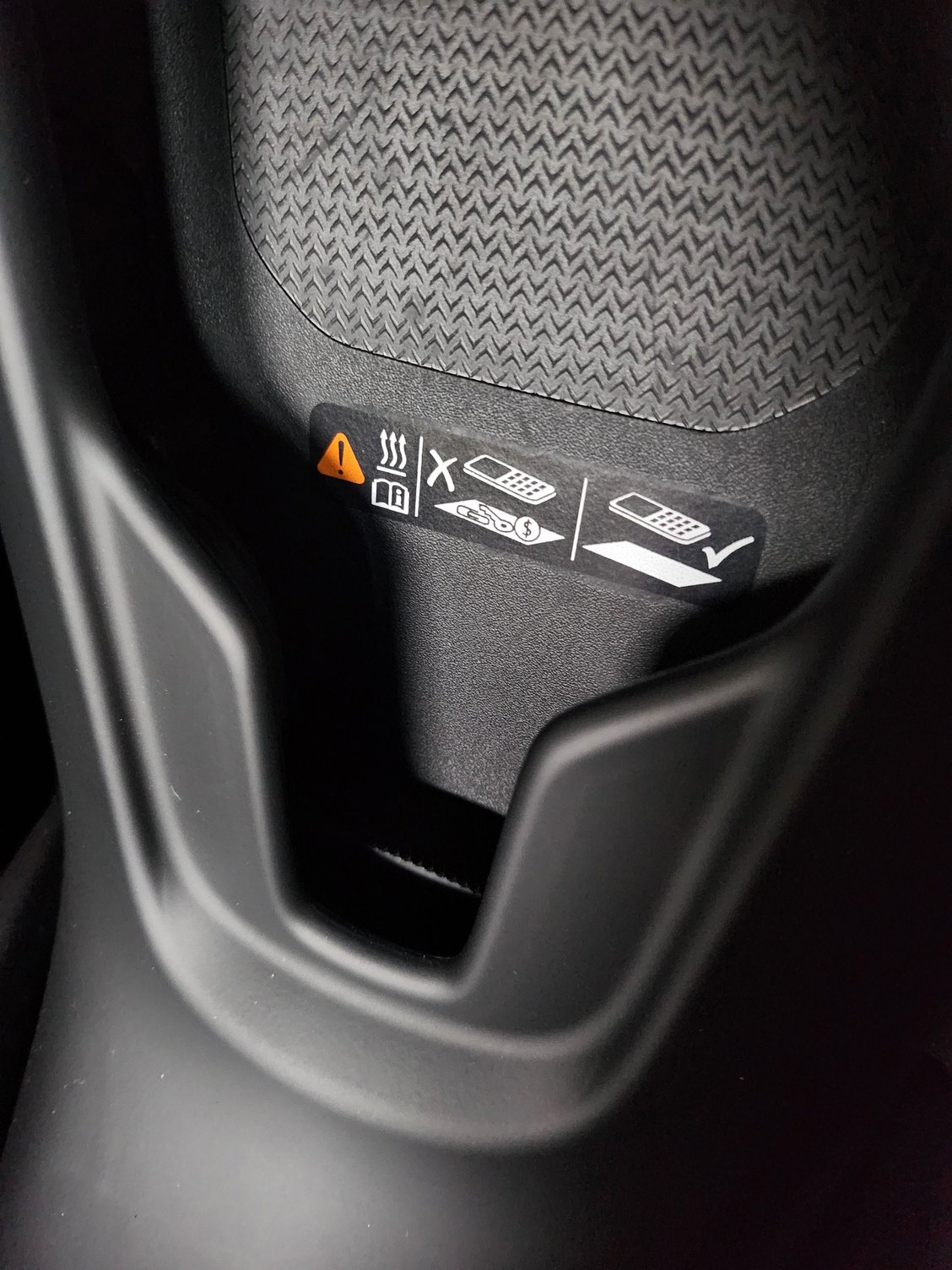

My Samsung Flip phone wouldn't charge for more than a minute or two in the wireless charger in the car before showing that it wasn't charging. I started wondering if the charging pad in the car wasn't lining up with the one on the phone. I placed a 3/8" thick piece of rubber in the bottom of the charger to raise the phone up a little bit. That solved my problem. The phone now charges continuously while in the charger. I just thought I would pass that along in case someone else was experiencing the same issue.

RPOZ4Z is right. I placed the rubber at the bottom of the charger to raise the phone up. I used rubber because it's non-conductive. The piece I added is the horizontal reflection in the photo.
