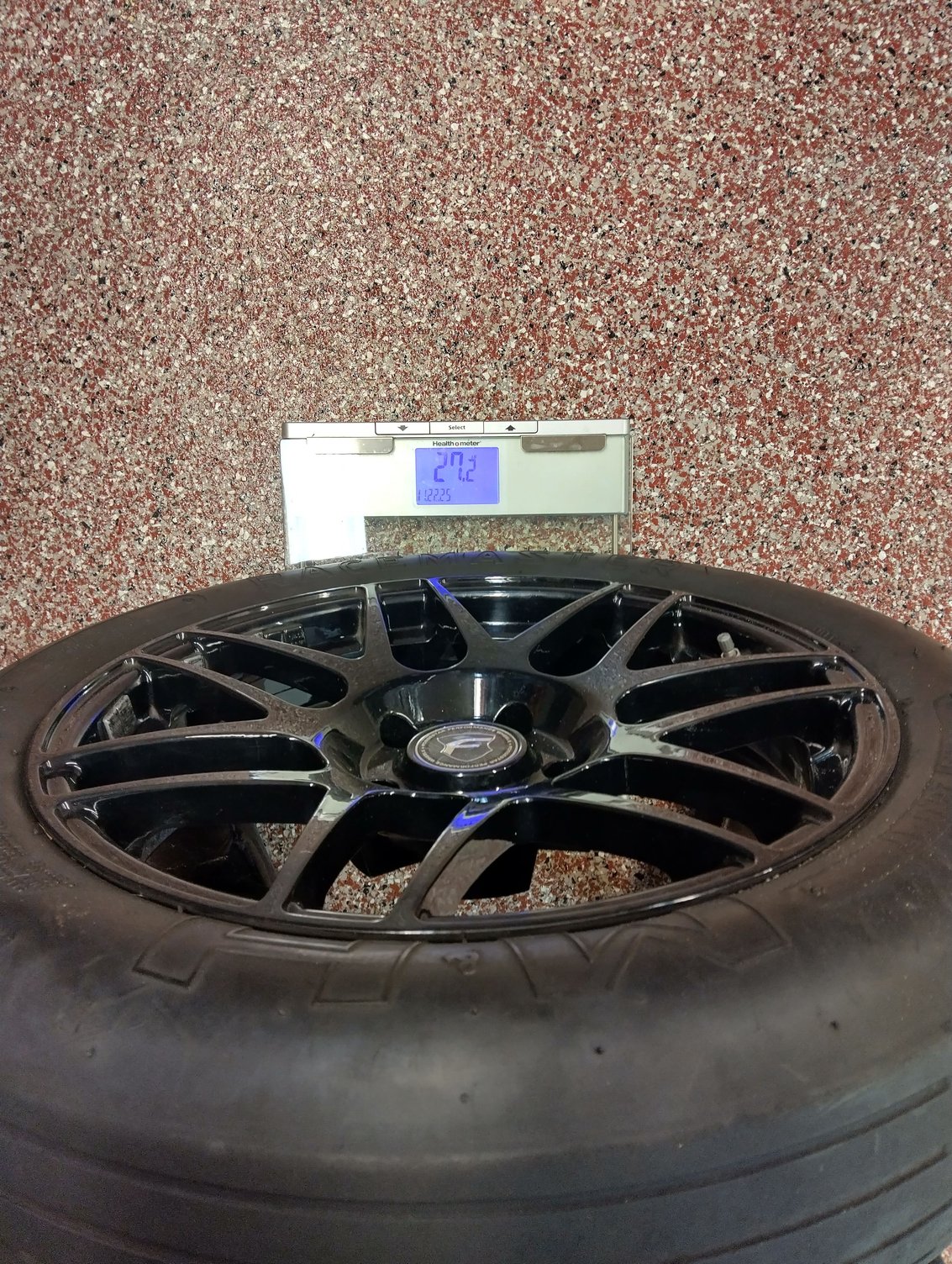

The C8/Camaro/Caddy V all share the the 5x120 bolt pattern and are interchangeable. If you have a non Z51 C8 you can run 17" fronts, the Z has bigger brakes and needs an 18" wheel iirc. I don't have any input on the Hoosier but the M&H 26x4.5 tire is light and the Mickeys are way heavier. My stock front weighs 53 lbs.

thanks! That is awesome info. I can see how the et would improve with that weight savings! Can you share the rim brand/size for front and rear? Do you know what the rear setup weighs?
