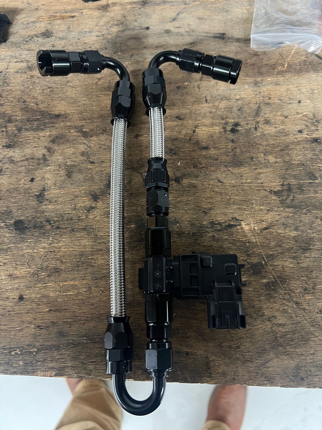

  #44
c5racr1's Avatar
c5racr1
Joined: Feb 2000
Posts: 3,427
Likes: 568
From: new orleans
did you put the sensor up top or under the car by the fuel tank?
Old Dec 16, 2025 | 09:08 AM
  #45
mittens's Avatar
mittens
Joined: Nov 2005
Posts: 4,381
Likes: 939
From: Huntsville Alabama
Normally the sensor is right before the Fuel rail on Flex set ups.

  #46
breecher_7's Avatar
breecher_7
Joined: Feb 2009
Posts: 5,169
Likes: 199
From: Your Sister's Bedroom
You could put it up top but it would look really bad, the way the feed line connects to the rails makes it difficult to do a clean install. Its far easier to to do under the car. There is a 6" jumper hose that can be removed from two quick connects to insert a fuel loop with the sensor into. It only requires you to removed one of the underbody closeout panels. Everything is out of site.
Old Dec 16, 2025 | 11:53 AM
  #47
mittens's Avatar
mittens
Joined: Nov 2005
Posts: 4,381
Likes: 939
NICE, I always hated the weird location on top in my last C7 ha
Old Dec 17, 2025 | 10:01 AM
  #48
c5racr1's Avatar
c5racr1
Joined: Feb 2000
Posts: 3,427
Likes: 568
From: new orleans
why I asked...
Old Dec 17, 2025 | 10:31 AM
  #49
breecher_7's Avatar
breecher_7
Joined: Feb 2009
Posts: 5,169
Likes: 199
why I asked...
Old Dec 17, 2025 | 11:07 AM
  #50
mittens's Avatar
mittens
Joined: Nov 2005
Posts: 4,381
Likes: 939
Looks like a nice job/plumbing. Should sell them.... since DSX will not... .then Tuners can turn on in HP tuners..... since they dont want to sell there product with out a locked tune. Be the guy.
Old Dec 17, 2025 | 12:33 PM
  #51
breecher_7's Avatar
breecher_7
Joined: Feb 2009
Posts: 5,169
Likes: 199
Originally Posted by mittens
Looks like a nice job/plumbing. Should sell them.... since DSX will not... .then Tuners can turn on in HP tuners..... since they don't want to sell their product without a locked tune. Be the guy.
I'm willing to make fuel loops and harnesses for people, but they would still need to go to Justin White for the calibration modification. I do not know of anyone else that is offering it besides him and DSX through their Dealers.
