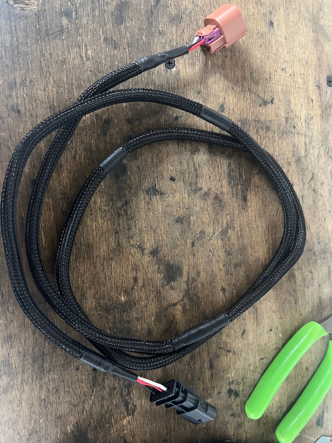

So a few months ago I went down the rabbit hole looking at Flex Fuel options to tune my car. I knew DSX had figured it out so I reached out to Dave with some questions based on information Inhad received from others in the industry. What I ended up discovering is that although he has a great kit and solution for flex tuning, it would require me to have it installed at a DSX authorized installer. I did not like this idea, however I was willing to accept it and go that route. Upon contacting my closest installer, which is Paragon, they informed me that they could take care of my install, however they could not provide me with the modified file, I would be married to a DSX installer for tuning. At first I though this was BS so I reached back out to Dave at DSX as well as a friend of mine that is a DSX installer and found that this is indeed the case and the installers are required to sign an NDA to carry and install this product.
Now I completely understand not wanting your product ripped off, but being married to a tuner that is 5 hours away from me was not an option. I absolutely love the products and innovation that DSX has brought to market and am eagerly awaiting the Atlas controller for the C8, but this solution simply did not work for me.
So back to the drawing board I went, I reached out to all my industry friends and tuners that I know and I got a tip to reach out to Justin White. This ended up being a very productive conversation as he was able to provide me with a proper modified file that enables Flex Fuel. Of course this comes at a cost, but worth every cent! Mind you this is a DIY solution. It was up to me to create the plumbing and wiring to make it work.
So I sent my tune file off to Justin, paid him what I consider a very reasonable amount, and quickly received a modified and functional file that enabled flex fuel.
With Justin痴 assistance, photos I致e seen of the DSX kit, and way to much time surfing the internet for the proper electrical connectors, I was able to create a plug and play plumbing and wiring solution.
We all know competition in this industry is good, it drives down prices or makes parts more accessible. I truly wish DSX would have offered a similar solution, I would have thrown my money at them without hesitation and saved myself a lot of time. However, I refuse to be married to an out of state tuner that I have zero experience with, so here we are!
We all know feelings get hurt easy in this industry, so I do not want to name names. To those of you who helped me with this journey, you know who you are and I have extreme gratitude for each of you!

Originally Posted by c5racr1
So, did you use the connector that provides power to the flex sensor via coil? And pin out the Flex wire to the computer? I am going down this rabbit hole too, but don't like the idea of a locked PCM either.
No, it gets power, ground, and signal from a a single connector. I made a 100% plug and play harness.

so there is a connector that goes top the car that you can enable to read the flex signal and provide power? Where might that be?
The calibration change re-purposes the drivers side AFM exhaust valve plug for flex fuel.
