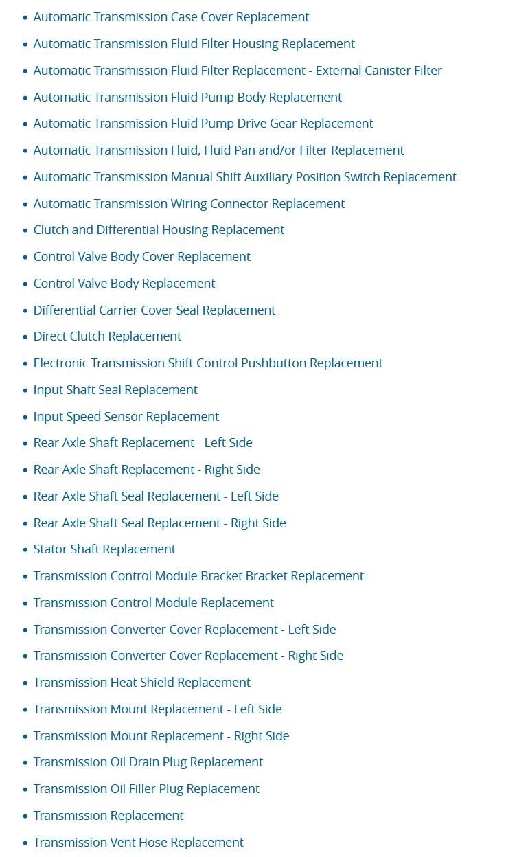

Yes, the 2022 Chiltons does have a "Direct Clutch Replacement" procedure (see attached PDF).
Here are all the R&R procedures available in the Chiltons for the trans:
Thanks! That is interesting. There is also a procedure and parts for dealing with park lock pawl issues, including the dreaded park pawl sensor drift issue, which previously required replacement of the transmission.
Folks have speculated about the reason internal repairs were not originally included in the diagnostic procedures. One thought being that GM/Tremec wanted the transmissions back for analysis. With repair procedures and parts being dribbled out as they determined the failure conditions and possible repairs. But its clear (and I suppose obvious) that parts availability is major factor as well. They have to be able to supply internal transmission components needed for the repairs.
