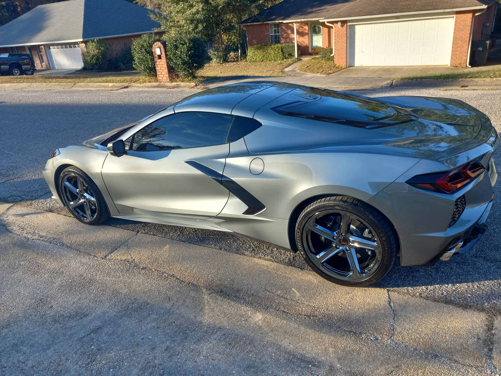

I went with 38/48 with stock tires and was a perfect fit. Front and rear were sat inboard of the fender approx. 1/8 “. Exactly the look I was after.

Beautiful car. Are the wheels MRR F23? How do you like them? Have you used them on track? I’m considering the F23 for track use.

Now you just need to lower it to take up the wheel well gap. Although with the way the offset is the tires may rub.

Those are Gem Motorsports G8Z wheels.
