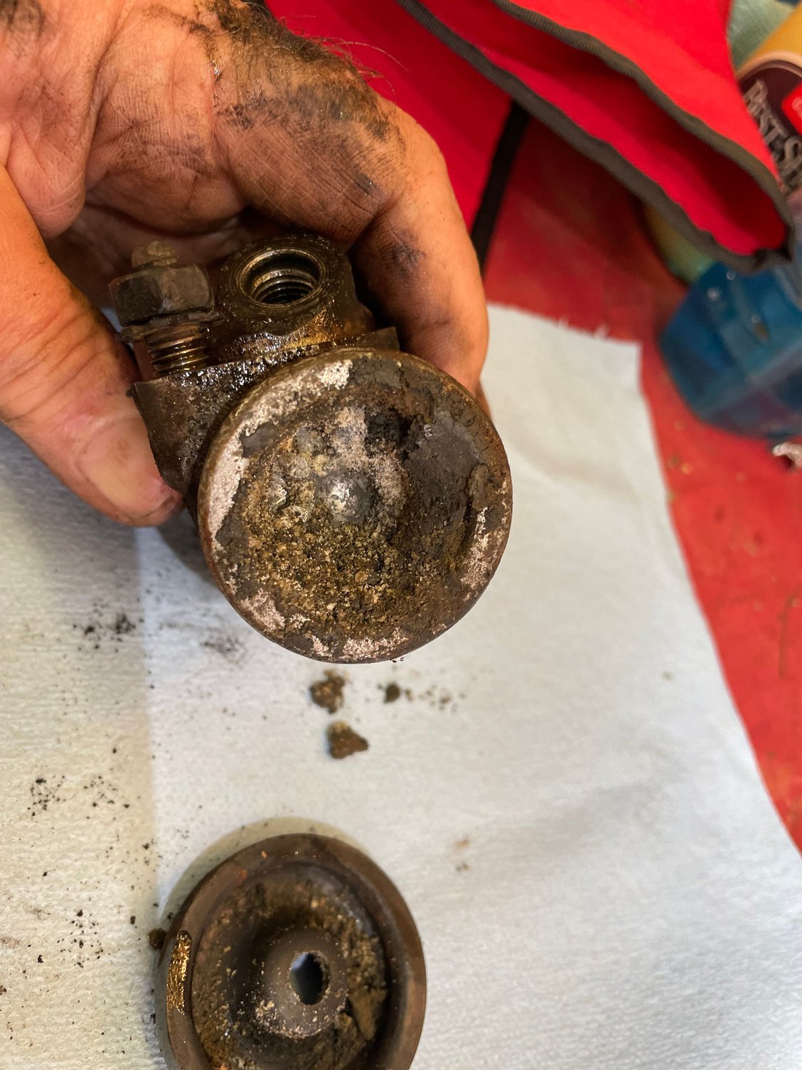

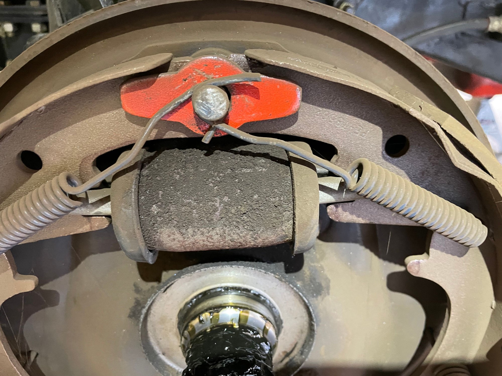

The attached image from 2022 shows my 60 vette wheel cylinder. Those brakes were working. Yet when the boot was peeled back, this is what was behind the boot. There was no visible fluid or leaking outside of the boot, but clearly there was some seepage there. Meaning moisture could enter.

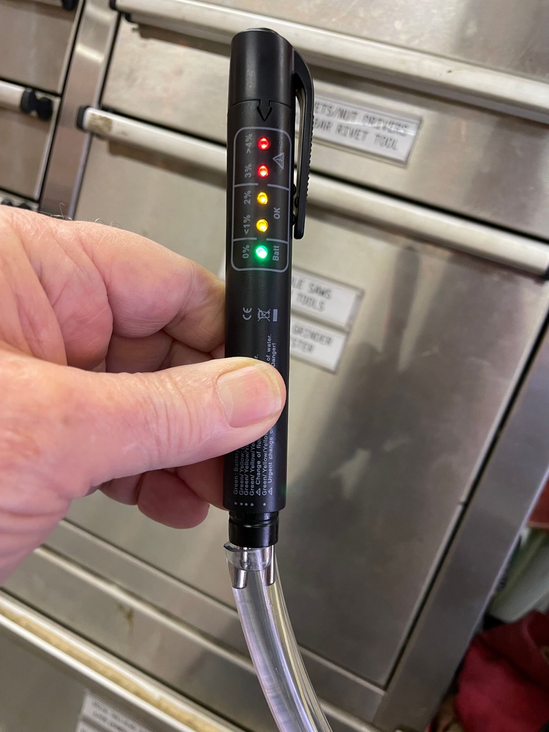

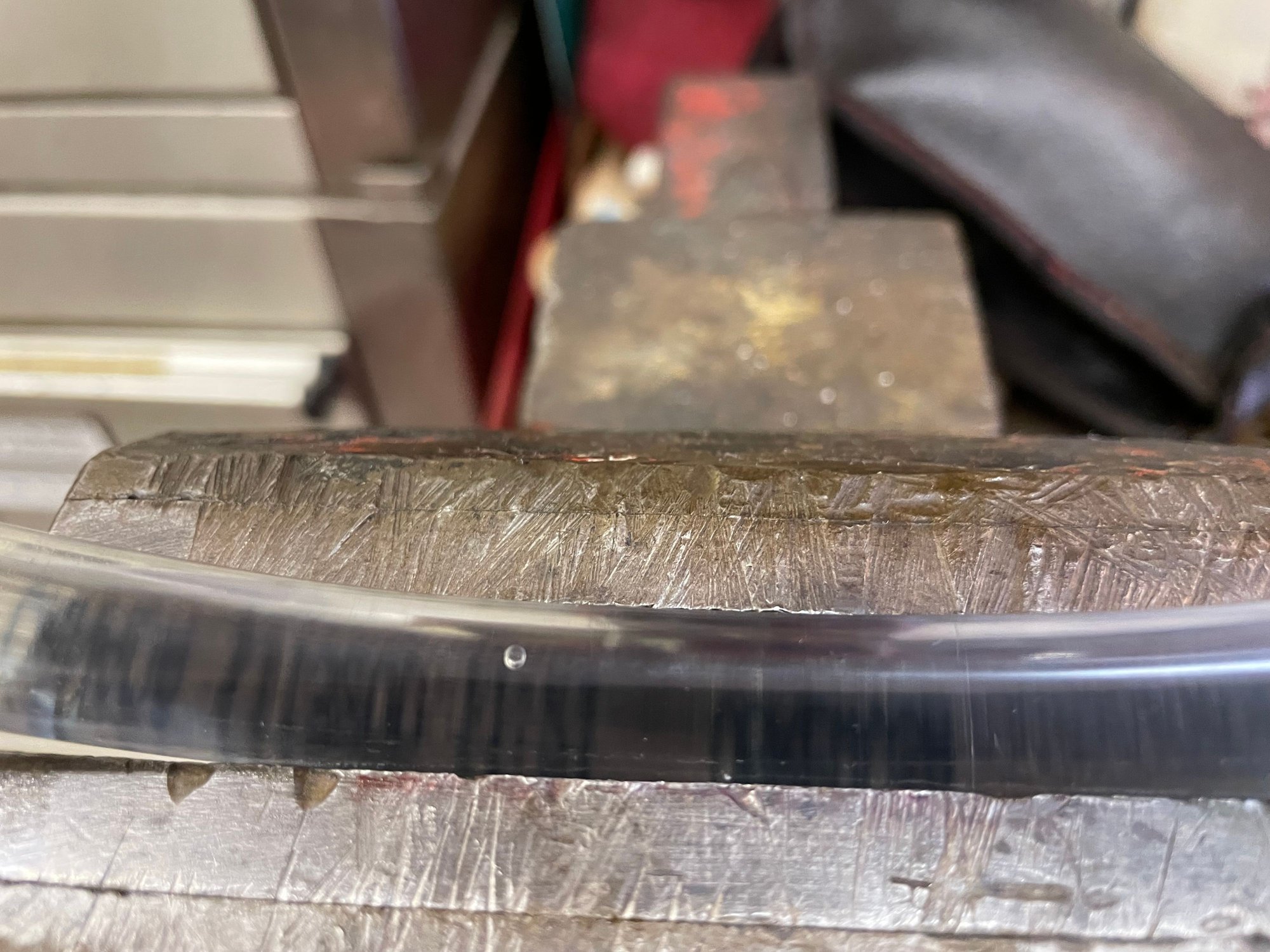

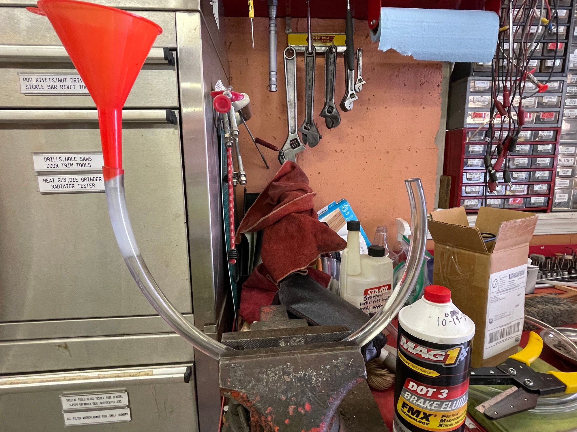

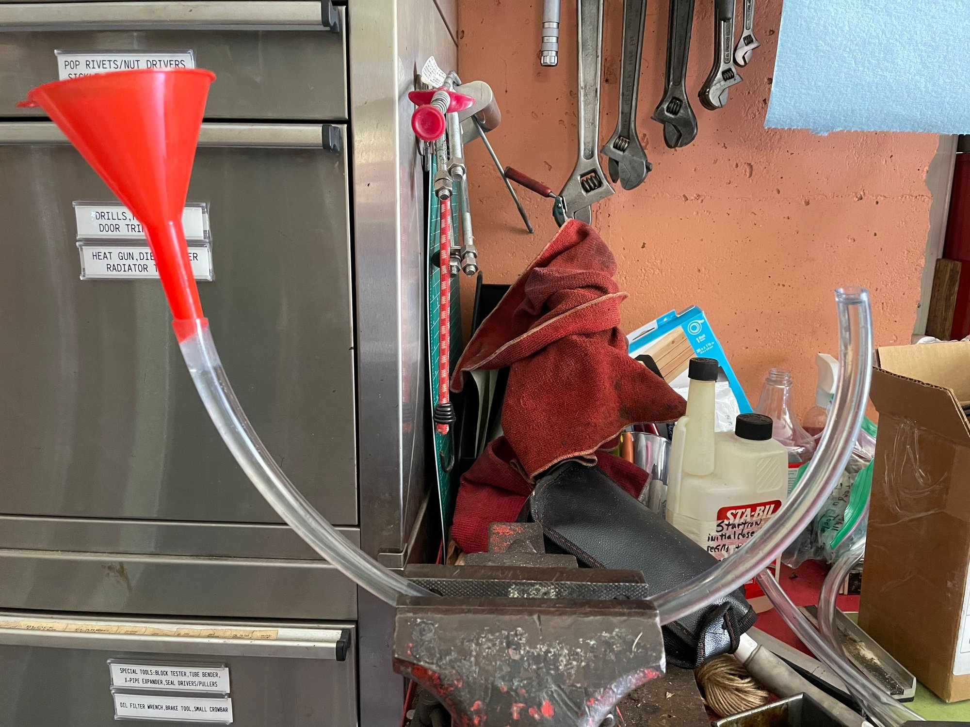

I've been running an experiment for day or so now - to see if moisture added in one end of a system will "disperse" in the fluid to the other end. My "system" is a bent tube as pictured. I filled it with fluid and tested it at both ends and in the bottle it came from - its measuring either 0% or <1% - it fluctuates. But then I added a "slug" of water - about an "inch" of length in the tube. I did this by adjusting the position of the tube to leave a gap on the right hand side of about an inch, then added the water slowly to the left side until it brought up the fluid level on the right right side to the edge of the tube.
The result initially was an area of cloudiness as shown. The idea was to see if the moisture would disperse resulting in an increase in moisture on the right hand side - so yeah it must go down hill and uphill. So far, between 10:14 AM on 3/29 and about 6 PM today, 3/30, the moisture content on the right hand side has not changed. Its 0% and sometimes <1%.
But there have been some changes. The cloudy area continued to hug the left top, it did not visibly sink, but........the length of the cloudy area shortened over a period of hours, and as of this morning, the cloudy area was gone. I think this because the it takes some time for the fluid to actually absorb that water - I did not do anything to facilitate mixing. Oh, yeah, I can measure moisture on the left side, and off the scale - so its concentrated there for sure. But has not reached the right hand side. Is it at the bottom now?? IDK.
One more thing I noticed - in the vicinity of the cloudy part, there are tiny bubbles forming on the inside walls of the tube that extend well below the cloudy area. The right hand side shows no such bubbles. I conclude that this is evidence that the presence of moisture (and the water also probably had some O2 content). at least as far down as the bubbles are appearing. That is, after all, the only difference between the left and right side. More evidence its "dispersing". And I also noted the fact that those bubbles are moving - as they form on the sides of the tube and release - they move upward. This creates some fluid motion which I think may facilitate dispersion. Vibration, temperature fluctuation, and brake applications will probably facilitate that. Similar stuff is going on in closed brake system.
I was hopin' to be able to say that the moisture fully dispersed to the other end of the "system" - but not yet. I'll leave it go for a couple of days.
10:16AM on 3/29 The cloudy area is where I slowly added a little water.
1:12 PM on 3/39 - Cloudy area is shrinking - I think as the fluid absorbs the water. You can see the bubbles forming on the left side but not on the right side. The attached video shows a close up the bubbles rising.
1:12 PM 3/29 close up of bubbles. None on the other side.
3:15 PM oon 3/29 - Cloudy Area is still shrinking. Moisture content on left side is off the scale, content on the right has not changed - 0% or <1%
9:03 AM today, 3/30. Now the cloudy area is completely gone. And, there are NO bubbles anymore. Moisture level on left side is off the scale. On the right side unchanged. You cant see the part in the vice but that fluid remain clear with no visible changes.

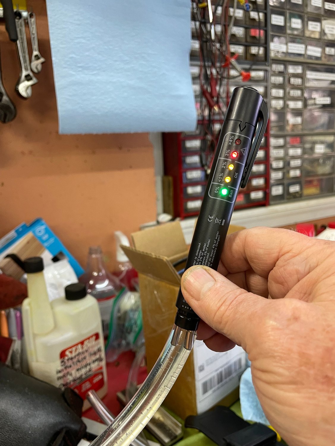

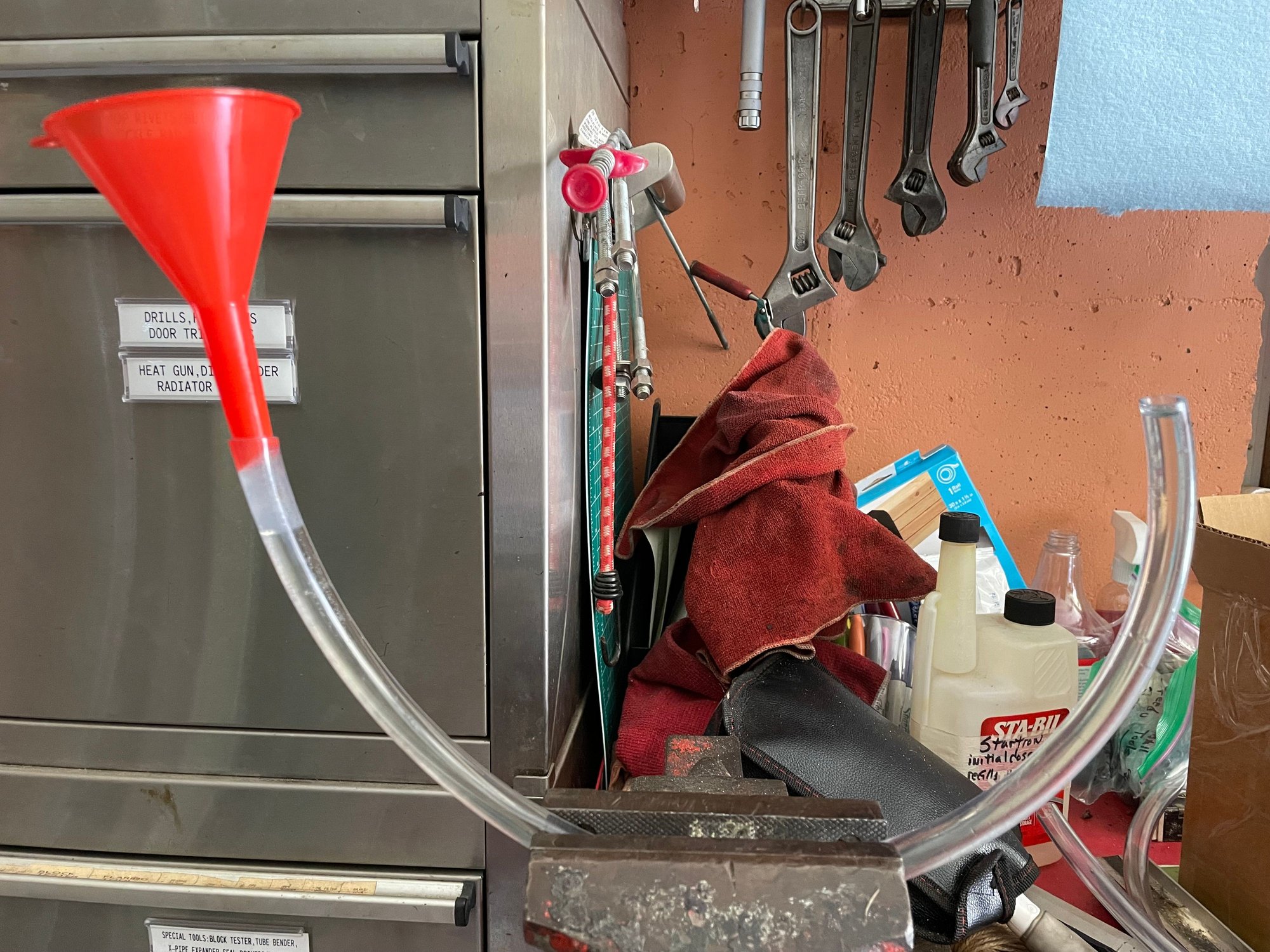

Here is an update, 8:30 AM on 3/31. This morning I removed the tube from the vice so I could inspect the bottom part. When I do that, there is of course slight (very slight) agitation - I try to minimize that but I keep the tube positioned so the fluid does not spill out of either end. There is no visible separation of fluid and water at this time. But there was single, tiny air bubble there at the bottom. That was not there before. Is that evidence of dispersion? Something leaching from the plastic tube? Who knows? Concentration remains high on the left side where the water was originally added. Its unchanged at <1% on the left right side as it was before any water was added.
All Below are 8:30 on 3/31

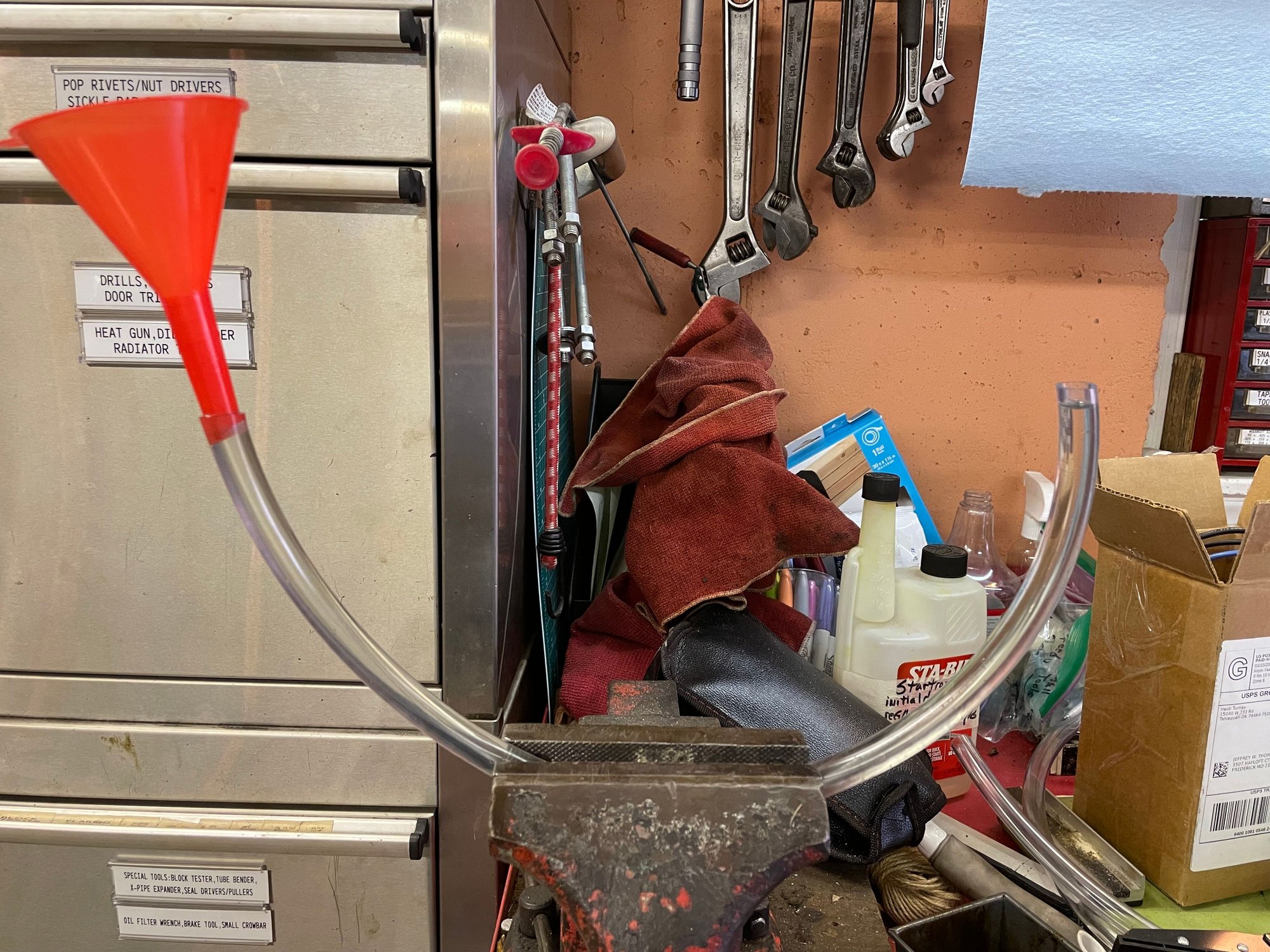

3 days and some hours later, and it now appears that the moisture has dispersed in the tube. No sign of separation or settling out. It now reading 3%. In retrospect I should have capped off that end since it could, I suppose, absorb moisture directly from the air. And maybe I should have set up a control rig with no water added.
I'm just trying to investigate the dispersion of the moisture - I'm not saying anything about not following the recommended fluid flush schedule - I follow it.
This is at 5:30 on April 1.
