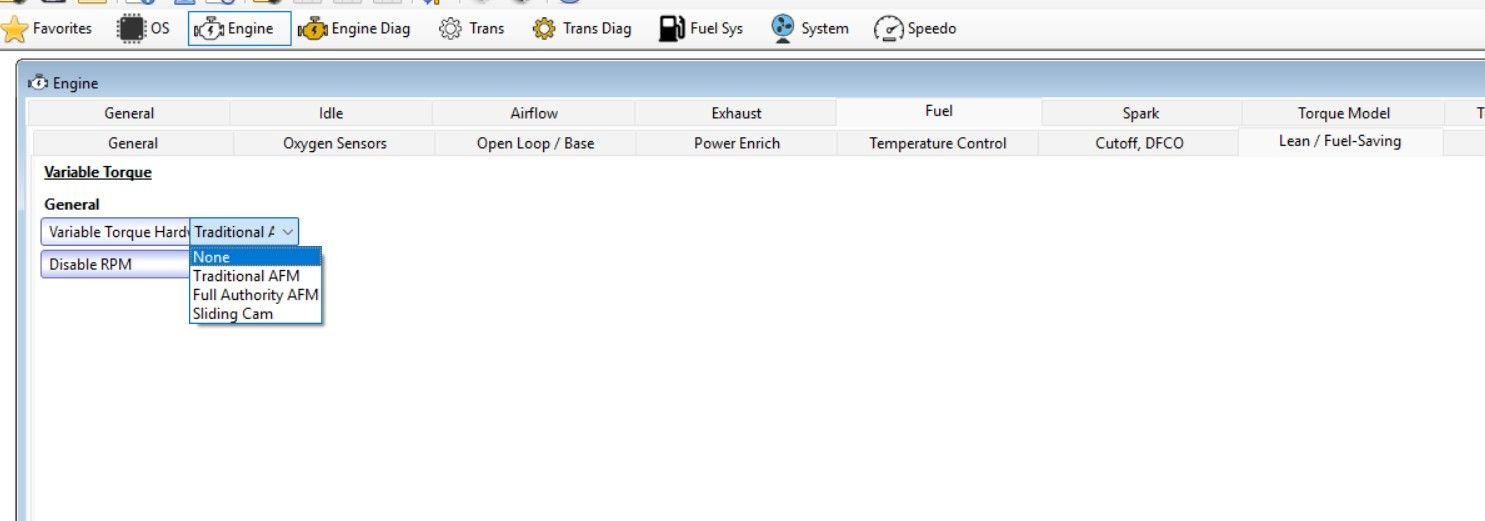

Got my computer back, can't find the prompt to disable AFM. it is supposed to be under fuel savings, but it's not. bummer

Look under SYSTEM - GENERAL

not for the exhaust valves for the DOD

I see the engine control strategy in ENGINE - Lean/Fuel Saving
At least I think this is the engine control strategy given the drop down values.
