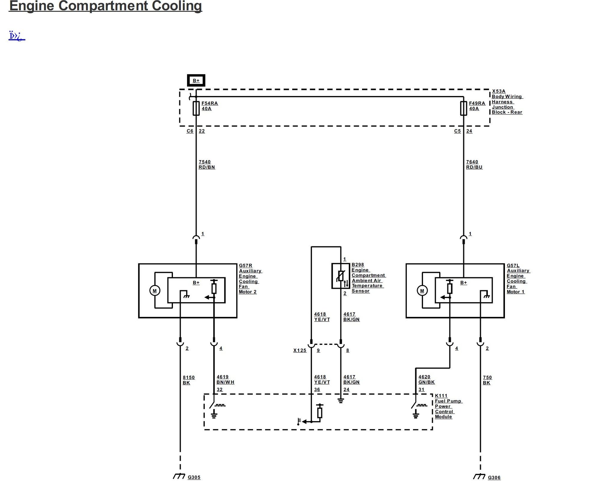

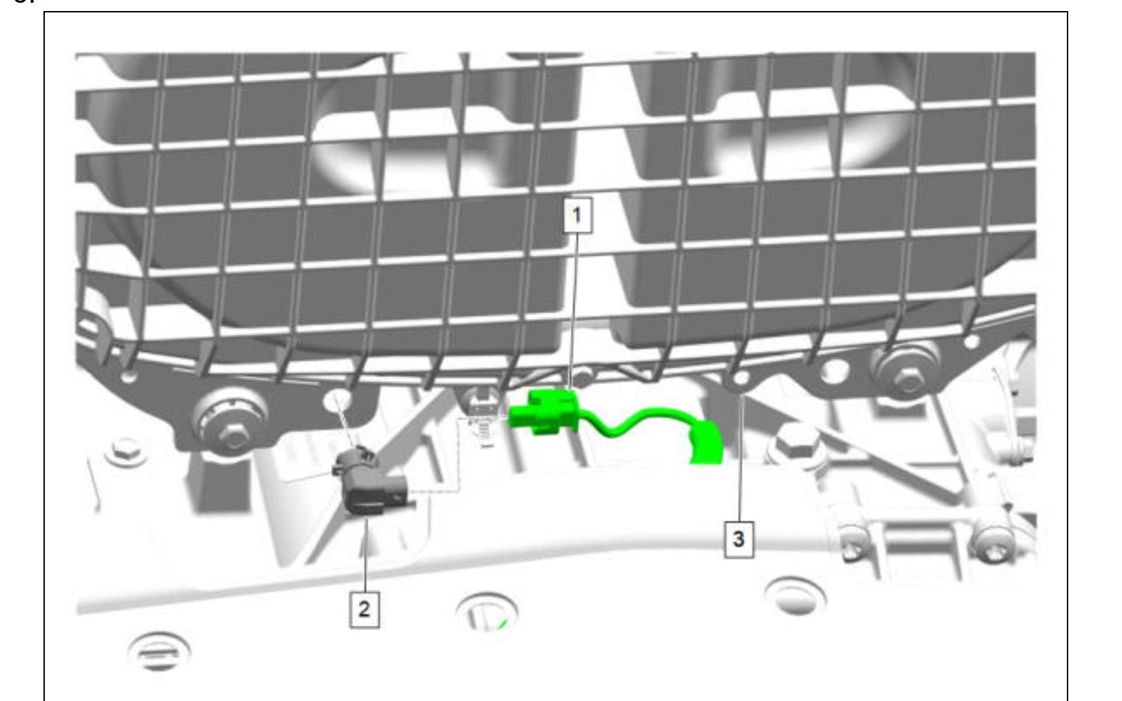

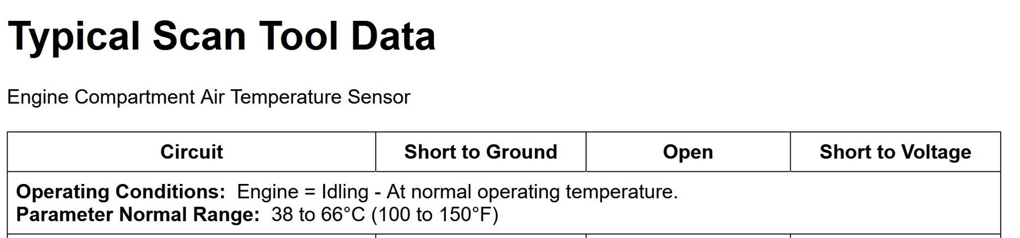

It may be useful to consider where the ambient air temperature sensor (aka engine compartment air temperature sensor) is located. Attached is an illustration showing where it is - taken from the "Ambient Air Temperature Gauge Sensor Replacement (Engine Compartment Air Temperature) - Removal Procedure" in my 2020 version of Service Manual for SR. The same procedure in the 2024 LEMON manual shows in a slightly different postion - do not know why. I attached that too.
Both say:
"Engine Compartment Air Temperature Sensor
Operating Conditions: Engine = Idling - At normal operating temperature.
Parameter Normal Range: 100to 150°F"
It has key role in determine when the engine compartment cooling fans come on, and at what speed.
To Cooling Engine Compartment
