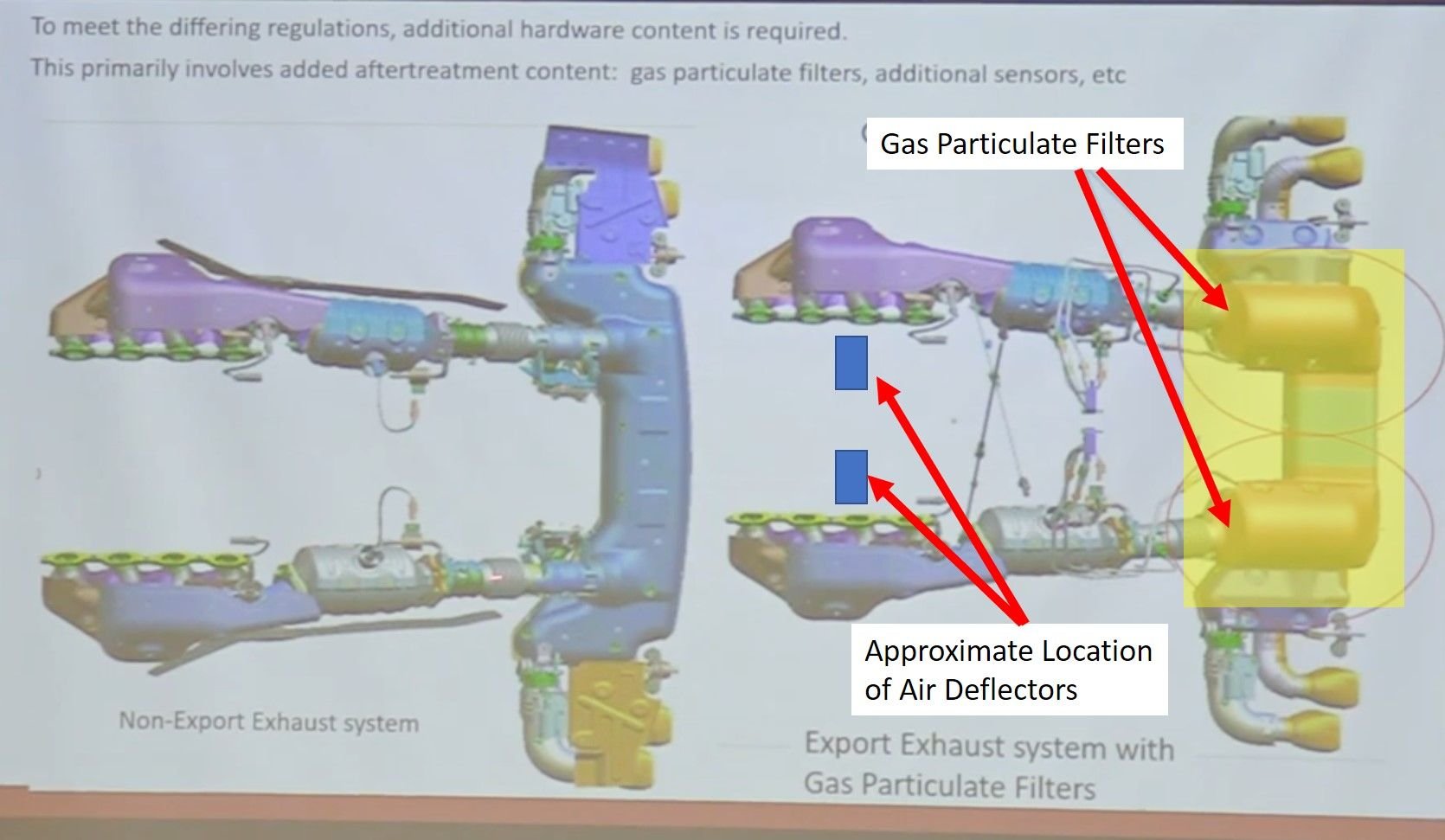

The attached picture shows the location of the air deflectors in relation to the GPFs. The air deflectors are actually bent forward which seems to direct air forward slightly. I’d like to see the CFD results that show the scoops direct air to the GPFs. I agree the scoops increase the air into the engine compartment. I also think this air helps the keep the exhaust manifold cooler based on location and direction of the deflectors.
“Power Loss: The restrictive nature of the filters causes a drop in engine output. For example, European Stingray models drop to roughly 475 horsepower (down from the U.S. 495 HP). Similarly, European Z06 models drop from 670 HP to 636 HP.”
Yes, the GPFs add extra head loss that results in lower HP and higher exhaust pressure and temperature. Also, the potential for operating at prolonged high speeds (high engine HP) amplifies the issue for the European version.
“Thermal Management: Because the filters trap soot and get extremely hot, European C8 models—such as the Z06—require additional underbody cooling deflectors to help duct air up and away from the engine bay.”
“Air up and away from engine bay.” Not directed at GPFs. Does it help reduce the GPF temps – yes. If it reduces the GPF temperature, why wouldn’t it help reduce the trunk temperature which is in the same location and is consistent with my measurements and others here?
If you look at this logically, increasing airflow in the engine compartment with these deflectors should increase the relative air pressure on the engine side of the auxiliary cooling radiators which, in turn, should reduce the pressure drop across them, thereby reducing their effectiveness. I have found no discernible difference in any of my oil or coolant temps though.
We don't have access to all the data that the GM engineers have nor the specifications for the components. Aerodynamic flow is tricky. It could be the engineers compromised optimal cooling when they installed the deflectors to to avoid exceeding peak allowable temperatures when the GPF filters were installed. The less than optimal cooling may be considered acceptable in a country like Germany with lower average high ambient temperatures but would be unacceptable in areas with higher summer temperatures. The fact that the OEM deflectors are not mirror images suggests there is more to them than meets the eye. Without access to the data we don't know, it is all guessing. It is quite possible Josh Holder's statement is accurate.
