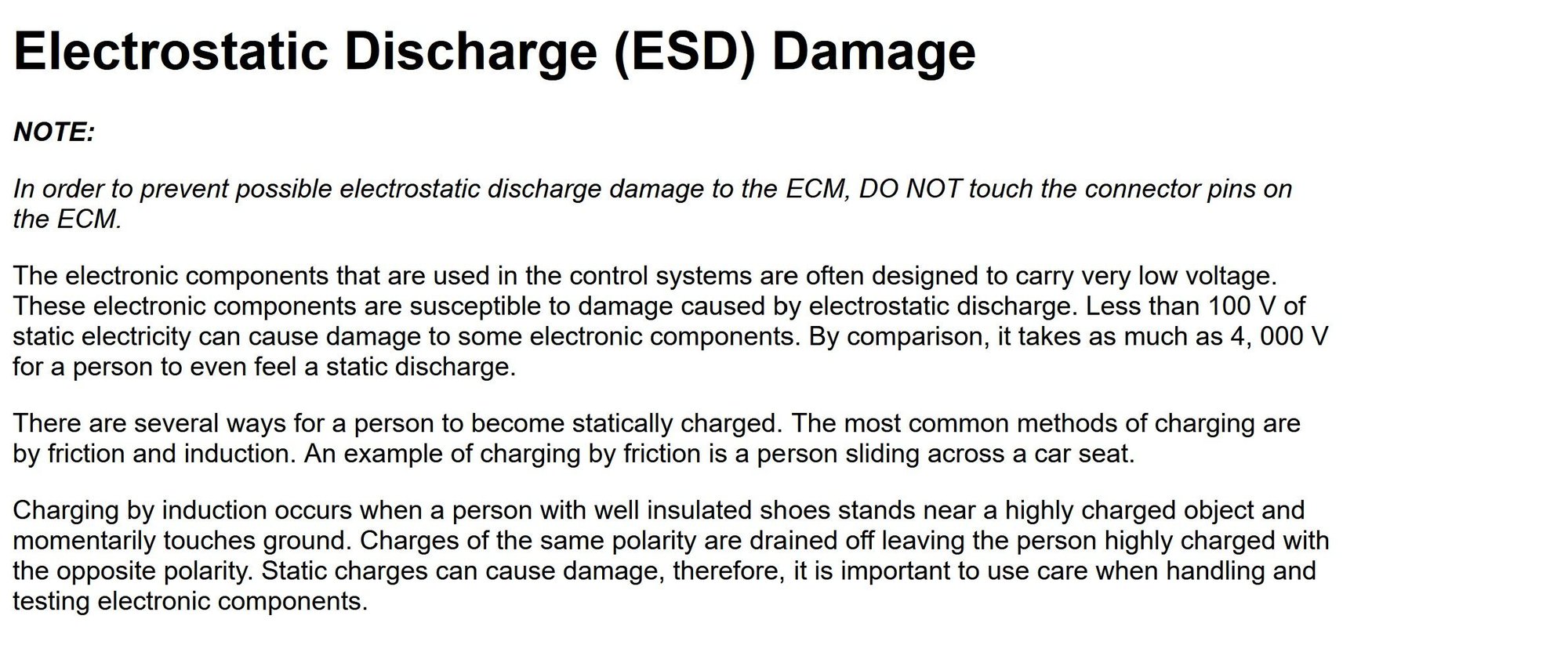

If you're concerned you can get an antistatic bag large enough to hold the ecu. Don't put the ecu in a normal plastic bag. You can even wrap the entire ecu or at least the connectors in tin foil to act as a faraday cage. ESD can be insideous but shouldn't pose a problem removing and reinstalling.
