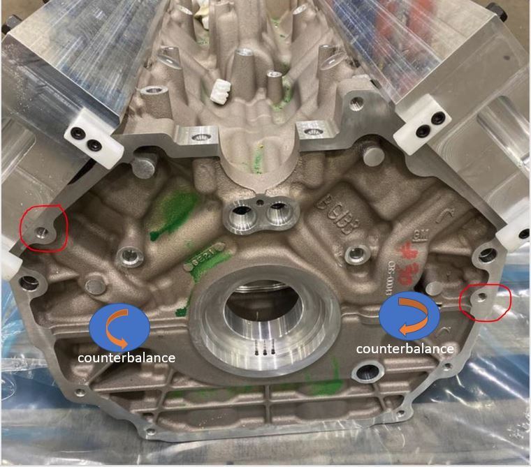

Originally Posted by Racer X
There has been some mention of using counter balance shafts like have been used on large displacement 4 cylinders (they are FPC). Maybe they tame the secondary vibrations enough.
They'd probably opt to mount the shafts directly right/left of the crank like this. I don't really see any direct evidence of this on the block casting (if this is the block). It'd also be a large amount of rotational hardware and they'd have to gear the shafts up by 2X in speed, off the crank. It would counter the seconday but would create a rocking couple which vertical engine mounts could take out, but I dunno. It's a lot of extra parts. If they located the shafts over/under the crank then no couple, but I don't see any room for this over/under at all.

Originally Posted by 500
Porsche used them in 1982 for the new 944's, I bought one new and they worked extremely well no vibrations of any kind at any rpm. I believe Mitsubishi pioneered them for cars if I remember correctly.
They do work. With some overhead. A guy named William Lanchester first patented the idea in 1912 or so, so it's been around and is pretty well known. In a four-cylinder, since the secondary vibration goes directly up/down parallel to the cylinder bores, the shafts can be located side-by-side as I drew above, but without creating a rocking couple. Flat-plane V8 is exactly the opposite, vibration goes right-left.
