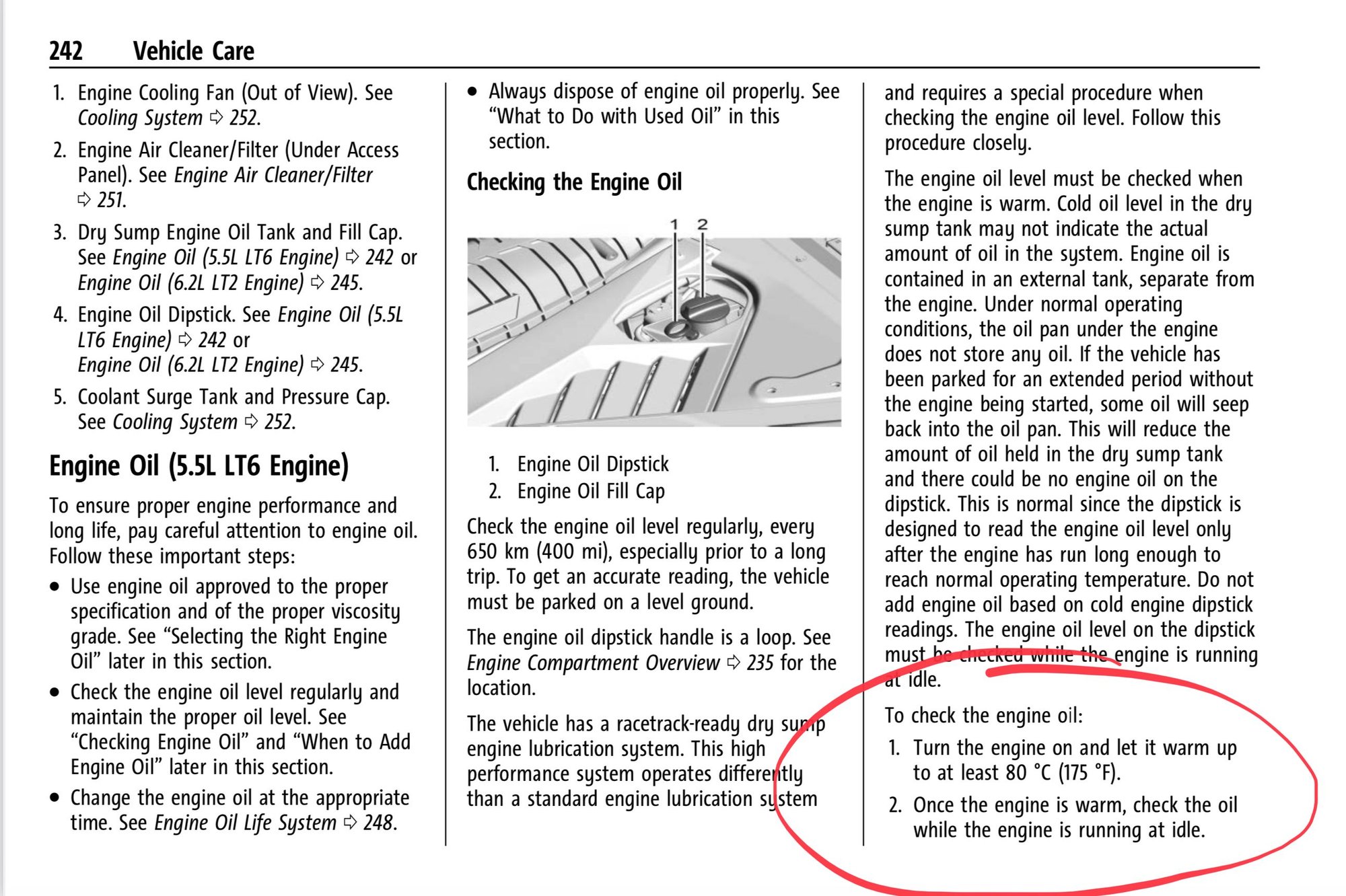

Oil temp only gets up to the mid 130’s while driving on the highway in 44 degree weather. According to the video, manual specifies operating oil temp should be at least 175. Definitively peculiar, would be interested to see if other Z06’s do this as well.
I know everybody thinks he’s a nut, which he is… but how do you explain the car in this video only getting oil temp up to 111 to the mid 130’s in 40 degree weather on the highway? He has other videos besides this one were the oil temp is even lower than the video posted here.
Is there something wrong with this particular car or is this how they all operate? Can somebody more mechanically inclined than I explain this?

The Engine Coolant needs to get to 175F to check the oil level at idle, not the oil temp. The C8Z was designed to keep the oil from getting too hot (over engineered) when on track on a 100 degree day. My 09 Z06 had a dedicated (air to oil) oil cooler, and when driven on a cold day the oil temps were similar. I had to switch my 09 Z06 oil cooler to the ZR1 (oil to engine coolant) oil cooler in order to get the oil temp up to an acceptable level. Later (after 09/10ish) Z06s used the ZR1 style oil to coolant stye oil cooler.
TLDR: As designed.

Got it… I was wondering if it was the coolant temp instead of the oil temp… manual is a little bit confusing to me in that regard. I admit I’m not nearly as mechanically inclined as many of our members, so I appreciate the detailed explanation without the ridicule. Thanks!
