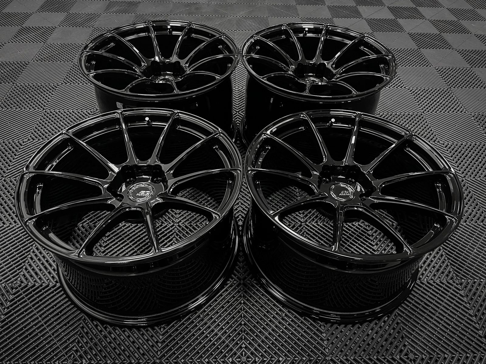

Track wheels are custom 19 inch BC Forged monobloc forged aluminum wheels. Tires are Nankang CR-S v2 in 295/30/19 and 325/30/19. Interested to see how the combination works, but I didn't want to use stock size cup2r due to running costs. Wheel pic below, more pics from the track in a couple weeks.
I went with a more aggressive alignment to get better outside shoulder wear on track and grip. I am willing to trade some street driving tire wear to improve track performance and wear.

I did 19x10.5 front and 19x12 rear. I would love to use Goodyear 3R tires, but while I want to kill understeer, I didn't know if the available front sizes would work well (305F/325R would reduce the stagger from 70mm stock to only 20mm), and I wanted other tire options if and when there are tire supply issues which I have had in the past. I talked to some folks who ran 295/30/19 and 345/30/19 Hoosier R7s with good success, and the Nankangs I am using are similar in actual sizing. There are options in 295/325 including Goodyear SC3, Continental Extreme Contact Force, Nankang, R7 as well as other options like Toyo RRs, R7, and Conti ECF in 295/345 that will also fit.
For specific offsets and sizing, I would talk to Dan Young at BC Forged North America to discuss your desired setup. He was very helpful and I ordered direct from him and they were produced, milled, painted, and shipped in around 3 weeks. http://www.bcforged-na.com

I considered 19x12 through 19x13 for the rear, but after talking to BC Forged we decided 19x12 was best for my desire to be able to run both 325 and 345 on the rear. After mounting my 325 Nankangs on the 19x12 I don't think I would want a wider wheel personally. Design widths and sizes are very similar for Nankang and Hoosier R7 in 325 and 345 respectively below.

Originally Posted by Cytvette
Cam I see a picture of the set
Picture of what set? The wheels and tires?
