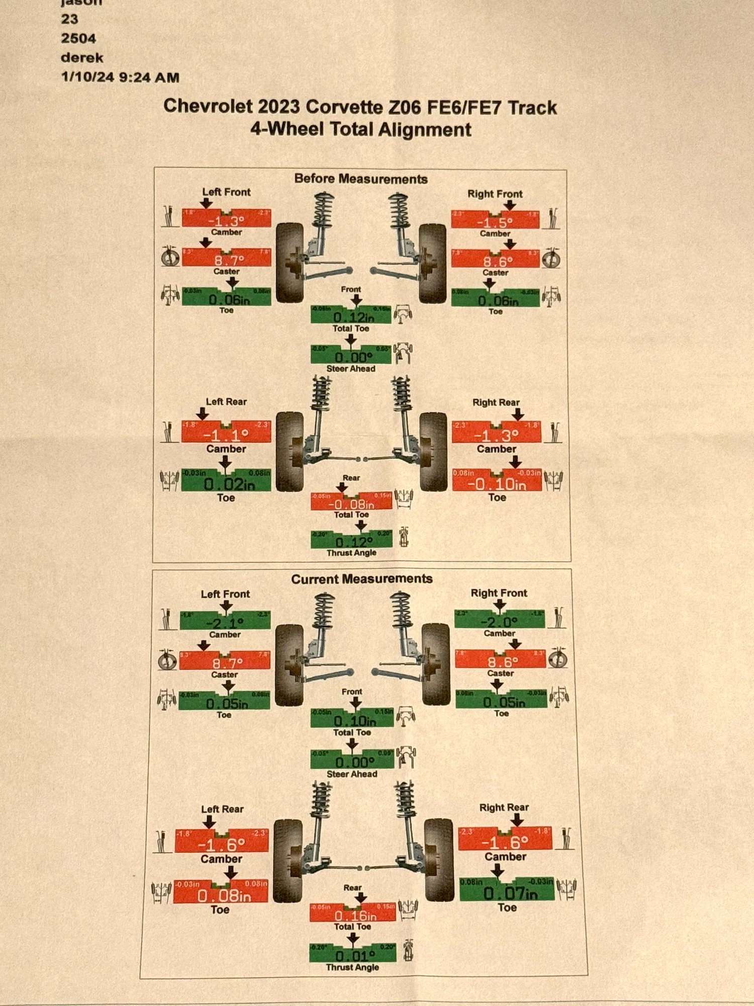

For those of you that have lowered your cars, with and without the front lift. Did you have to do an alignment afterward? I'm considering lowering mine now.
Yes, I did an alignment after and it turned out great.
The -1 to -1.5 is the factory alignment after being lowered 3/4" correct?
Correct - 3/4" (all the way down) on rear coils. Paragon sleeves installed in front (front lift car)
