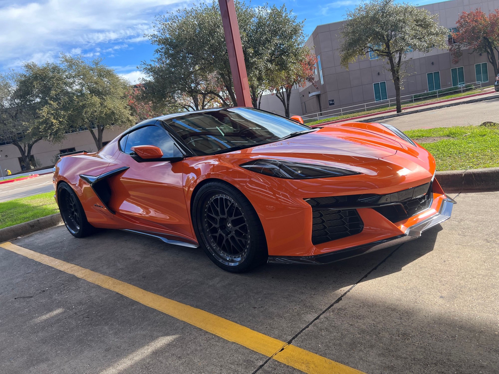

PuffC8's Avatar
PuffC8
Joined: Jan 2022
Posts: 808
Likes: 704
From: Houston TX
Originally Posted by turbotuner20v
That's the beauty of front lift. Stock height w/o front lift is relatively manageable by many, so if you lower it but can use front lift to get back to that height, it's the best of both worlds
Exactly, whole reason I’ve even specd Front lift on all of my C8s, knowing I had the intention to lower them.

PuffC8's Avatar
PuffC8
Joined: Jan 2022
Posts: 808
Likes: 704
From: Houston TX
Originally Posted by Z0HS1CK
Yeah i lowered mine 3/4" but i don't have front lift.
I was more annoyed at the ugly *** offsets GM gave us over the monster ride height. It actually didn't look that terrible in comparison to the stock C7Z height. Could be body types that gave me a different impression.
I had to lower the car and add spacers in the rear. So much better.
But if you do spacers or aftermarket wheels to get proper offset, and don’t lower it, it looks 527363 times worse IMO. Because you see the tire tread and it looks even more monster truck like.

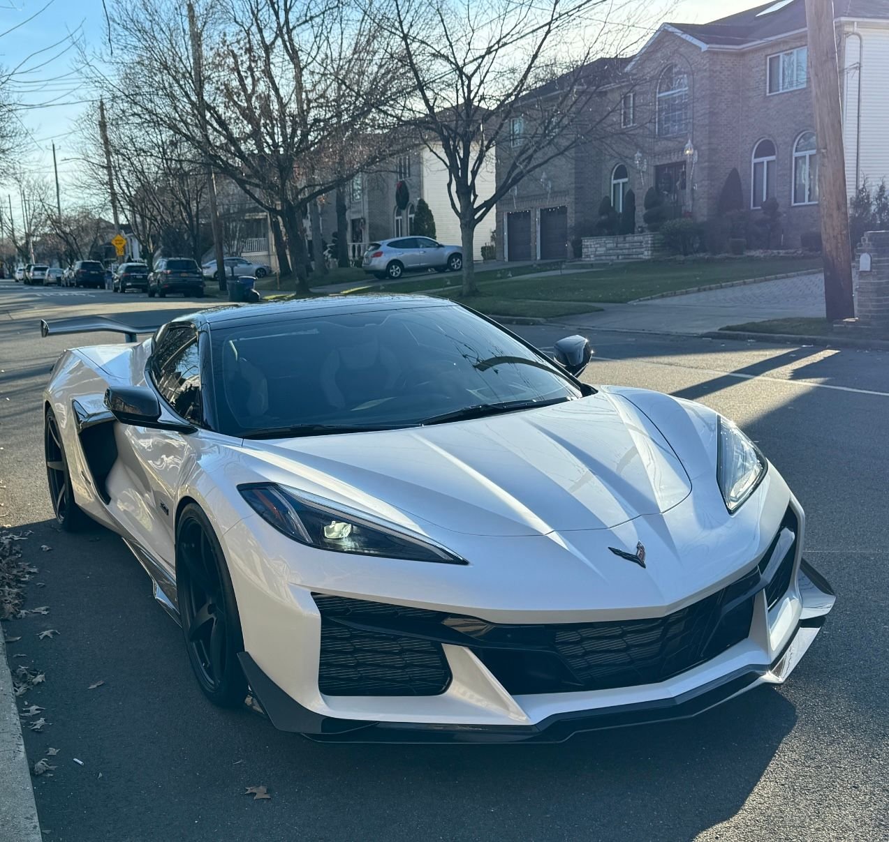

Old Jan 31, 2024 | 08:35 PM
TRANS DAMM's Avatar
TRANS DAMM
Joined: May 2001
Posts: 2,472
Likes: 1,246
From: Brooklyn NY
Lowered with front lift.
