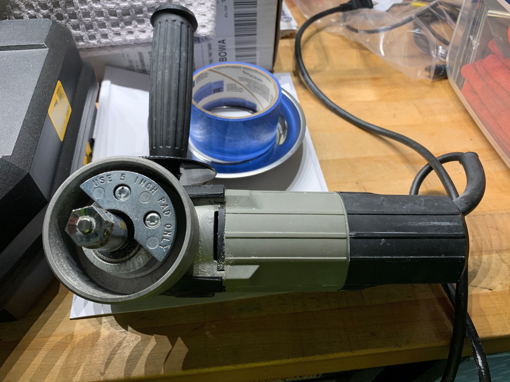

Not trying to hijack the thread, but I would like to the same thing with my old PC. I pulled it out of the toolbox today and noticed it had the older model pressure bolt and not the threaded backing plate connector. It also says to use only 5” pads but I will live dangerously if I can find an older style 3” backing plate. Do they still even make them?

I run my 3" backing plate with my 5" counterweight and it runs fine. The counterweight concerns really only apply when using the PC as it was originally intended---when sanding. Not sure if they make the old-style plates for the PC. You might want to look at the plates for other brands that use a similar bolt. Maybe some of the rotary machines.
