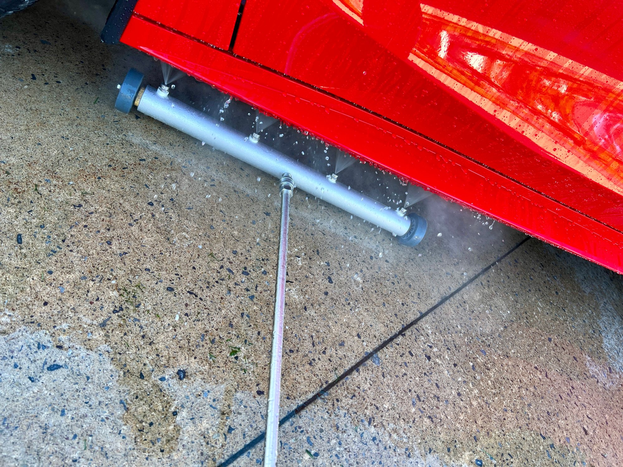

I don't drive my C8 during the winter so it doesn't get real dirty underside. However before I put it away for the winter I wash the underside....I spray foam under the car and and rinse it down well. I then blow dry it to get most of the water off it. Once in my heated garage and up on the Quick-Jack I crawl under and detail it. I know it sounds crazy but that's just me and the way I keep my car.
I have two of these....one is set up to use a Foam Cannon with the larger nozzles.

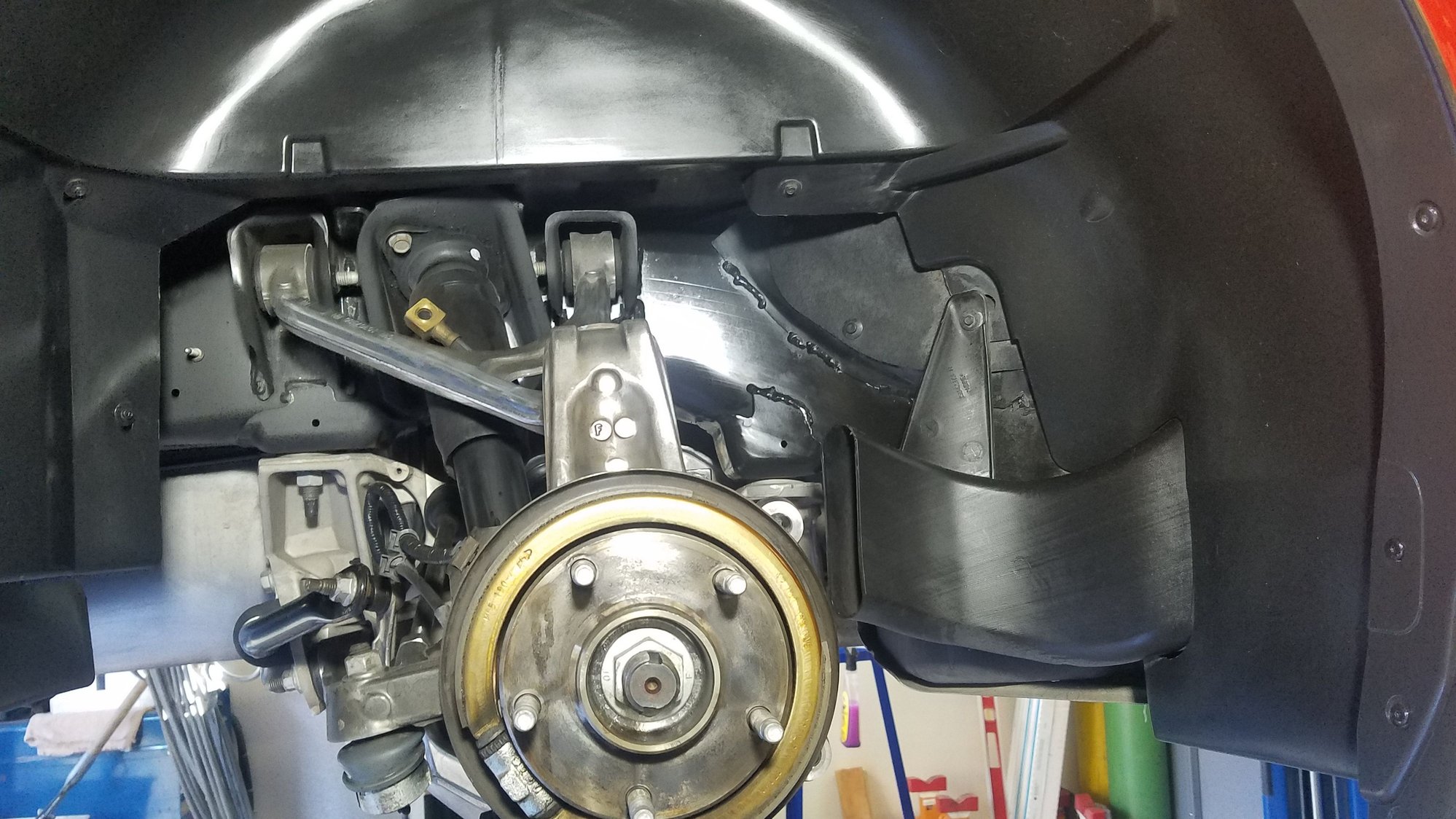

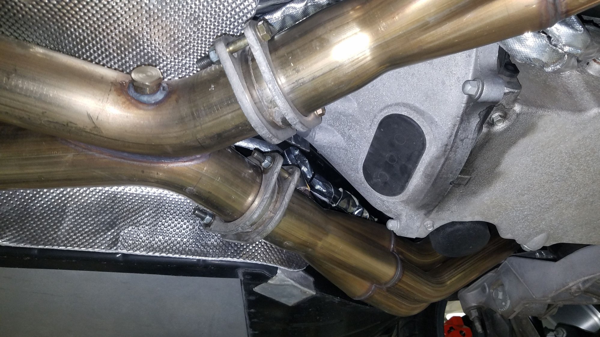

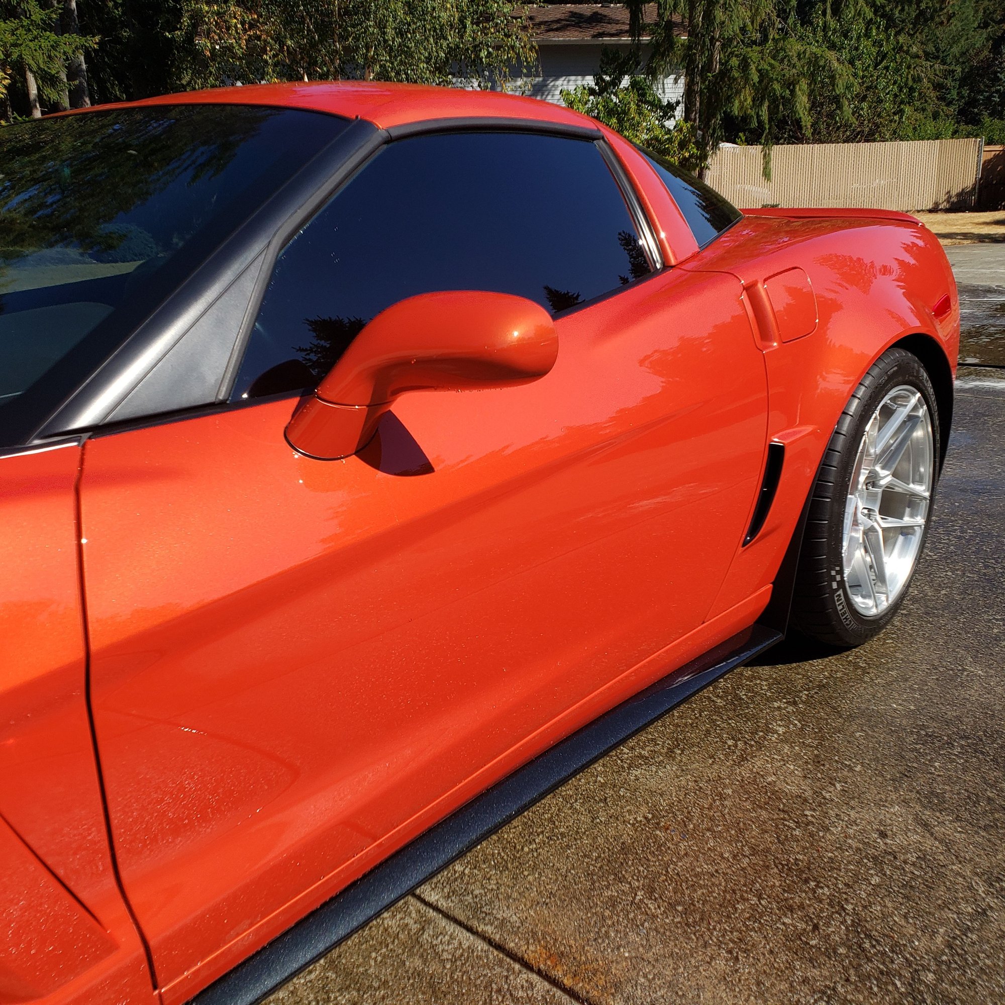

I own a garage queen 2012 Grand Sport, Dont Drive in the rain
Ive pressure washed and CLEANED the Underside................
Much easier for me as I have a two post lift....................
I Used a NAPA Acid Based Aluminum Cleaner on Control Arms and then Power Air Driven Wire
Cup to "polish" the Aluminum Control Arms.....
I had the Calipers off and were sent away for powder coating when pics were taken

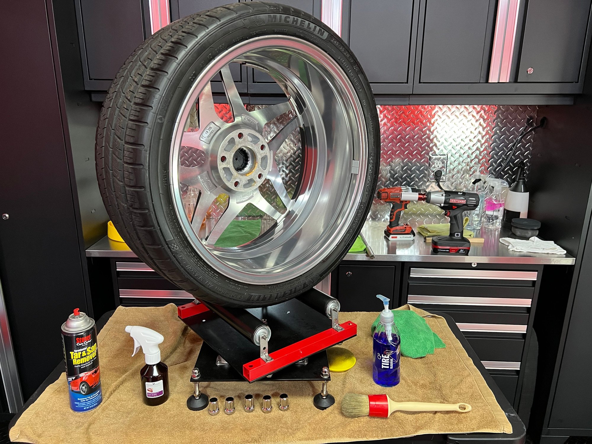

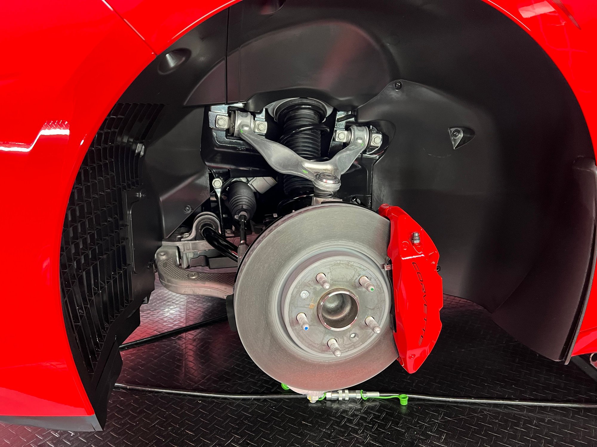

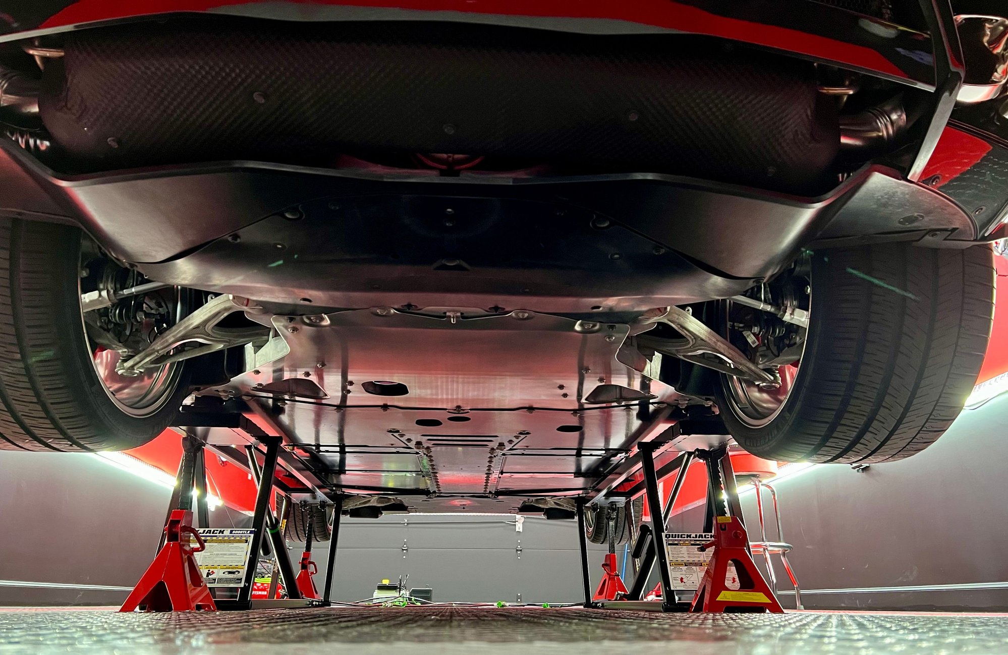

All wheels off and thoroughly detailed
The underside is cleaned and buffed...ceramic coating is added.
With the wheels off they are thoroughly cleaned, polished, and ceramic coating added to finish them off.

Is the sprayer attached to a regular garden hose? I want to get one.

No, you cannot generate enough pressure through a garden hose. This tool will only work properly when used with a high pressure washer.
https://www.amazon.com/s?k=underbody...&ref=nav_bb_sb
Thanks, I just purchased this today along with a foam cannon and a small Karcher PW
I have a large Karcher gas pressure washer for the heavy stuff around the house, this will be just for detailing.

Just to clarrify , after using my undercarriage washer on wheels, you want ALL the Pressure
You can throw at it...............A small elec or gas PW say one under 2500 PSI isnt going
to accomplish what most people expect.................
Just to make sure you understand this......the normal undercarriage washer with the small water nozzles will not handle the foam.....this is why I have two of them. The second one I use is made especially to handle the foam cannon with larger nozzles. You could shoot the undercarriage with your foam cannon first to get the foam dispersed under the car.....after it dwells for about 5 minutes or so then use the undercarriage tool with your washer. The only way to really clean the wheels is remove them from the car.....the undercarriage tool shoots water vertically making impossible to wash the wheels properly. Good luck....I know you will enjoy this process and the clean belly under your car. Here's a short video on a tool.....
This is the undercarriage tool that will work with the foam cannon.....

Thank you, you just answered a question I was about to ask. "how to get the foam to go through the undercarriage washer"
I guess I will have to find a way to get the foam cannon underneath while on quickjacks.
https://www.youtube.com/watch?v=DcVVlGVbrxU
Oh well, I just ordered this, the one I ordered was the same manufacturer but without the foam option, I will either keep two or return the other one
