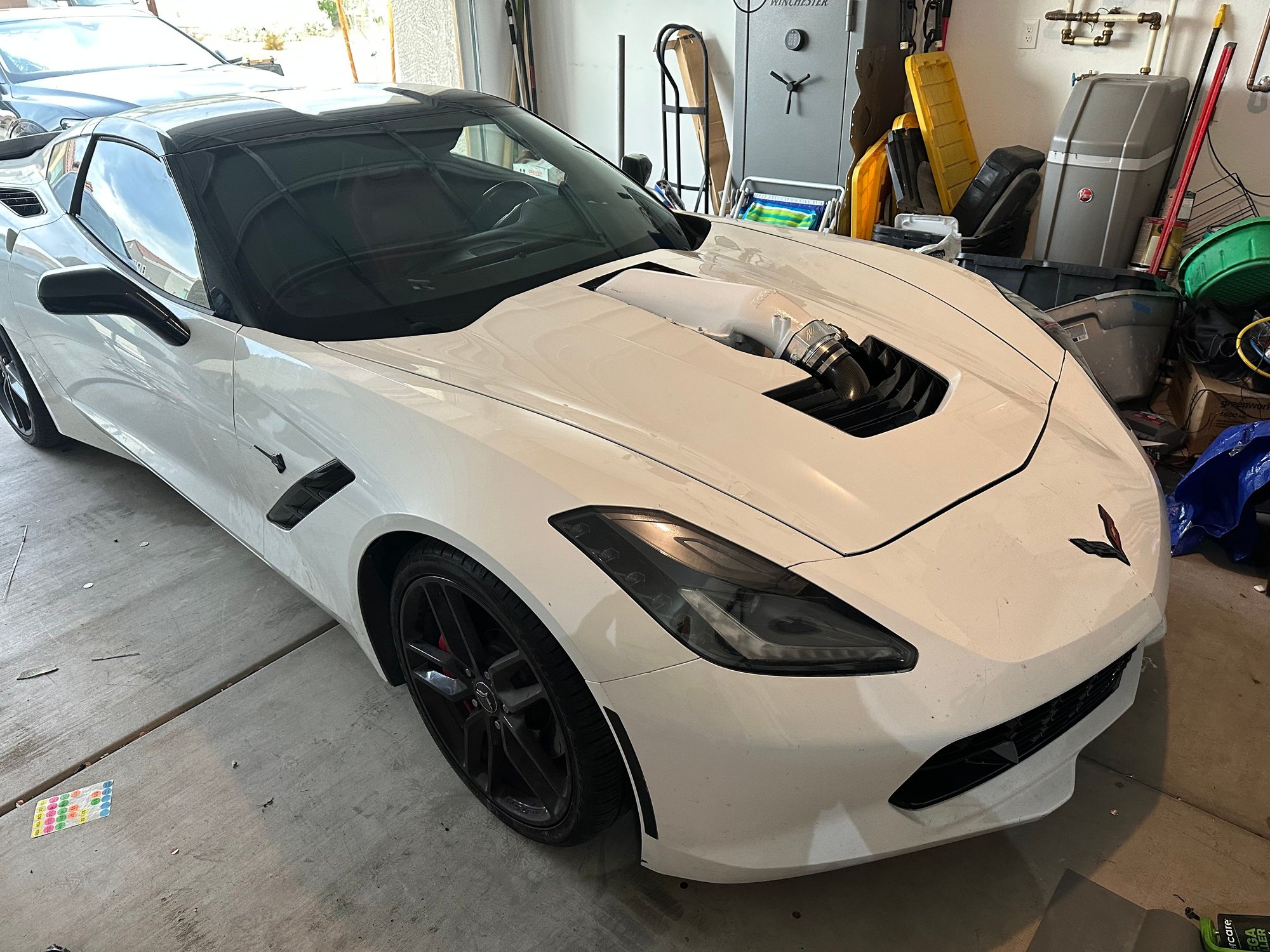

Looking like that? Not a friggin chance.
At best you might get to run one time but if you **** them off enough in the process it wouldn't be unheard of that not only do they bounce you but may also not even give you your timeslip.
If you're talking about Wildhorse Pass I've raced there a few times (I live in California) and they are surprisingly strict.
While you may get lucky, I'm not betting on it.

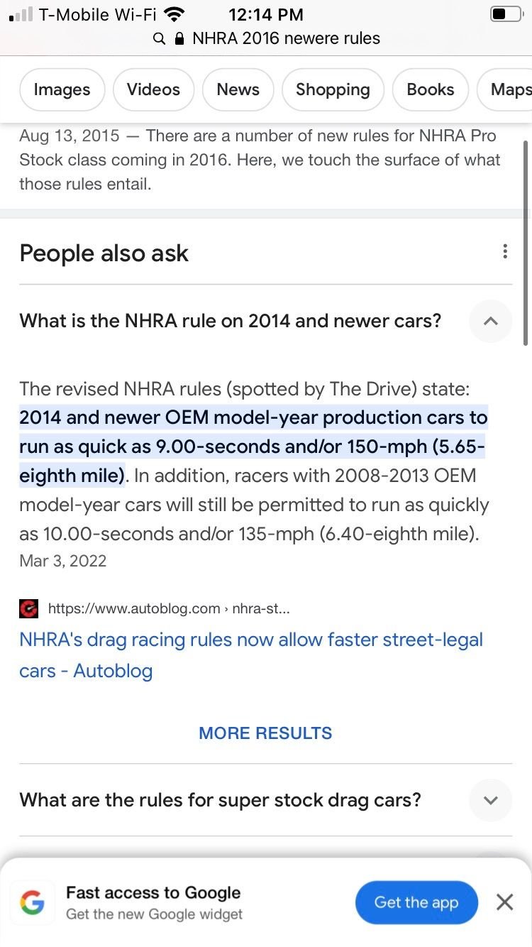

For 2014 and newer, rules change again.
9.0 and 149mph for “unmodified” street cars.

The car doesn't have to be "unmodified" but all of the factory safety equipment must still be operational.
