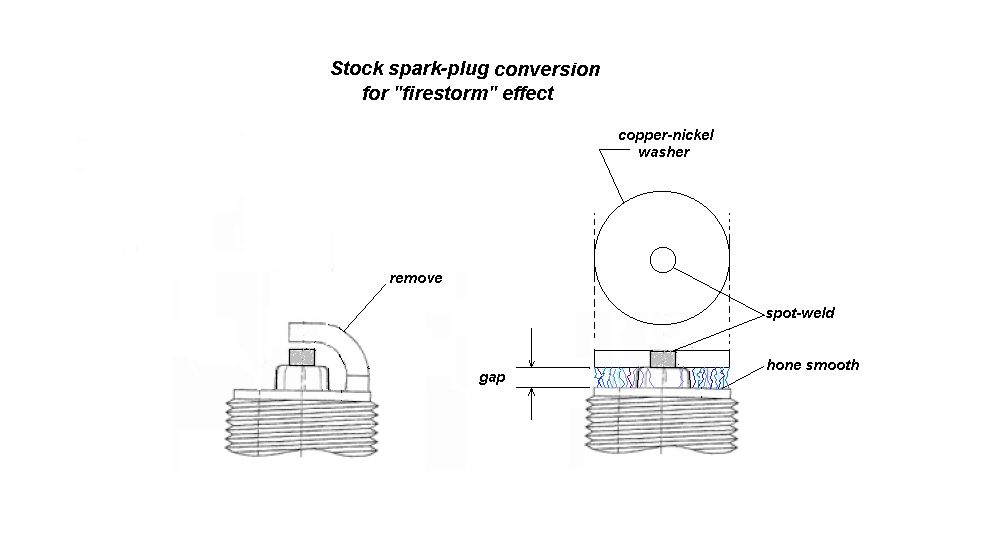

If someone can host a picture for me I have a really good idea that I think will improve spark big time. Thanks

PM sent, I can host it... no problem.

let me guess.
side gaping.

http://i7.photobucket.com/albums/y26...conversion.jpg
I hosted it....

youv'e done this and tested on what ????

Never said I tried it or tested it, but I did come across it on the net. Just wanted to get some feedback. Thanks

OK, it will take a Strong ign. to fire fore sure

If that washer came off inside the engine....

Looks to me like you are going to shroud the spark !! I can't see it working to well , but feel free to prove me wrong.

who is welding it on ????

The problem is, you won't have a "firestorm". You will only get one spark that will flow through the path of least resistance. Plus your gonna be blocking the whole chamber from the spark. Those bosch platinum 4 plugs don't through four sparks. The spark will only cross to the tip with the least resistance.
You could check this by pulling the plug and seeing the spark. If you do in fact get a firestorm I'd love to see pics of it happening.
Go ahead and try it if you would like, imo you won't see a performance gain.

Lame, never put a washer inside the cylinder.
An easier mod that does work is to cut back the ground strap to give the spark better exposure. The only penalty is shorter plug life. Some engines also show a few more hp when the spark plugs are indexed.
Electricity is lazy, no firestorm will come from that severely shrouded design.

The plug protrudes into the chamber for a reason. Indexing the plugs or the 4 tip is the best thing that you can do.
