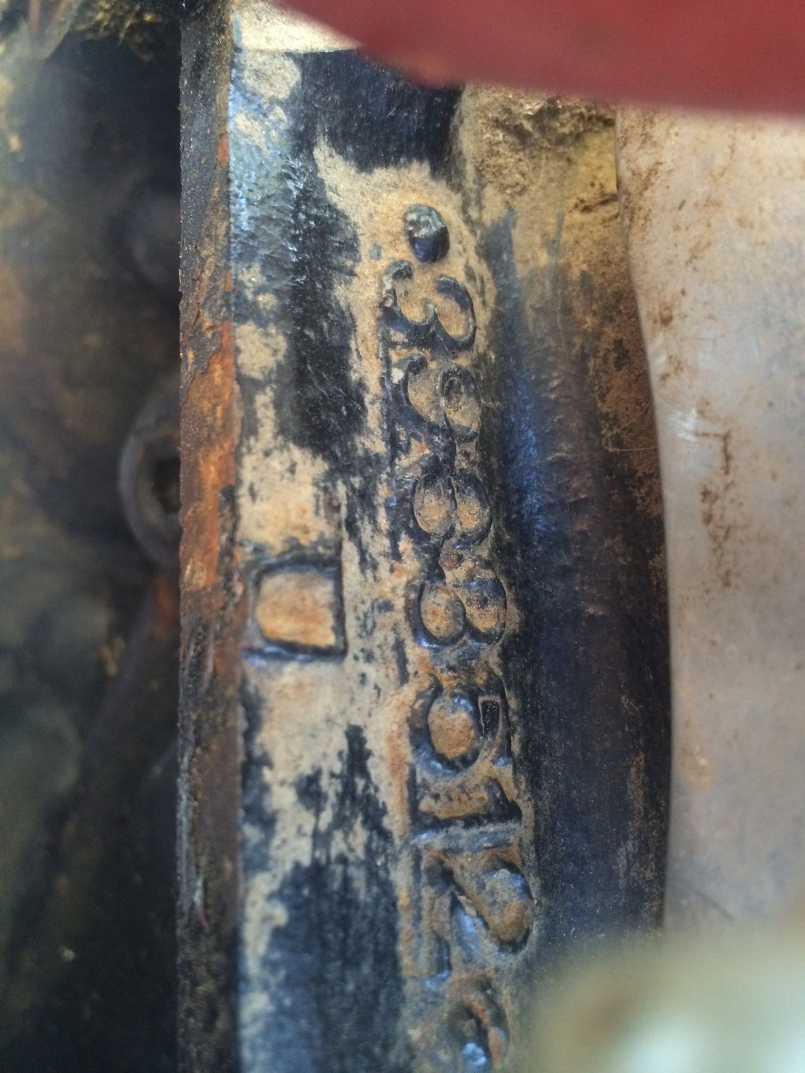

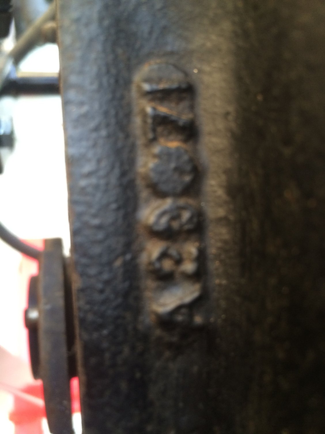

Sorry if there's already a thread for this but I recently bought a boat and pulled the engine out. The block casting numbers 3963512 A29-71 hi perf pass stamp and the heads are 3964291 steel rectangle port. The piston number is L2349 030 Can anyone tell me some more info on this engine? Is it desirable to the car world? I just want to build a boat engine, I rather this go to a car guy if it's worth something.

Your block number ID's as a 427/454 COPO block available between 1969-1971. According to the source info, it could be either a 2-bolt or 4-bolt main. Your block's date code (A29*71) indicates that it was cast January 29, 1971.

This is the source I used to ID your block and heads. This site will provide info on how to read casting date codes. Have fun with your LS6!
