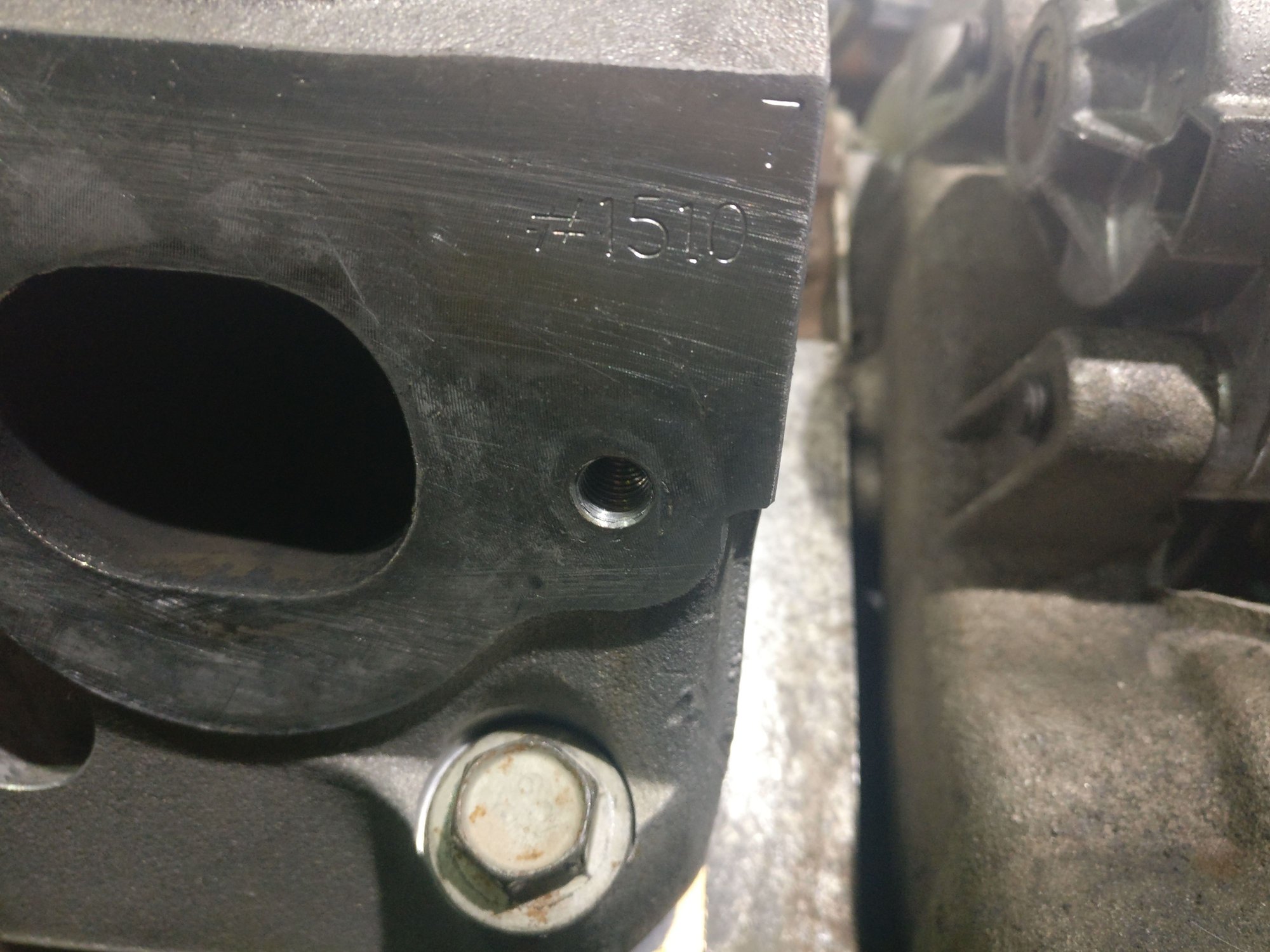

Hey guys, I want to apologise if this was discussed somewhere here first. But I have a LS3 engine and a set of AFR heads. The stock rocker panel doesn't fit or align properly. Any idea where and what rockers go with this AFR aftermarket heads??.
I'd be grateful if someone could point me in the right direction or suggest.
I've posted some pictures below
Anymore information I'd be happy to provide.

Those might not work on your engine with the stock rockers. You can google AFR and look up the casting and find out which heads you have. You have #1510 AFR - Airflow Research 1510
210cc LSX Mongoose Street Aluminum Cylinder Heads LS1 / LS2 / LS6 Chevy. It will tell you which rockers it will accept. Those don't appear to work on an ls3... LS1, LS2, LS6 but not LS3. Here is a link.
http://www.jegs.com/i/AFR-Airflow-Re...SAAEgLUivD_BwE
