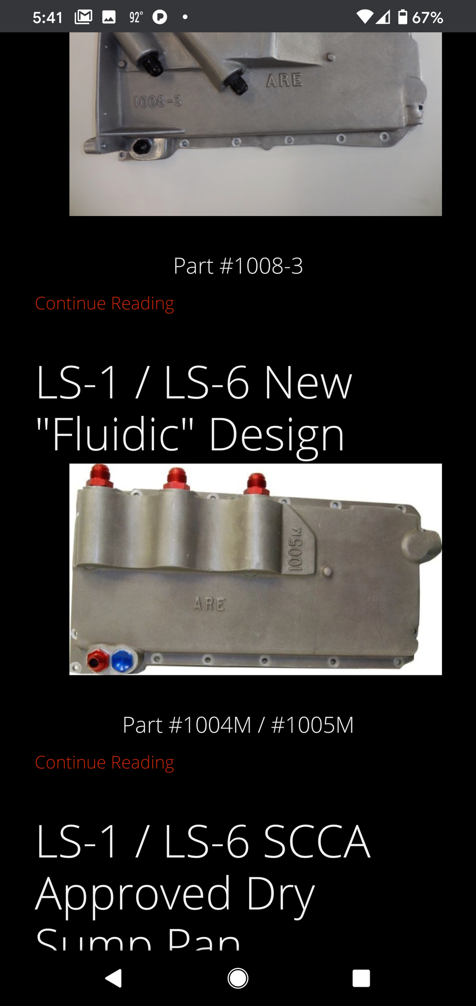

Old Jul 19, 2020 | 05:40 PM
Mrsideways's Avatar
Mrsideways
Joined: Aug 2005
Posts: 261
Likes: 33
Originally Posted by c5racr1
Even with a vacume leak it should still scavenge. I would take the pump off and send it back. After running the checks. What pan do you have.
ARE pan. This one.
