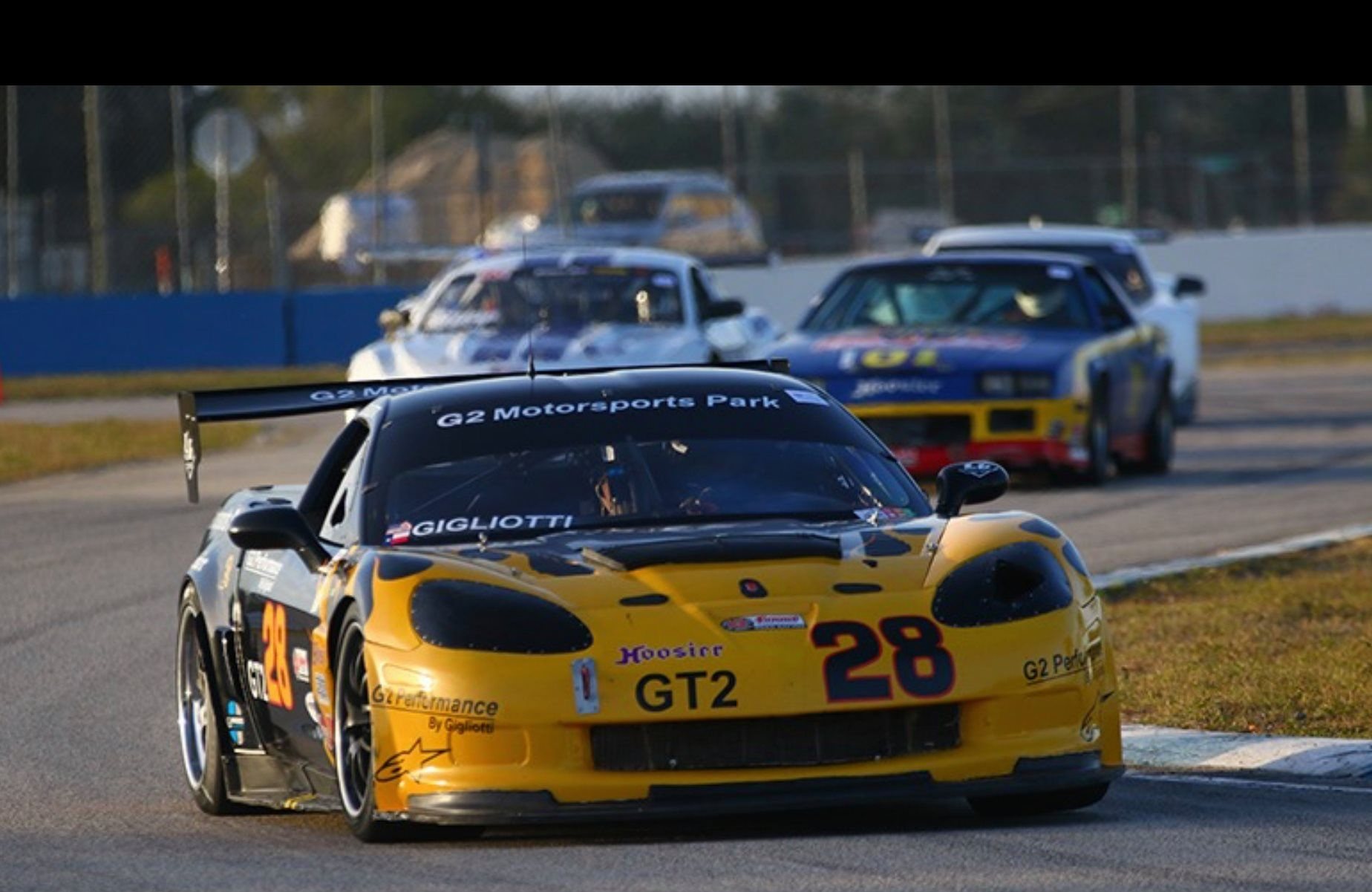

Testing my C6 SGT Trans Am Car. Getting ready for Road America next week
Per rules—NA. LS2 with LS3 heads. 12:1 compression max legal cam lift .650
car weighs 3050 with driver in car. Emco sequential trans 6 speed with 1:1 6th gesr. 3.73 diff
