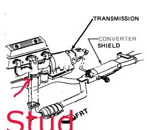

Corvette brothers and sisters;
I have a stripped exhaust stud on my stock header exhaust where it connects to the Y pipe on an 86. I've been told in order to replace the the stud I would have to pull the header and alternator and other things and do it on a bench. I was hoping that someone would know of a way without pulling the header. I can get a straight access to the back of the stud where it screws into the header. I'm able to get a long set of bent nose pliers on the center of the stud but it won't budge. Thoughts?
Thanks
Bobby
