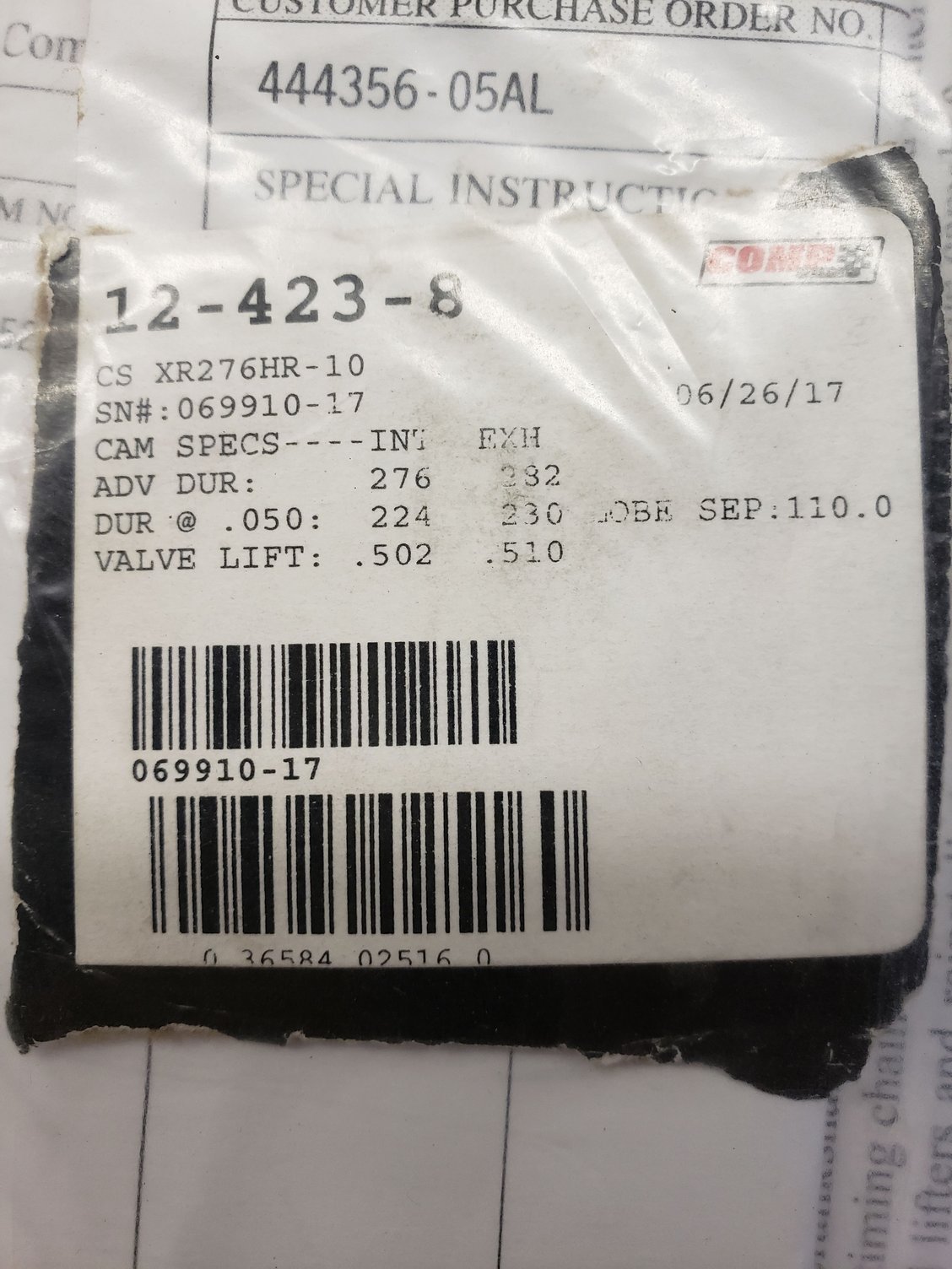

I'm using the original heads. I had the machine shop pocket port them. I'm install Speed Pro forged pistons. I used a Comp cam with comp magnum roller rockers. I'll look at my cam card to get you the specs. I am running 3:70 rear gears and installed a Tremec TKO600 5 speed.
To 327
