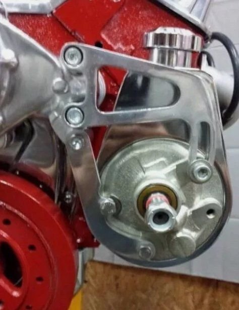

Previous owner of my new project put an aluminum power steering pump bracket on the non-original small block chevy 350 in the car. picture below is stock photo because I can't get good picture in car. Belt is loose and I can tighten but it will not stay tight. Anybody use this setup have some advice?

From the picture the pump is adjusted all the way down so you need a shorter belt a use a new lock washer with loctktit
