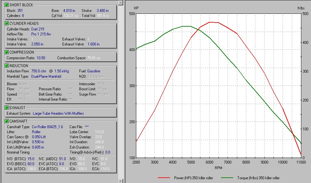

I've been playing with Desktop Dyno and came up with a 476 horsepower 350 roller:
The cam is a Crower roller, p/n 00425 using 1.6 ratio rockers. Is this on the edge of pump gas, or can I bring up the c/r to around 10.75 or 11.0 to one ?(Sunoco sells 94 octane here). - 11:1 would be around 480-490 hp, yikes!

With a manual tranny and go for 11/1 compression it would be a over 7500 rpm screamer.
With flat tops you will need the heads milled to @60 cc and the quench set to @.040 to get 11/1 compresion. I don't think that there is a dual plane made to fit those heads. actually are you using the flow files from Dart to get this HP?
IMO - I had a smaller S-Roller 355 ci single plane, 750 cfm carb, 10.74 compression, 1 3/4 headers. I thought that it was pretty fast untill I put a 3.750 stroker crank with lots of my old parts and a new block together.
Your ideas are headed the right direction. Why don't you run some simulations with milder cams like this one I own.

Crane makes an even milder street solid roller with 232/240 mid to high .500 lift. Off the top of my head it was something like
int 9 43
exh 57 3

This is very streetable with just a few more cubes and bigger Dart heads. All the books say that running higher ratio rocker arms ands a couple of degrees of duration. So DD2000 charts would feasably even be skewed higher. I do know that it is still really pulling hard at 7500 when my rev limiter starts causing misfiring.

Is that the specs on your current motor? That thing must sound killer. The flow #'s are from Dart's website. I was thinking of using custom pistons for the higher c/r using 64cc chamber heads. I have most of the pieces so building this motor wont break the bank. The CNC 227 heads are very cool, but mucho $. How accurate is the Vol Eff #'s in Dyno 2000? Some of the cams come up with over 100% Eff. Don't you need a blower to get those numbers? Also, how important are the IMEP,FMEP,& BMEP pressures?

Yes, this is my current motor. I use crutches like 4.11 rearend and 3500 stall to help it go on the streets.
I tried to find a site defining the IMEP,FMEP,& BMEP pressures. You need to get a motor book they all deal with how efficently a motor is using the gas pouring through the motor.
Race motors with high compression with properly tuned intake/cam/headers can exceed over 100% cylinder filling over a very narrow rpm range.
