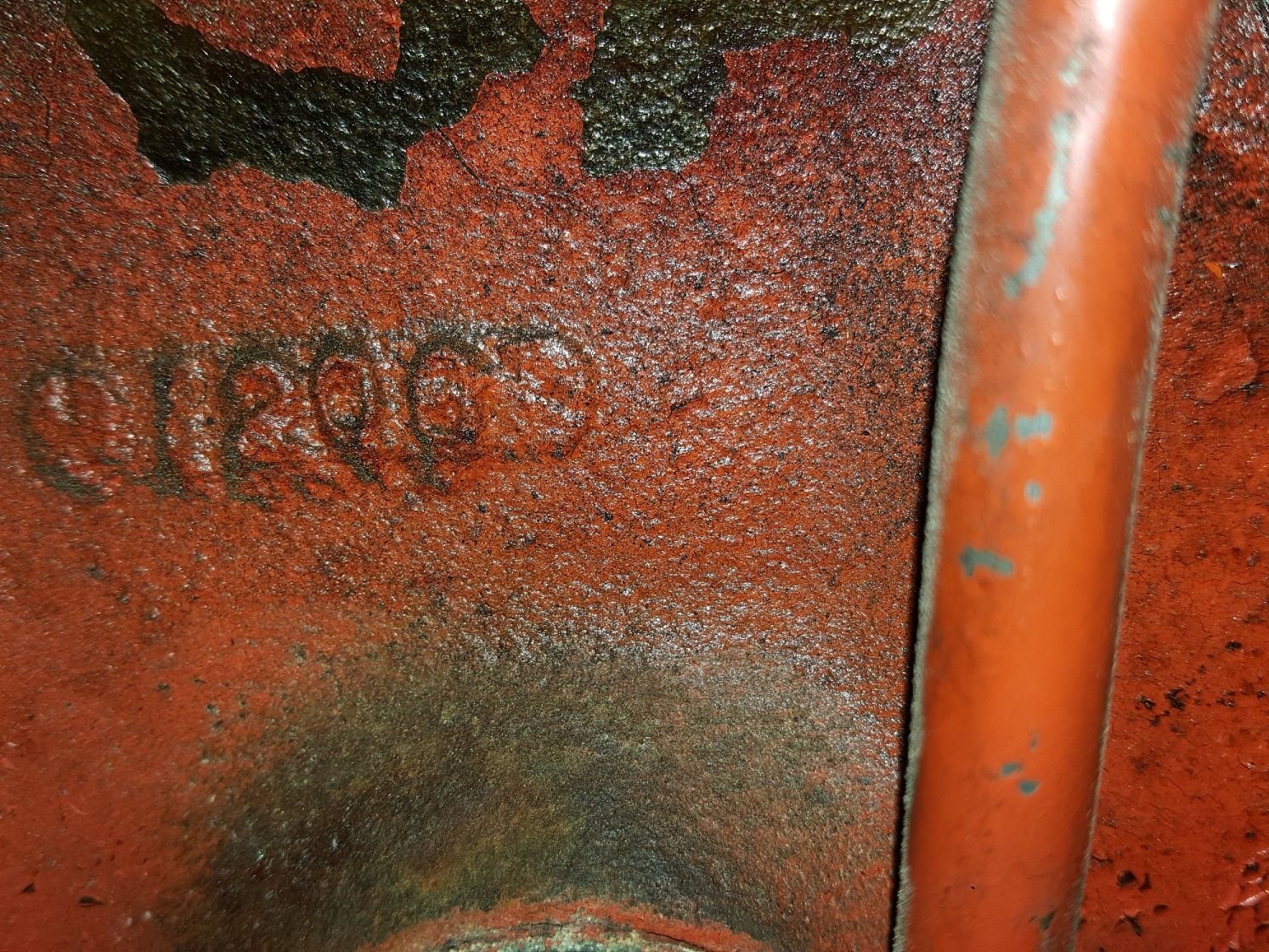

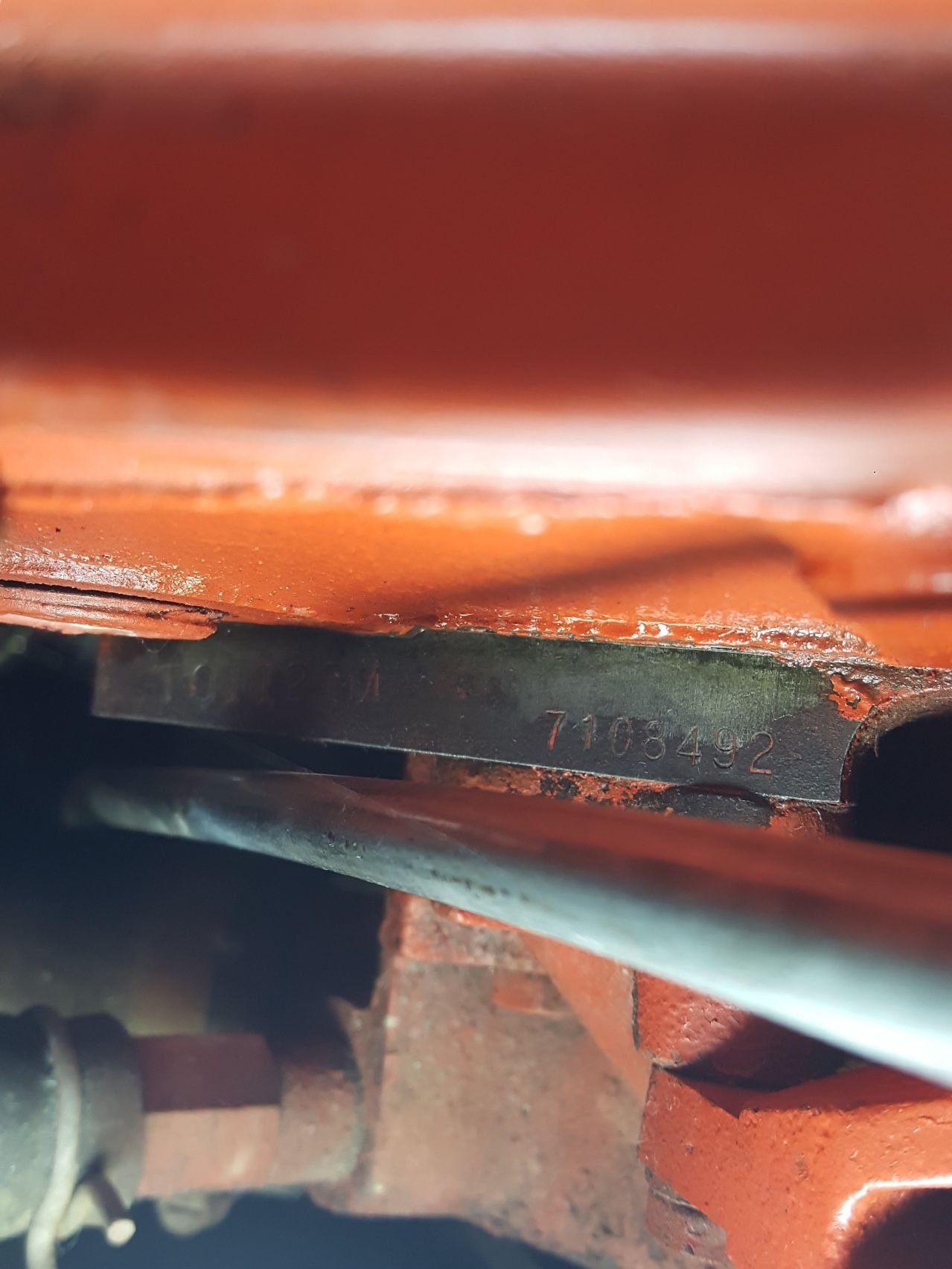

Hi I would like to know what the build date is on this 1967
I will attach some pix
C5
G51
Thank you

"L 10 6" is the casting date, December 10, 1966, but I'm having a hard time figuring out where that date is. Is it the block?
67 Corvette VIN 08492 was built approximately January 19, 1967. The upper left corner of the trim tag should have a letter and number indicating the body build date, but your photo only shows the right side of the tag, so I can't match that to the VIN.
It's hard to read the full stamp pad, but it appears the engine assembly date is 0112, January 12, 1967. I can't comment on the authenticity of the pad, except to say that it's hard to tell if there are broach marks present, and the quality of the photo makes it difficult to judge the engine stamp/suffix code.
The final casting date shown is September 20, 1966 "I 20 6".
"L 10 6" is the date on the cast iron intake pictured

cast iron intake, which means its a 390hp car. IM code on the pad means it's a 390hp, 4 speed SMOG car. Nice.
