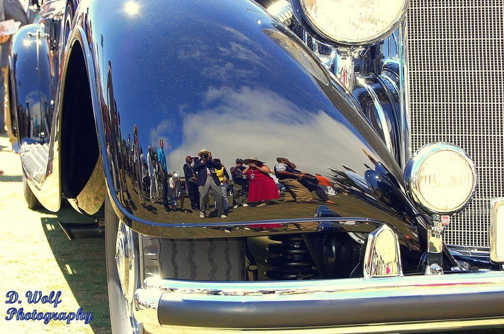

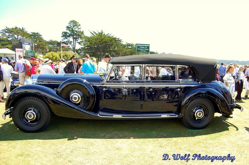

One trick I learned from my father-in-law was to add one more step. Use Blue Magic Metal Polish in between the polishing compound step and the waxing. I also use a Meguire's Resin Glaze before the polish.
Just so you know that my F-I-L isn't just a bondo slinger, here's a little of his work.

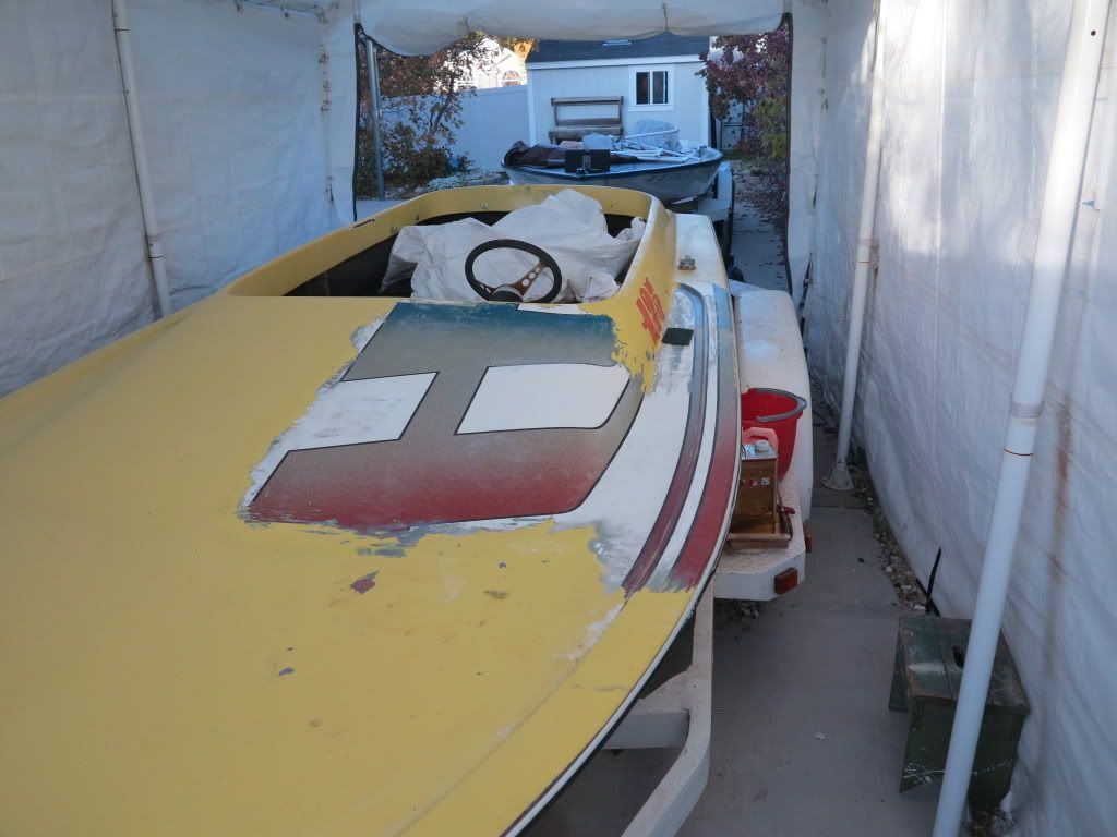

BTW, here's some stripping, color sanding, and polishing I did on my project boat.
Stripped, then started out with 400, 600, 800, 1000, & finally 1500. Don't skip a step, especially the 1500, you'll notice it! Turtle Wax Rubbing Compound, then Turtle Wax Polishing Compound. Blue Magic, and then a wax.
