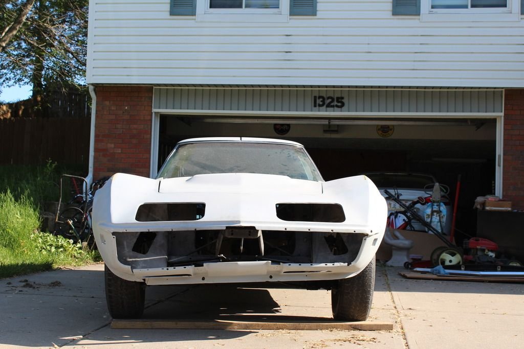

Here's the car. I've got a grip of pictures of frame and what not. But I'll just start with a general front side view. Be aware, I've got smaller rollers on the car because I was hoping to get paint going.
After taking these pictures and comparing to other cars, it seems pretty clear That part of the problem is just the front header area. I can see the headlight areas and what not are kicked up towards the center Definitely more so than intended.
This car like I said was hit a long time ago and had some repairs done on the passenger side. The front end had not had a radiator support and the nose was just held by a metal piece that was bent to sit against the cross member and the header bar. Do you suppose this could cause the peak if the fenders on each side essentially sag down and all the pressure centered on that one spot?
The lower valance was goobered as well. I thought this might contribute to the peak in the nose if the fenders were pulled too tight in the valance area creating the point. I bought a new valance and it will be replaced.
I put the bumper up at the lowest point of the horseshoe support.
If i put it to the highest point on the support and press down on the middle forcing it under the bumper I get this.
As you can see, it is right on the bumper and is not conducive to assembly especially if it was painted.
The car currently has a radiator support to which the inner fenders are bolted to. I just wanted to shoot these your way to give you an idea of what I'm seeing. I took a ton more pictures of the body/frame areas. If there's something you need to see to help diagnose let me know.
Tell me it's not all bad and can be fixed!

First off...YES...it can be repaired.
NOW...I get really NERVOUS when 'frame guys' say they got it fixed.
Was the frame pulled/'repaired' with the body on or off???
I would HOPE that your frame guy used the measurements for the frame and measured it out before giving it back to you. Do you know if he actually measured it out???? Not meaning to seem like I doubt his ability....but I have encountered numerous Corvettes that were pulled and NOT RIGHT....so hopefully you do not take offense in me beings bit skeptical.
Also...did he measure the lower ball joints and or the wheel base????
Did he tell you what he found was bad/bent and describe it to you....and if so...what did he say to you about the frame damage.
When you bolt up the front bumper to the 'horseshoe' bracket....can you get the bumper to contact the horseshoe bracket and pull tight against it ???
Depending what was wrong with the frame.....the end of the frame where the frame extensions bolt to the frame...can be 'up' or 'in' or even 'down'. SO...when you bolt the front crossmember to the frame extension brackets ( that are already bolted to the frame)...it can make trying to get the front bumper to fit correctly a lot of FUN.
Getting the front crossmember and extension set correctly at the correct angle is important in order for the front bumper to bolt to it correctly in the center. SO...if the horseshoe bracket is pulled as far forward as possible and the bumper will not be able to bolt to it correctly.....THIS is where I begin to wonder if the frame is correct or not. Three is only so much room on the four bolts for the frame extension brackets that will allow you to pull them forward also....so if everything is forward...and the index holes in the door sills are aligned and CORRECT...that is telling me that the frame is not pulled back out far enough.
PM me so I can get you my shop phone number. I do not have a problem in typing...but hopefully all the typing I just completed was not waste of my time because even though I see you have the bumper on...I do not know if it is tight against the 'horseshoe' bracket.
