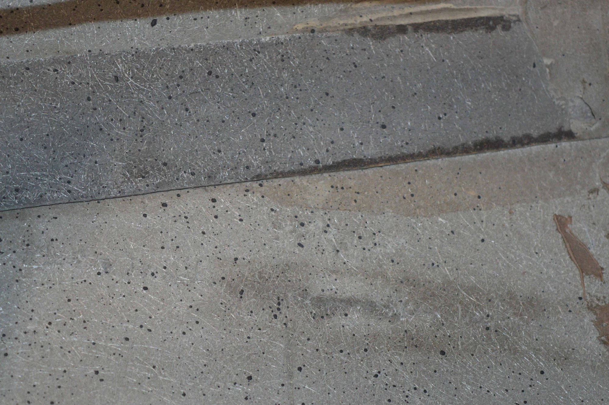

I live in So cal and have a friend with a house in Arizona so I can buy good paint and supplies. I don't have a problem with buying different spray guns. here is a picture of the back side of the panel. the black dots are undercoating overspray.

Are these exposed fibers on the exterior that you want to prime?????....or....
Are you planning on priming the area that you posted a photo of???
DUB
Old Sep 22, 2015 | 05:30 PM
71frameoff's Avatar
71frameoff
Joined: Feb 2014
Posts: 228
this is the back side of the rear quarter, I posted this to get help on what mater it is and what products I can use on it. the exterior patch looks about the same, I couldn't get a picture of it because it is on my lift and I have to move the frame out in the driveway to lower the body.

No need.
You can use a polyester primer. BUT...***DISCLAIMER**** I am not there to see how bad the fibers/panel are 'decomposed'...'so-to-speak'. Applying a primer on a surface that has lost integrity due to resins and fibers are gone and weaken due to enviornmental issues. Prepping the area would be wise to see how easily the panel sands.....and when good solid panel is reached. THEN...determining what is needed to replace the missing material would then have to be determined....due to how far down the sanding went to get to solid panel.

the spot is actually in good shape. so am I dealing with SMC here?
YES..'so-to-speak'. It is called 'genite'. Your car can actually be a mix of black polyester panels and the light gray SMC (genite)panels.
Google 'genite fiberglass panels' and read about it due to it is being discussed on another forum....so I do not have to type out what you may wan to know.
