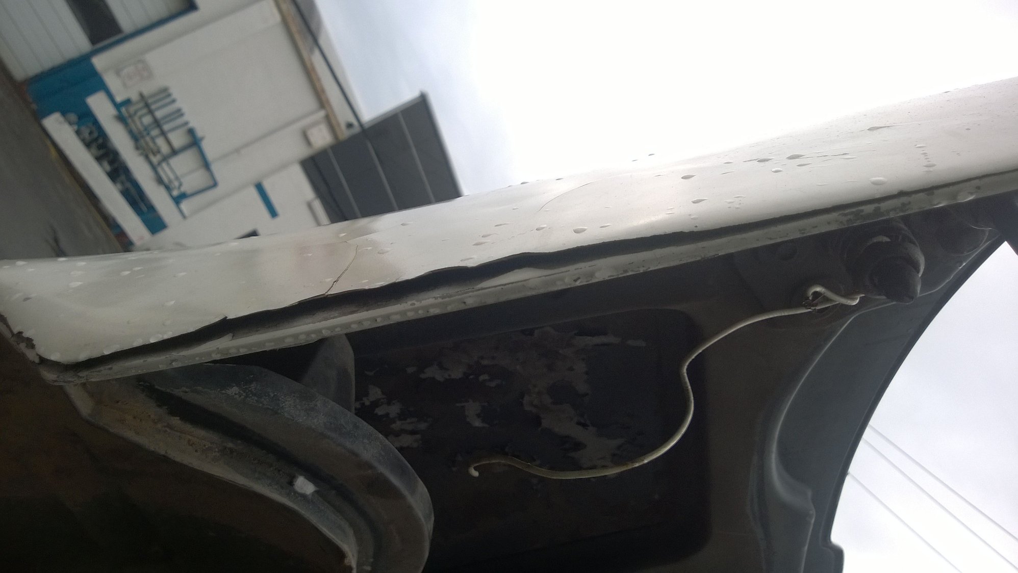

I took some pictures of the door and the delamination.
This is the door I installed on the car
This is as closed as the door will go. Even If I lift it and close the door it will not go flush
After more careful examination I think that this is just the paint coming off. I broke a piece off the car and it looks like paint. Does anyone know about how thick the paint is ?
Thank you all.

Honestly...the door is NOT closing all the way. The reason I KNOW this is because the striker bolt in the jamb does not adjust.....and the latch mechanism that bolts to the door does NOT adjust....so...knowing that the two point are 'what they are'...the door is not closing all the way. I would open up the door and VERIFY by manually latching the door mechanism with a screwdriver and making sure that the latch goes all the way....AND not stop on the first catch.
The photo of the hood delamination is partially helpful...because as I wrote...I need to see what you see. This mean pointing out or marking on the panel where the delamination stops. Also a side angle because from the view you took of the damage...it is hard to tell if you have damage at the wheel well lip area.
I am assuming that the car is white....and this is a factory hood.
AS for the thickness of the paint chip you have...once again ...take a photo of its thickness with a dime right beside it for reference...so i can see the thickness of your paint chip and the thickness of the dime. Factory paint jobs are not thick...but I do not know what your'thick' is versus my 'thick'.
