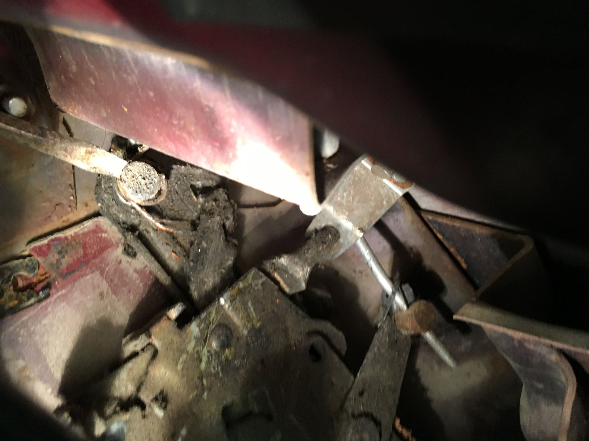

What is this at the tip of the screwdriver?
I'm taking the last sentence as release the ext handle before inserting Clevis into it's hole is that correct ? Sometimes I have poor understanding

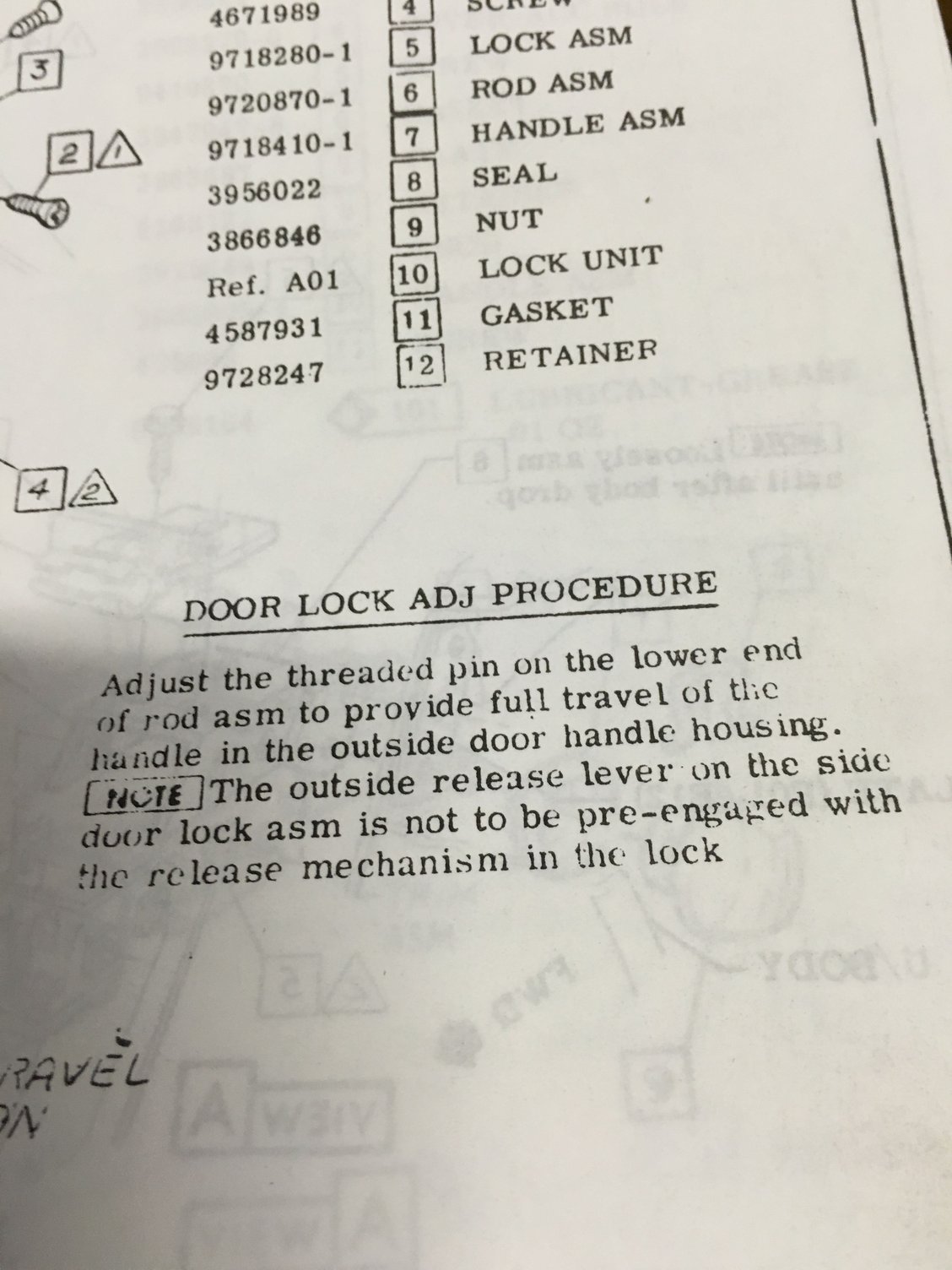

In your photo....you can see the broken special clip. And the threaded pin is in the LEVER that I and GM are referring to.
WHAT GM and I am 'saying'...is that...the lever that the threaded PIN is pushed into....CANNOT BE pre-engaged when you set the adjustment in the rod.
When you mess around with the latch mechanism with the door handle rod out of it. You can actually 'feel' than when you press DOWN on the lever....there is a point where you 'feel' resistance....and can ACTUALLY keep going down further. WELL...if you keep going DOWN further with the lever....you actually PRE-ENGAGE IT..and THUS...when you manually LOCK the latch mechanism...you can cause the latch mechanism to go into a LOCK DOWN issue....where you CAN NOT UNLOCK IT......BECAUSE YOU had the lever TOO FAR DOWN. And the ONLY way to fix that is that you have to remove the threaded pin and re-adjust. TEST this and you will KNOW you have it RIGHT....by simply feeling how the LOCK-UNLOCK lever feels. IF you feel a BIND in the LOCK-UNLOCK lever on the latch mechanism...you have your threaded pin TOO FAR DOWN.
