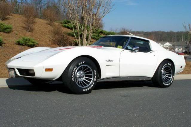

You are correct DUB, my wheels are aluminum. Copy cut of these, but on dark gray instead of black, and not that shiny/polished... more like satin surface
