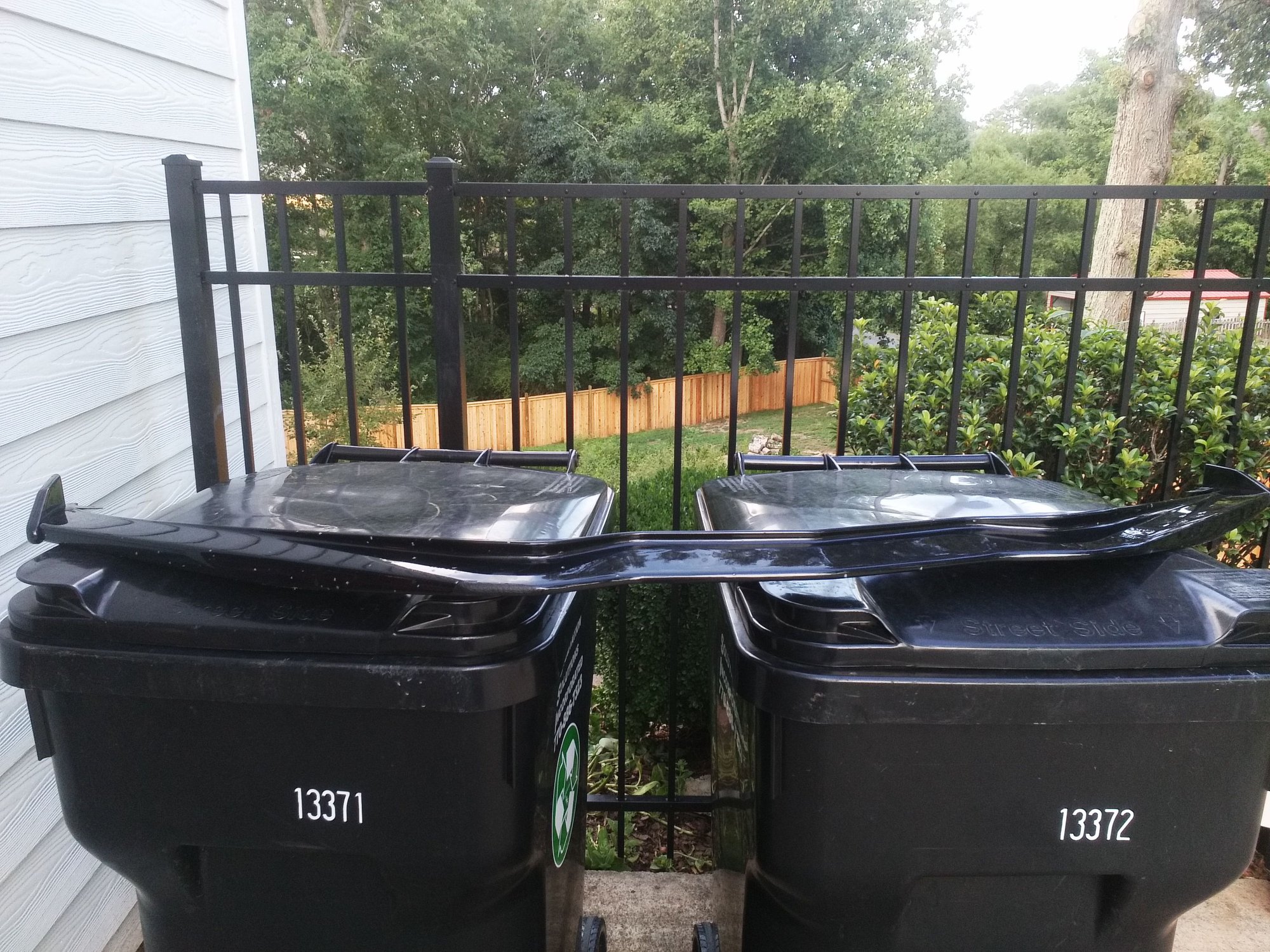

The aftermarket splitter on my car has several rock chips and a few scuff marks that a simple touch up won't fix. I've taken it to a couple reputable body shops and it's simply not cost effective to have them fix it.
Since I have nothing to lose by fixing it myself, what is the best approach to repainting a fiberglass splitter? Can I sand it down to the fiberglass or would it require using chemical strippers? If sanding is possible, what grit is recommended?

To put it in perspective, it was $600 painted new. Two reputable shops quoted between 450 and 600 to strip and paint. So I'm willing to give it a shot with aerosol as I had decent success with other parts in the past.
I was thinking of getting the primer, base and clear from automotivetouchup.com.

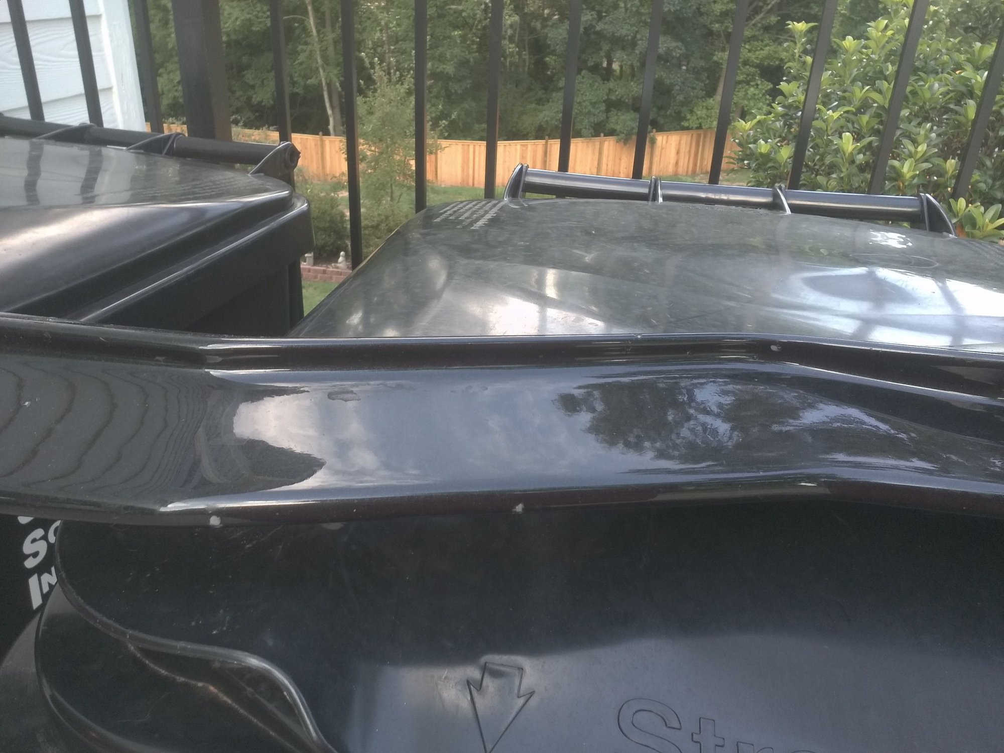

Thanks for the photos....they were MUCH needed.
From what I can see..those chips look pretty deep...meaning the paint is rather thick.
Am I correct???
IF they are deep...keep this in mind.
when 'feathering out' a chip and the paint and primer is thick...the feathering will have to be taken back away from the chip quite a ways so when you feel it...hopefully you can not feel where you feathered it back. If this is not done correctly...then a divot will be able to be seen.
NOW...when the feathering is taken back...then there is a chance that the layers of material that you feathered back are now very wide. Much like a topographical map.
And these exposed layers can come back and be seen in time due to how they will react differently ( in many cases) to the product that is applied to it in time.
On the edges it will not be so noticeable...but a chip in the middle of a large flat area...THAT is where this REALLY comes into play. And often times it is better to fill that chip with a catalyzed glazing putty instead of trying to feather out the paint. The same hold true to really small chips.
It is so hard to tell you what to actually do...sometimes I stop and figure in what it will take to sand and fill areas ...versus stripping it all the way down and priming it again.
