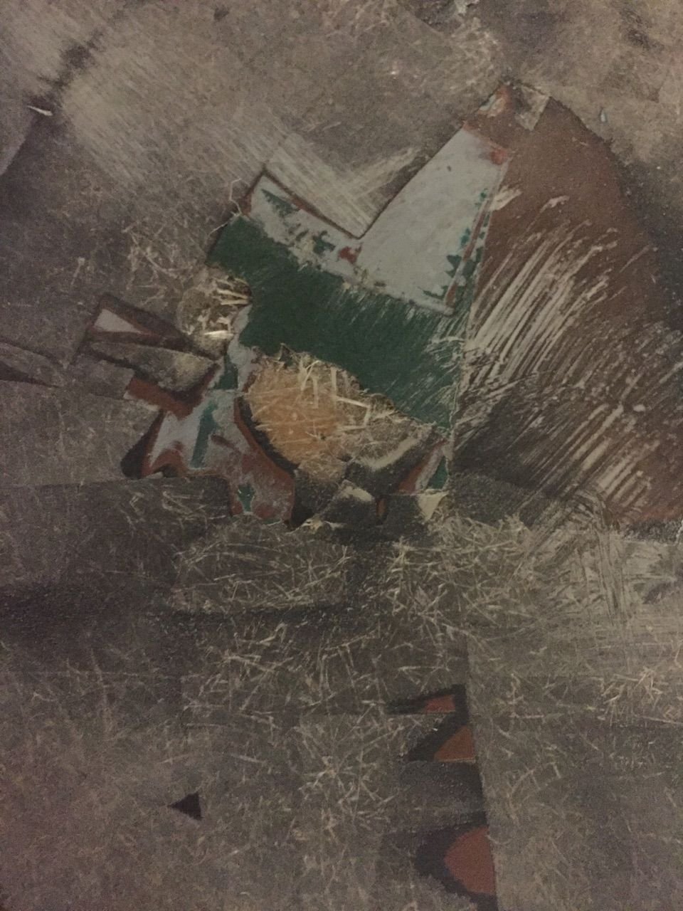

Alright, so some progress has been made...
I'm about 2/3 complete stripping off the last of the red oxide primer. While using the razor to remove the paint I had also been thinning out the layer of oxide primer and a result, the majority of the oxide primer has come off fairly easily with just automotive grade lacquer thinner and scotch-brite pads.
On a different note, the area that I have so far avoided has been the nose where the front support bar is riveted to the body. I previously started to go over the raised areas being pushed up by the rivets with the razor blade and the blade started to pull up fiberglass strands. you can see from the picture that the hole where the rivet is looks to be filled with resin and possibly have fiberglass mat laid over it? The car has been repainted twice but I think both time were more of scuff and shoot type paint jobs.
So my question is, how do you typically deal with this area?

The car is looking good. You are doing a good job in stripping it!
Thank you for the help
Honestly...this area of the top hood surround 'raised rivets' can be dealt in a few different ways.
SO...it will depend on how far you want to get into this.
Further investigation may be required....along with YOU deciding on which method to employ.
One way is to grind and beat down the raised bumps and fill them in and let it be that. And that is not stopping the PROBLEM that is causing the bumps.
The other way is removing the beam and correctly repairing the top surface and then addressing the problem in the beam you removed and re-install it.
And there are different methods of repairing the support beam.
SO...kinda need to know which way you want to do this. And you can call me if you want to. I know how I would do this if it were my car...but it is your car.

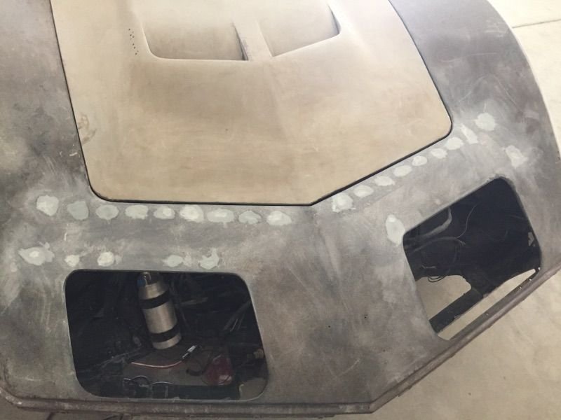

It's been a little while but I got all of the filler that was around/covering the exterior rivet locations and here is a clear picture of the nose. You can see that some of the rivet locations are low points that have been built up with filler and others that look to be filled with resin possibly? My question is, does this look like someone has previously drilled through the exterior fiberglass to remove the rivets? The rivet heads are still in place under the lip of header bar. Do you recommend that I fix these areas of the exterior fiberglass?
Also I am planning to remove the header bar and replace without the rivets using DUB's procedure.

As per this design of top hood surround. IF the aluminum rivets are removed. Then the fiberglass bonding strip that WAS riveted to the steel support....is no longer secured with the rivets.
Thus...if they did go in and cut off the rivet head...then the metal support beam is only being held to the top hood surround via the remaining aluminum rivets that did not remove....that are still holding the bonding strip to the metal support
Take a grinder and grind down and investigate. It is not like you are not going to have to deal with body work on this panel anyway.
It looks like they are still there.

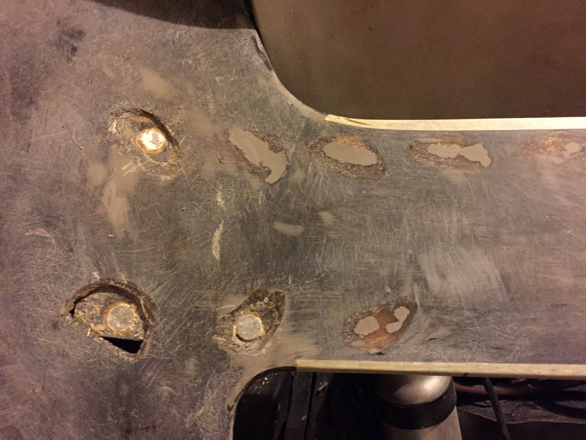

Ok so I started to heat up the the panel above the headlight support bar in order to soften up the adhesive to remove the bar. In doing so, the heat also softened the resin in the fiberglass patches that the previous owner used to fix the holes cut into the body over the rivets. I was fairly easily able to "poke out" some of the patches. My question is, there are patches all along the header bar above the rivets that are already flush with the body exterior, should I remove all of the old patches and fix all the holes again? Or am I just creating more work for myself? Because I plan to remove the header bar and bonding stripping I would think that I could create a better patch simply because I would have access to the back side of the panel.

As per our discussion...remove the fiberglass stuff that someone used to try to fix this and then heat teh panel up and try to get the beam to come off.
I am sure you will get this.
All repairs will be addressed when you get his beam out...so do not concern yourself with that a this point.

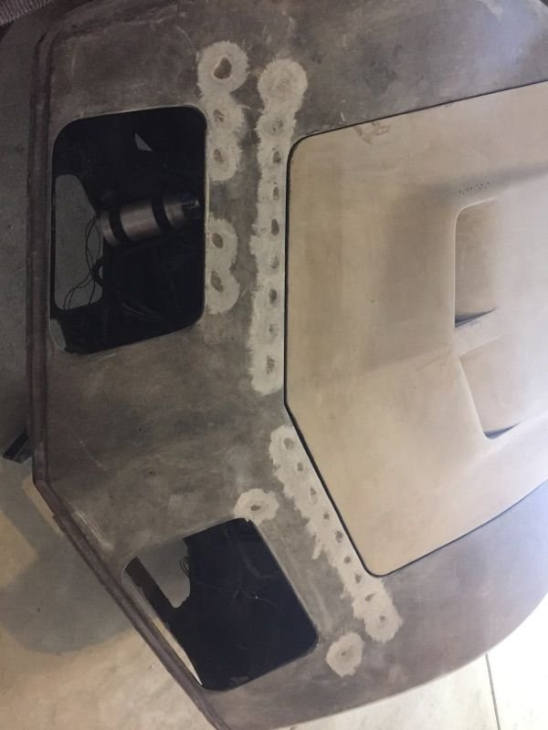

in preparation to bond in the header bar I filled in all the places where I had to dig into the bonding strip to remove the rivets. I used multiple thin layers of VPA to do this. This was my first time using VPA and it went pretty well. But I will note that you have to move FAST once you add in the hardener. I started by trying to get the mixer to look a very very light shade of blue to match the pictures here on the forum but by the time I had it mixed the VPA was already starting to gum up. After that I experimented using less and less hardener until I got a better working time. Also there is a crucial window of time where you can sand off the VPA before it gets rock hard. For me I could start sanding within 10 minutes or less and the VPA sanded nicely. Next up I will be test fitting and bonding in the header bar.
After sanding it flush
Put a bevel around the edges

YEP...Now when we talked and I talked to you about the VPA...I guess it is all making sense now. In some cases you can go from mixable VPA to it rocking up in under a minute.
GOOD JOB on the underside of the top hood surround binding strip..VERY NICELY DONE!

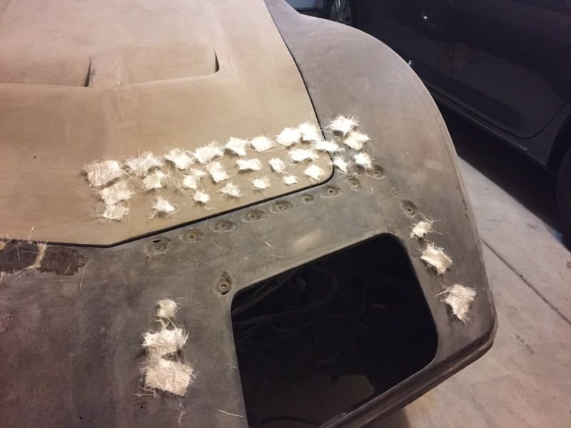

Well I had some time to put in a couple of good days of work on the car and I was able to get the header bar installed, the fiberglass work on the holes completed, and the VPA work done.
Here is the header bar once I got it clamped in place. I ended up using SEM 39747 Multi Purpose adhesive. Before I removed the bar I had taken measurement to ensure that the header bar was in the correct location, however, because I was able to reuse the old header bar and bonding strip, I inserted 1/4 bolts through the top of the bonding strip in the old rivet holes to act a dowel pins. This worked very well and allowed me to focus on getting the correct amount of crush on the adhesive. I removed the bolts after a coupe of hours and then left the clamps in place.
I removed any adhesive that had come through the rivet holes, put bevels on all of the holes, and cleaned in preparation for the fiberglass.
This was my first real experience with fiberglass work so before doing anything on the car I ran a couple of tests on some scrap I had laying around. The tests really helped to get the correct amount of hardener to get the drying time I wanted (the first test I used a couple drops less than recommended and the resin was rock hard after 2.5 hours.)
I also cut all of my mat and frayed the edges before starting.
After letting the fiberglass dry for 3 days I ground down the excess fiberglass and put a bevel on the new fiberglass up to the exterior panel in preparation for the VPA.
I then filled in each of the holes with VPA and feathered the edges into the exterior panels. The were still some low spots in the VPA but I figured I would pick those up when I put the skim coat of VPA on.
And here is the finished product. I put the skim coat of VPA on the panel and started the block sanding process. I'm pretty happy with how flat and smooth the panel came out but as you can see from the picture, there were some breakthrough spots where I starting getting down to the original panel. These areas feel flat and I can't feel any low spots, however, the point of the skim coat was to help any "edges" from showing up through the paint so my question is, should I go back and try to add VPA to these areas? Its possible that I add the VPA and then just sand it right back down to the parent glass to get it flat again.

HECK YES....you follow instruction VERY WELL!!!!!!!!!!!!!!
My only question/concern is that in this photo. I can see that you did grind down the resin and mat. But I can also see that deep in the low areas they have not yet been sanded or ground on. Hopefully you did make sure that these dark low areas were ground on so the VPA would stick.
