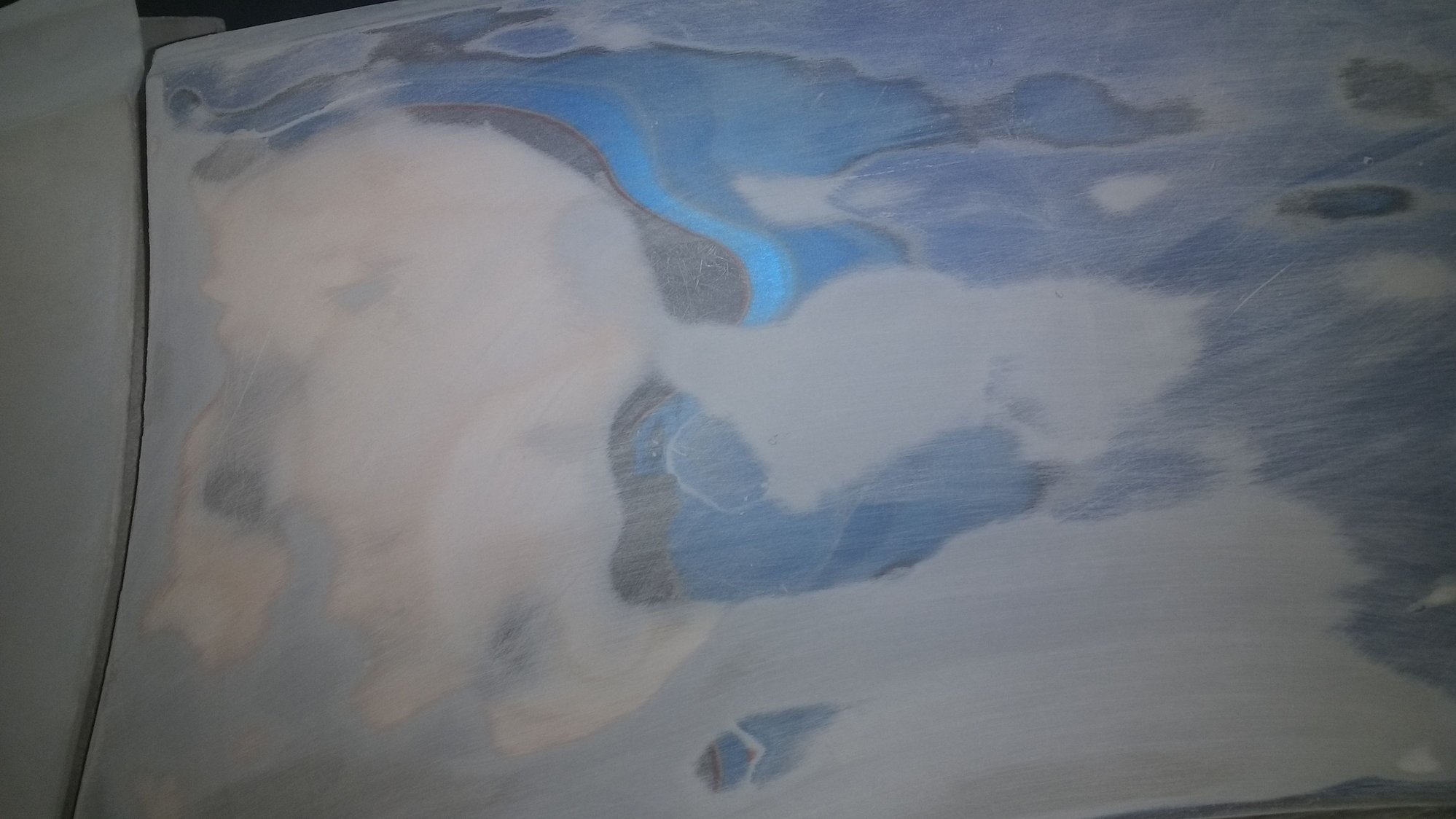

I started sanding with 220, a small primed area to see what's there.
So what am I looking at? Two layers of blue paint? You can definitely tell somebody has been here before with the varying consistency of sanding. This all has to go to ensure a solid foundation. Am I right?

heat gun and razor blade time. all of that needs to come off.

I kind of figured that's how I was going to have to approach it. But my thoughts are probably sand off this crappy primer then heat gun razorblade the following layers. sounds like some work.

I assume what I'm seeing here is bare fiberglass some newer fiberglass resin for a repair and possibly VPA to fill the rest of it?
Is there a way to tell the difference between an appropriate VPA and just regular body feeling that some goob shouldn't have used?

I can tell you that that light pink looking 'bondo' is NOT Vette Panel Adhesive (VPA)
YES..from what I can see it does look like someone applied more mat and resin for some type of repair.
DO NOT be surprised if in the future I HIGHLY recommend that you dig into it rather well to verify that who ever did it...applied the resin correctly. Leaving body work that someone else did is taking a big chance that it actually is correct....regardless if it has been on the car for 20 years (for example).
IF you are planning on using the Aircraft Stripper from Klean-Strip..and you have never used it before ON FIBERGLASS...and you have searched the Corvette Forum and have not found where it has been written out how to correctly use it...PM me and I will be glad to give you a verbal tutorial over the phone.

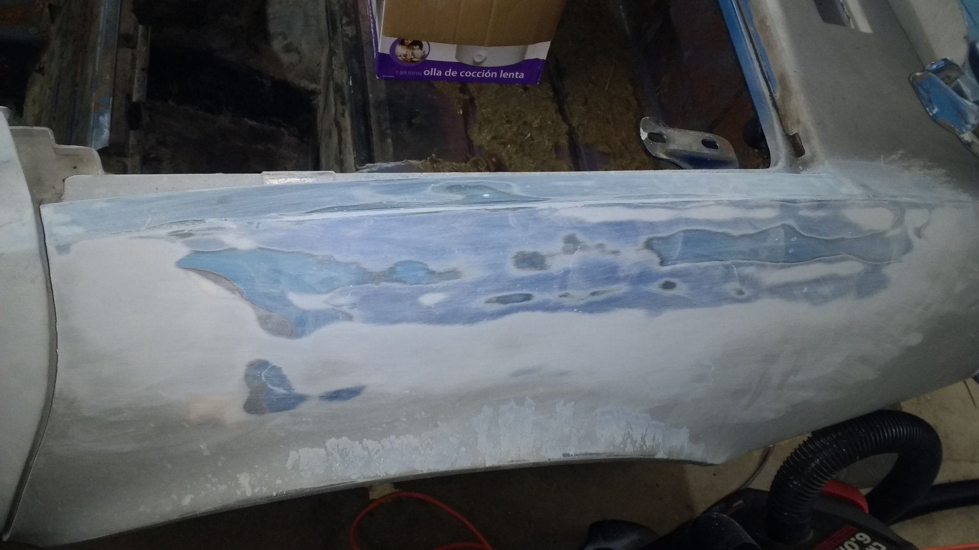

I found a spot on the passenger side quarter that would let me use a razorblade. I didn't have a heat gun but the primer was loose.
I worked on it towards the back where I knew a repair was.
My novice assessment? From the top layer down: I've got crappy primer.
Then the black is some sort of sealer.
Then some white filler (probably Bondo)
Then original blue paint (if it's there)
Then red oxide primer (if it's there)
Then fiber glass.
I'll get a heat gun to speed the process and make sure I don't gouge the fiberglass. But there's definitely some work to be done and done right this time.
Razorblade method is theraputic and kinda still makes me feel like I'm making progress. Even if it is a sliver at a time.

the paint will likely not release over filler. just go around those spots. every panel will go faster as you get the hang of it .

I don't necessarily like everything that I'm finding under here. But that I'm sure as the cost of doing business. I'm finding on the back tail piece a lot of Bondo or some sort of filler to build up the area. I guess the thing to always consider is what's the cost to repair panel verse the cost to replace a panel.
Rear lip. Pass side

YES...The cost of buying new panel...getting it shipped in...then installing it...VERSUS...repairing what is wrong with that specific panel is an ongoing battle I encounter often encounter
THEN...what also has to be taken into consideration is the overall integrity of the panel when it does get repaired. Because I HAVE TO warranty my work. So.. I have to worry about potential cracks and problems that I would have to deal with in the future.
Depending on where the damage is located ...often times will dictate to me if I need to replace a panel or repair it.
