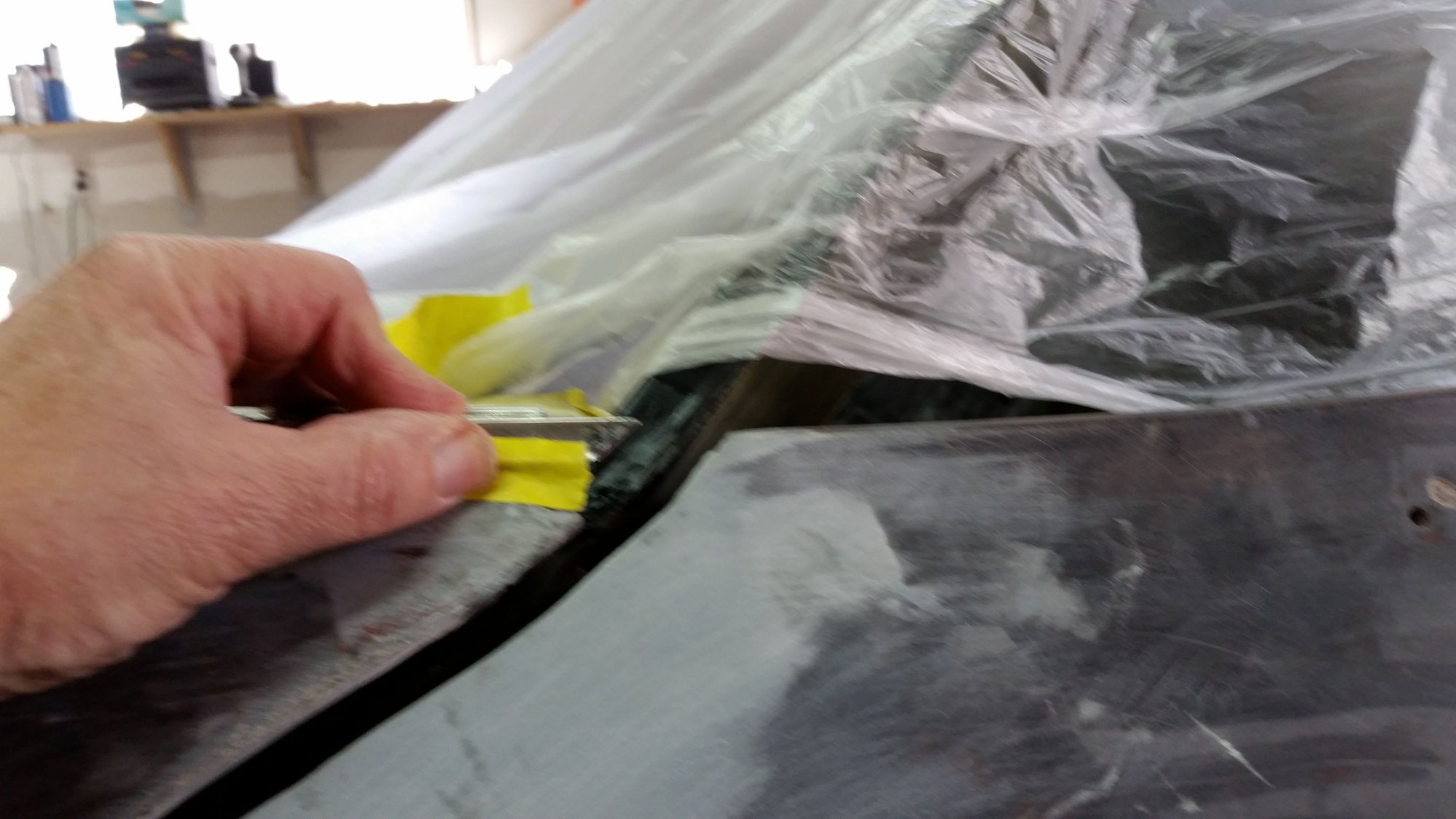

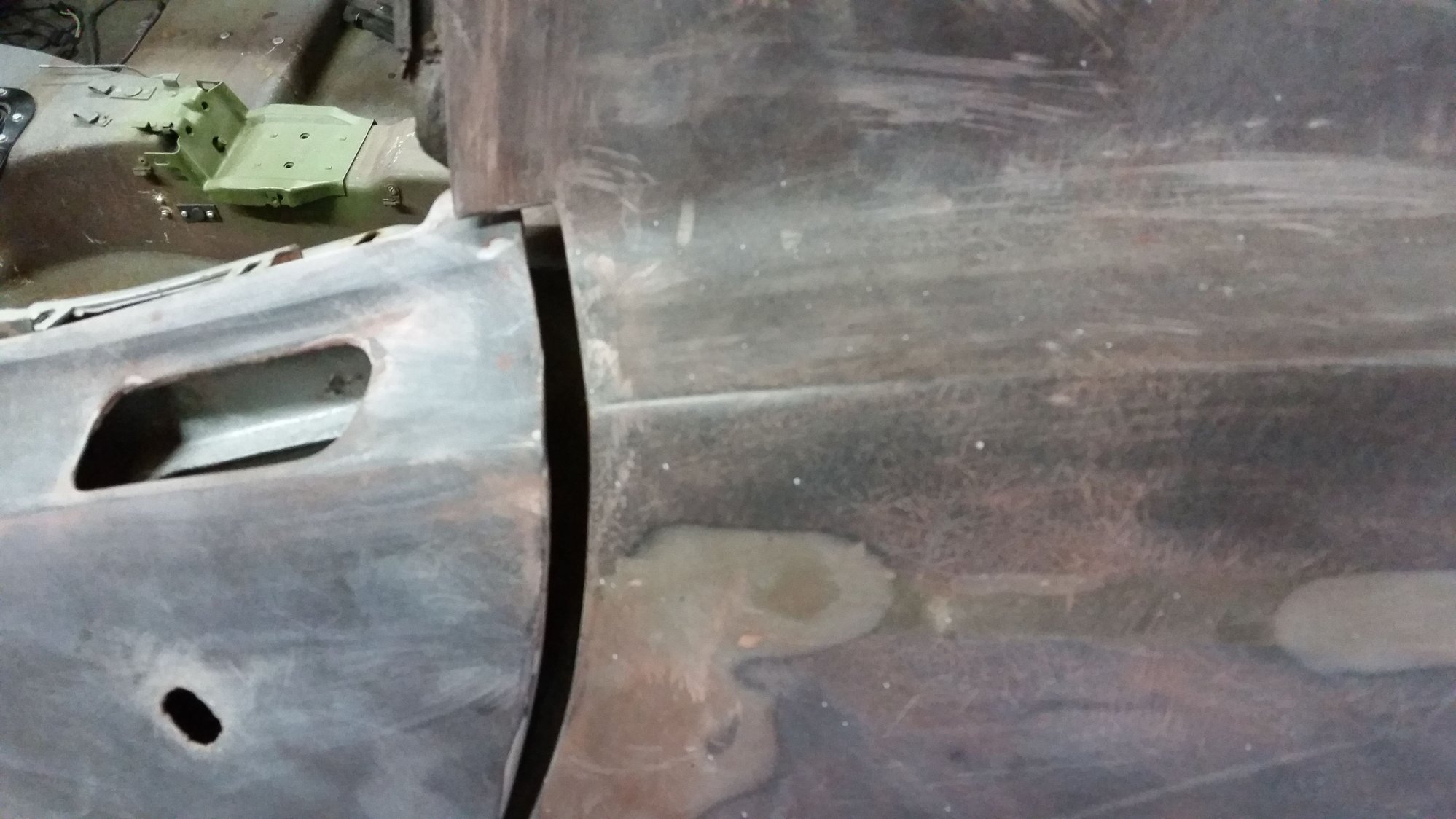

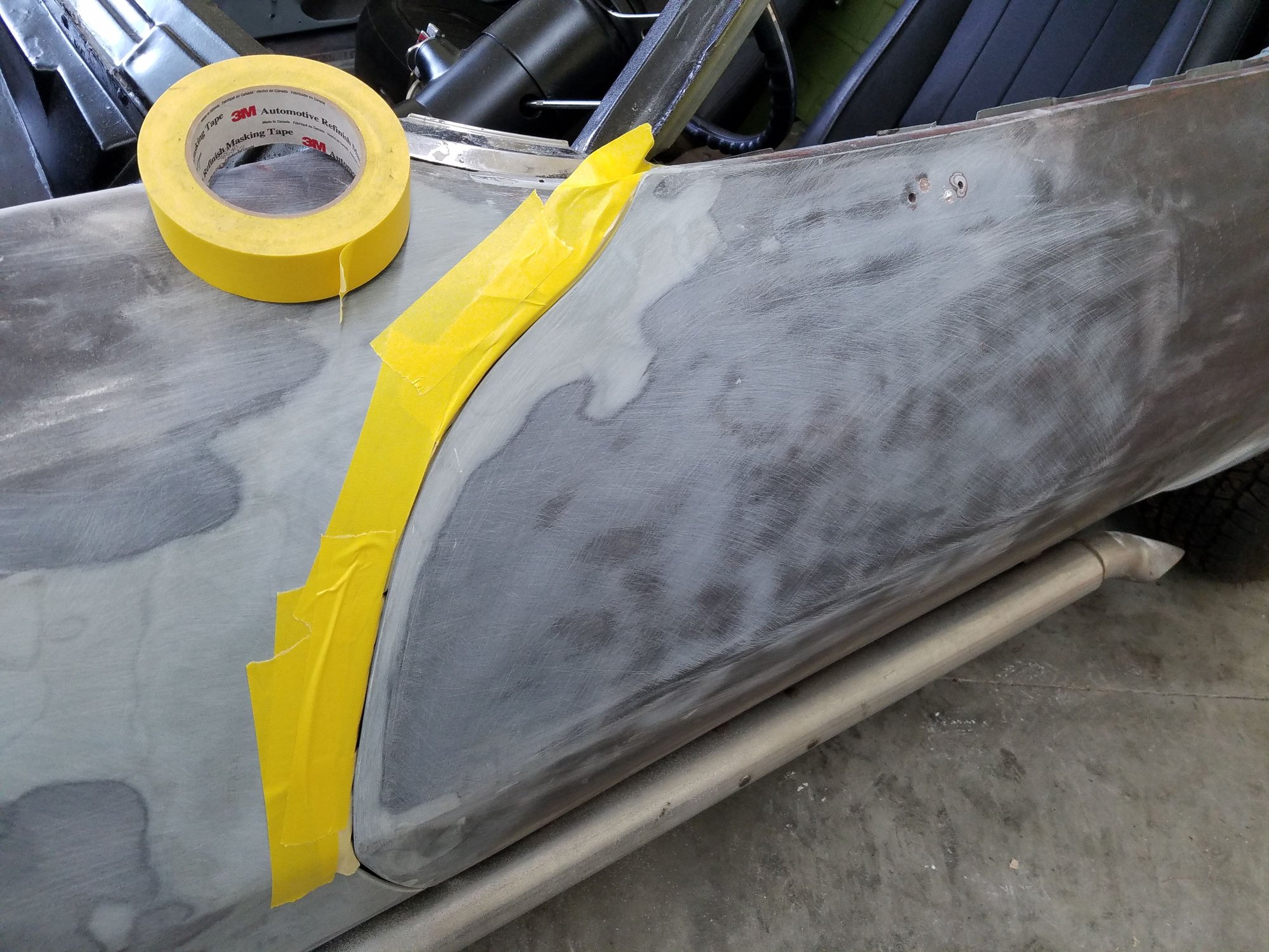

Here are a few pictures of the back taping and some VPA which as Dub mentioned had to go on both the front clip and door to align things properly. All tutored with Dub since I am a novice!
RVZIO
You get the idea.................................... ..
